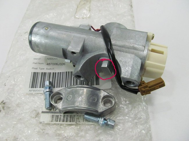

This is a car I just bought. It has an aftermarket "remote start" system installed. The remote start will start the engine, but the key will not turn in the ignition cylinder. They key (not an original factory "transponder/chip key") has been working fine, but suddenly the key would go in, but would not turn. The aftermarket remote was installed with what is called a "key wrap" - the key or the chip from the original factory key was placed somewhere on the vehicle in order for the remote to function.
I don't know if I somehow triggered the Nissan Anti-Theft System (could this lock the steering wheel?) or the Infinity Immobilizer system? Or what?
I have tried turning the steering wheel while turning the key (like on "normal" cars where the steering wheel locks), but no luck.
I had to have the car towed home, and here it sits.
Any help greatly appreciated.

My first thought would be a failed ignition cylinder as the key doesn't turn at all. The NATS system only prevents the engine from running if the attempt is made to start the engine with the wrong key. It won't prevent the lock from turning. I will say I do not like that type of remote start because it eliminates all of the OEM security because of the chip inside the car (likely right near the factory ignition switch so the transponder will function) which makes any key that turns the switch into a valid key, even if it's a screwdriver that forces it to turn.
The entire unit is replaced with a new one, the lock cylinder isn't a replaceable part.
Nissan/Infinity # 487006J326.
Replacement isn't that hard. You remove the top and bottom plastic covers on the steering column. Then use a sharp punch or chisel to break the tamper screws loose. Disconnect the electrical connectors and remove the old switch. Install the new switch, tighten the screws until the heads break off. Reconnect the electrical parts. Now you may need to get new non-transponder keys made to keep the remote start as the new switch will also have new transponder keys that may interfere with it.

None of those resets will help with the key issue. If you put the key in and it doesn't turn the interior of the lock is the only place that can cause that. Also being that you have the remote start with the transponder key chip that works, none of them will do anything as that makes the system think that the correct key is already in the car and that overrides everything else. As for the part, you can get them cheaper. Oh, the Infinity system is just NATS by another name. Works the same way. When a key is inserted into the ignition, the PCM and security module send out a pulse that wakes up and powers that chip. If the chip is not recognized by either one the NATS system shuts of power to the fuel and ignition systems. However an easy way to tell it isn't causing your problem is that the remote start works and the engine runs. If it was anything to do with NATS it wouldn't run.
The steering lock is nothing more than a chunk of metal that rises up into a notch on the steering shaft right in the key housing. It isn't controlled by anything other than the key turning in the cylinder to lower it. On the attached image, the circled part is the steering lock.

This is an update on my original "locked steering wheel, key will not turn, but I can remove and insert the key" problem:
We ended up not replacing the entire ignition switch assembly, and only replacing the electrical switch ($40.00 to $50.00). The primary reason for not replacing the entire assembly was cost. The best price I could find for the actual 2000 Infinity QX4 switch was $340.00.
After seeing the ignition assembly and how it works, I'm convinced Steve W. is right and other Nissan/non-Infinity (Infinity = $$$) switches would work (at half the price), but replacing the switch would still involve, as Steve W. explained, a trip to the dealer to have new keys and/or reprogramming.
We removed the ignition cylinder following Steve W.'s directions (aided by a fantastic YouTube video called "How to fix a broken ignition lock/switch-steering column type).This is a very detailed well-done 24 minute video with many great tips on this type of ignition lock system. The same mechanic has another 11 minute video titled "How to Remove Ignition Key Lock Tumbler/Cylinder & Electrical Switch from Steering Column" which details the removal of this type of ignition cylinder.
After removing the entire Ignition Cylinder, I found that the key now turned freely in the lock cylinder and the spring activated "steering wheel lock" "button" (or hunk of metal) as Steve W. called it (See the image Steve posted above) worked fine.
I oiled the spring "button" lightly with machine oil and added white lithium grease. I added powdered graphite to the key cylinder.
The new electrical switch seemed more solid than the old one. the key worked better than with the old electrical switch. Failing electrical switches are a known caused of many problems including slow/hard/no start issues. I consider replacing the electrical switch a "no brainer" if you remove your entire ignition assembly - just unplug the old switch and plug in the new one.
We went to the hardware store and sized the bolts to replace the "knock off head" bolts that are normally used to install the ignition lock cylinder. We selected replacement bolts with "allan" heads so we could crank the bolts tight.
After removing the ignition assembly and replacing it, I'm convinced that the steering wheelkey lock problem that started this repair thread was caused by a common combination of circumstances. My wife parked the vehicle with one wheel slightly up on a rounded curb, and then we tried forcing the steering wheel while turning the key. This resulted in the "steering wheel lock button" getting jammed up in the steering wheel slot.
The only way to release this "jam" was remove the ignition lock cylinder.
NOTE: We did notice that when we started to removed the ignition lock cylinder, that there was a small amount of "play" and the cylinder wasn't locked on as tight as it could be.
This might possible have caused the original problem by allowing the steering wheel lock button to seize up inside the steering column.

Steve: Yes, the old electrical switch did operate in all positions, even the "start" position and spring-returned to the "on" position. I tried it in the ignition cylinder and by itself with a screwdriver. I really don't think the old switch contributed to the "locked steering wheel" issue, but it did appear to be failing, as it didn't seem to "click" into on/off/accessories like the new one did. As mentioned above (and as you know), there are several possible electrical issues that can be caused by a faulty/failing electrical switch.
I'm convinced the original locked steering wheel issue was one or a combination of:
1. Tire up slightly on curb when parked.
2. Yanking too hard on the steering wheel to release/turn the key.
3. Slightly loose ignition lock cylinder - there was a very slight movement of the cylinder before we removed it.
Some combination of these three issues, or to me, most likely, the slight movement of the ignition cylinder (when under pressure) allowed the metal button/steering wheel lock mechanism to jam up inside the steering wheel notch. Once it was tightly jammed, there was no way the key could turn.
