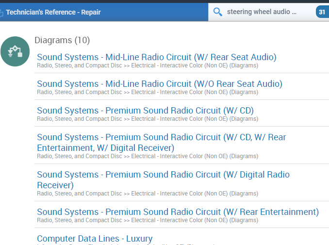

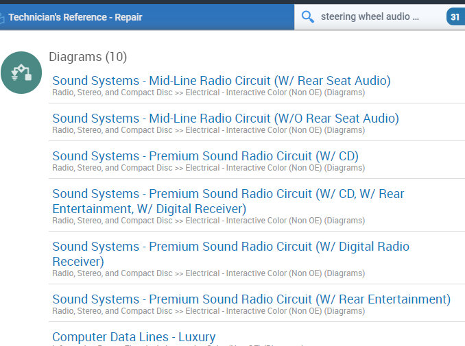

I would be happy to help. I just went into the audio wiring schematics to see what you are dealing with and found multiple options for the OEM systems.
I need you to take a look at the pics below and let me know which system you have. Also, keep in mind this could be an issue related to the body control module or the steering wheel control module.

Honestly, I’m not sure from that pic all I can tell you is it's the Bose stereo with CD built in not the one with CD lower in the center console like some, smaller subwoofer under the center console not the subwoofer in the hatch area side wall, and there is some buttons on the back of the center console for the rear passengers but not sure what it even does in all these years I’ve never messed with it.

I’m guessing it could either be the 1st on that list or 3rd, idk.
Oct 13, 2022 at 1:27 PM
  • 110,244 POSTS

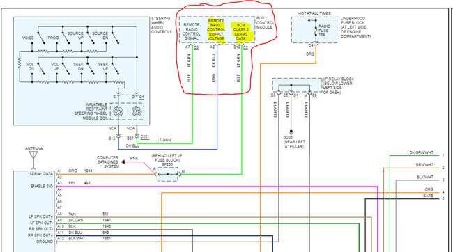

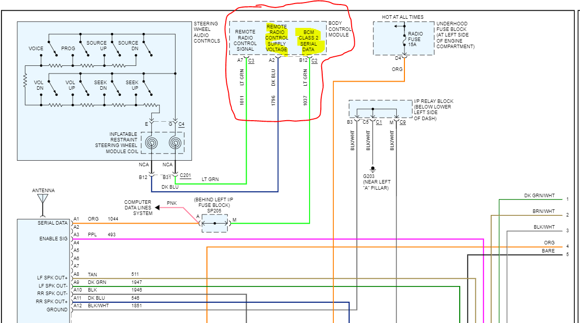

As far as your description, it sounds like you have number 3. As far as the power source for the controls is concerned, it is provided by the body control module.
If you look at the attached pic, the power supply from the BCM is provided via a dark blue wire. Are you able to check it for power?

Yeah, I think so, I am looking for pin a2 in the gray harness from what I can see online. I’ll get the bottom of the dash torn apart and check it sometime this weekend. Thank you.
