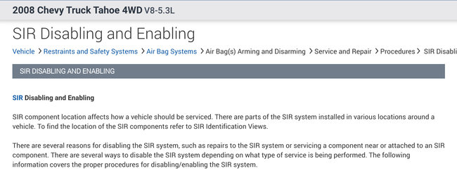

Steering wheel buttons not working
2008 CHEVROLET TAHOE
550,000 MILES • 5.3L • V8 • 4WD • AUTOMATIC
FNNLT

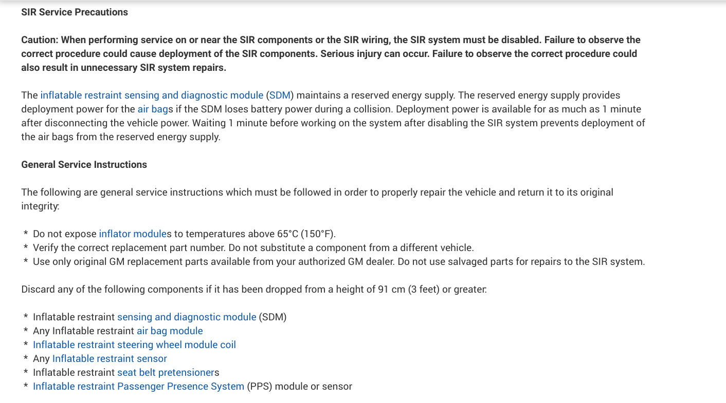

Suspecting circuit shortage. Checked fuses under hood and under dash both work fine.
Mar 4, 2020 at 1:10 AM
SCGRANTURISMO
  • 4,897 POSTS

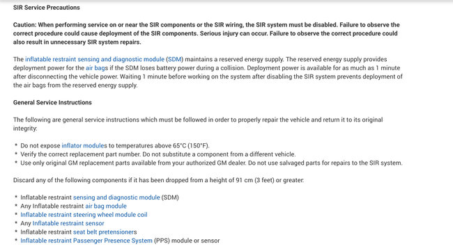

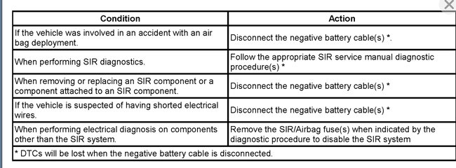

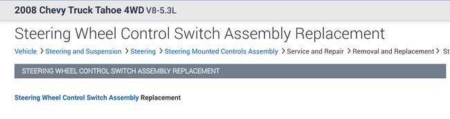

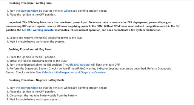

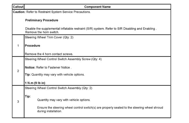

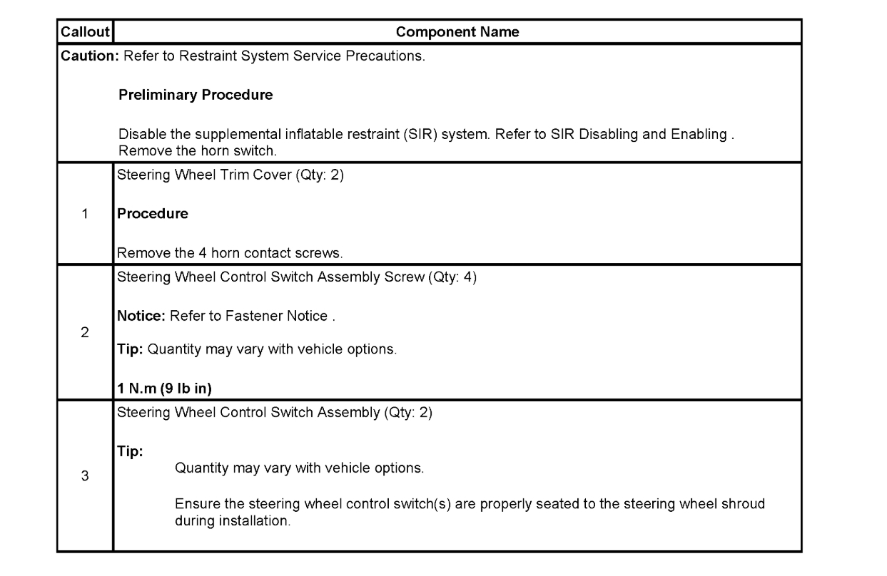

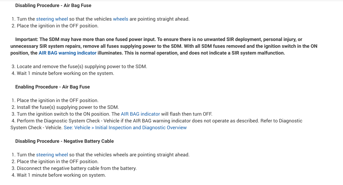

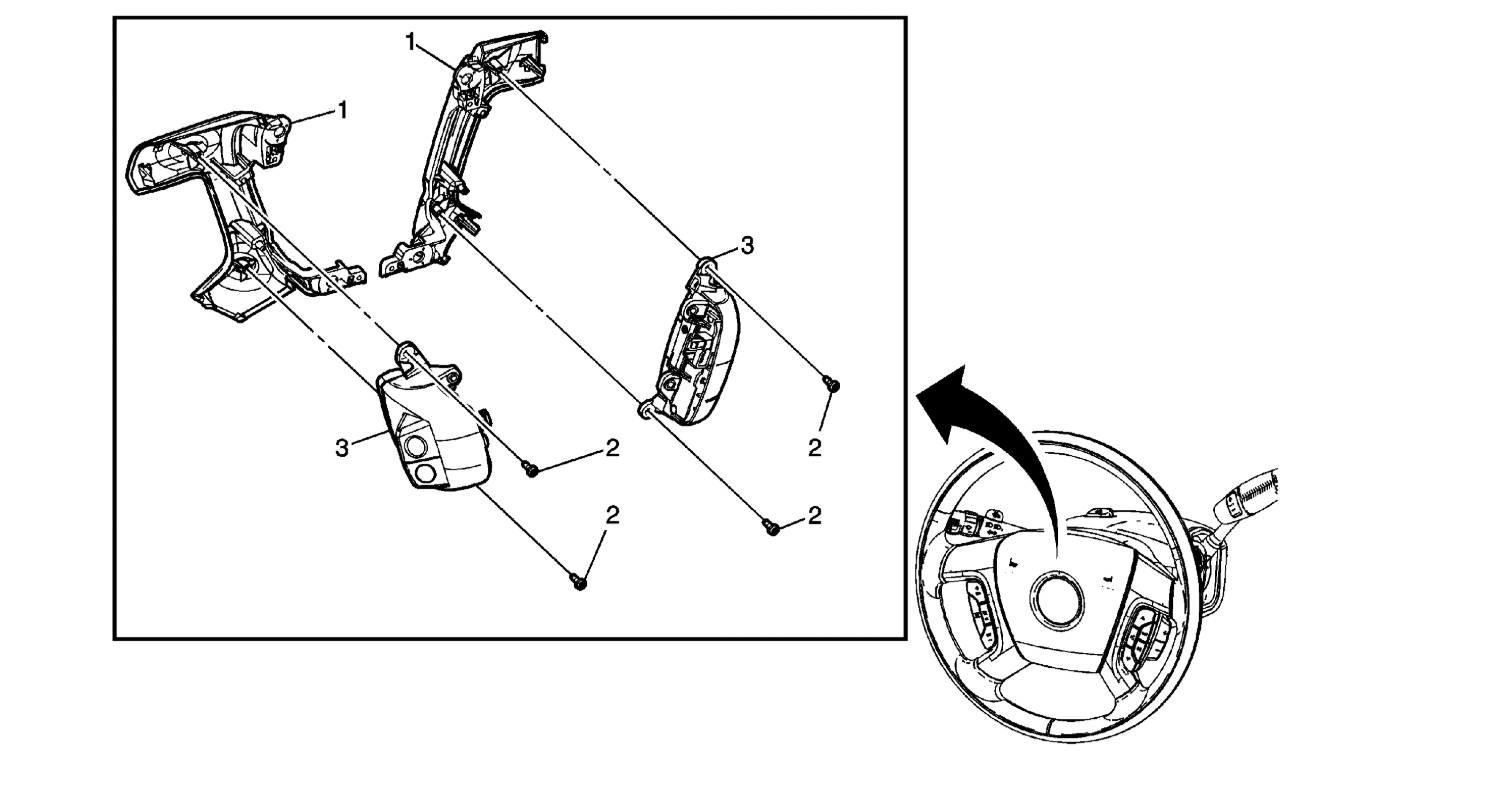

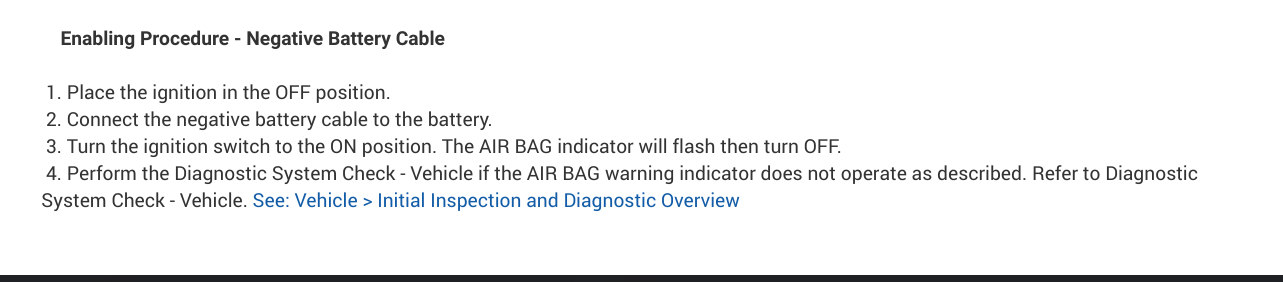

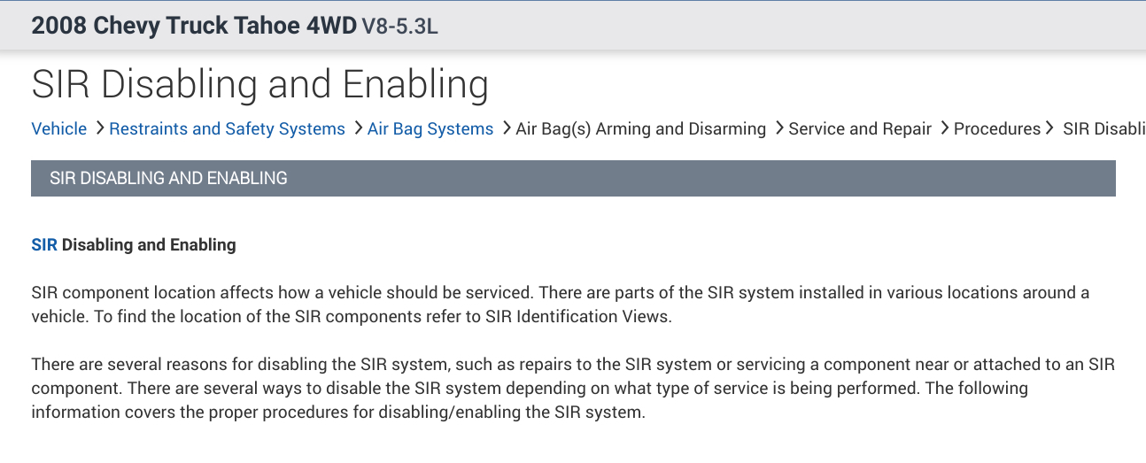

This sounds like the Steering Wheel Control Switch Assembly might be worn out or have an internal short in it and should be replaced as a whole unit. In the diagrams down below I have included the instructions for the removal and installation of the Steering Wheel Control Switch Assembly for your vehicle. Please pay special attention to the SIR disabling portion of the guide. Please get back to us with how everything turns out.
Thanks,
Alex
2CarPros
