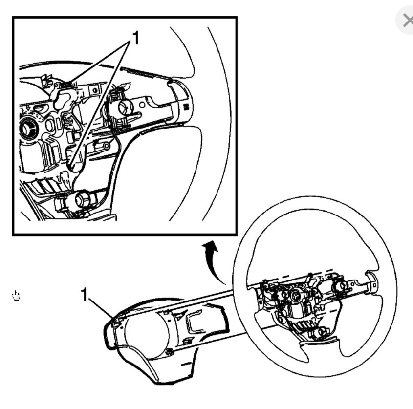

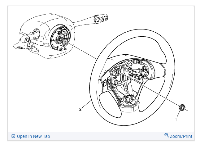

Is there a exploded view for the car listed above's steering wheel I can find?? Trying to trace a soft scraping noise from wheel.
Sep 26, 2020 at 2:41 PM
Unfortunately there is not a complete exploded diagram but there are a couple different views that I attached. I would suggest removing the shroud and see if that was the source as it is most likely where it comes from.
If that was not it then you need to lay under the dash and have someone move the steering wheel back and forth to make the noise so that you can try and pinpoint the area and then start disassembling.
Let me know what questions you have and what you find. Thanks
