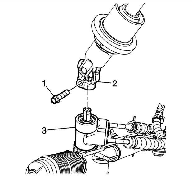

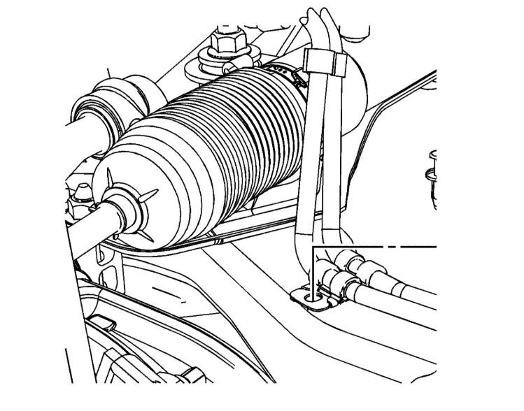

A while ago, I replaced the steering hoses, the tie rods, control arms and rack and pinion with brand new parts. I did my own alignment and we drove the car to Disney World and back. When we got home, I noticed the driver side steering boot had come loose (no clamp) and was filled with steering fluid. I examined the steering fluid reservoir. I was shocked: It was entirely empty. I cleaned the boot and put a zip tie on it (but the boot now looks weird and overly stretched). Four months later and zero leaks! So, the good part is I can't find leaks. The bad part: What happened? How did the steering fluid get into the boot and then nothing- no more leaks? Is there a relief valve that could have opened and then permanently closed? Did the loose boot cause the leakage? How?

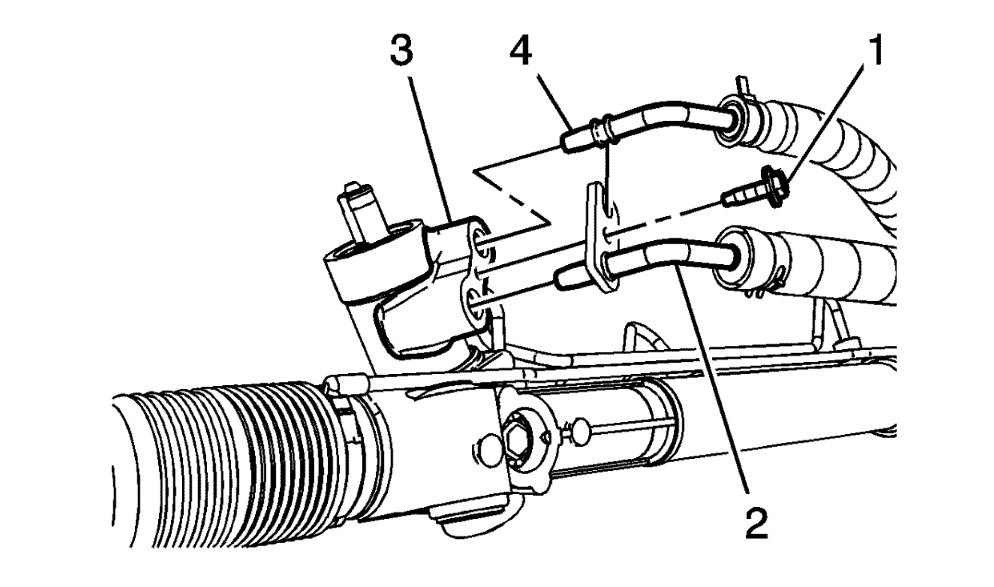

That boot is a dust boot, not a fluid boot.
The fluid indicates the bulk head seal is leaking. That will require replacement of the steering rack. There is no replacing the seal or additive that will stop the leak.

As I stated in my reply, it is the bulk head seal on the end of the steering rack which is under the boot.
Hard to say why it is not leaking anymore but I bet if you release the boot, you will find fluid in there. It may have just slowed down.
