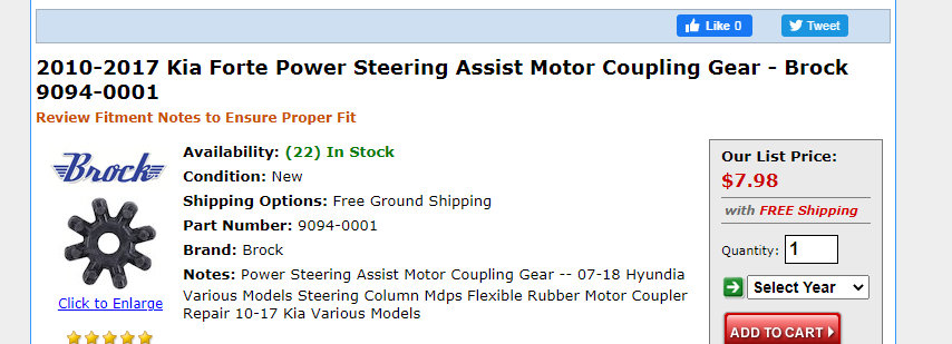

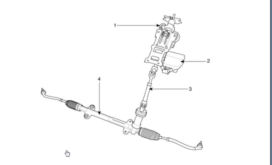

I am from South Africa, no where can I get the gear for electric motor on steering column. Can someone one please assist?
Sep 3, 2019 at 9:32 PM
I assume you are talking about the electric power steering motor. The part that helps with the power steering assist? If so, you can look for a Forte because it appears they are the same. If you search for "power steering assist motor coupling gear" it should pull up a couple of options.
If this does not work then you are going to have to get a complete unit. I would suggest checking salvage yards if all you need is the gear. Let us know if you have other questions. Thanks
