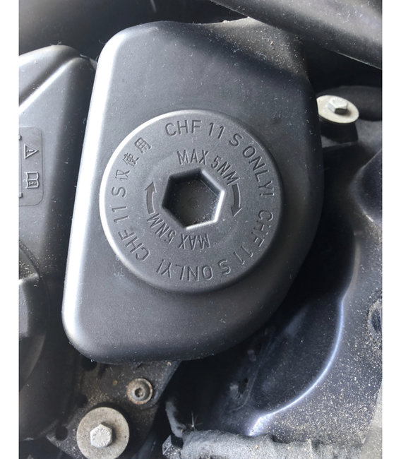

So, looking under the hood found this reservoir for ch11s which is usually for P/S fluid on many German cars. But I thought this was for hydraulic suspension but it turned out it was very low. I added some and now the steering is working but i don't see any leaks. Also, if this is an electronic steering how come it is taking fluid?

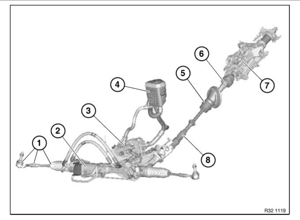

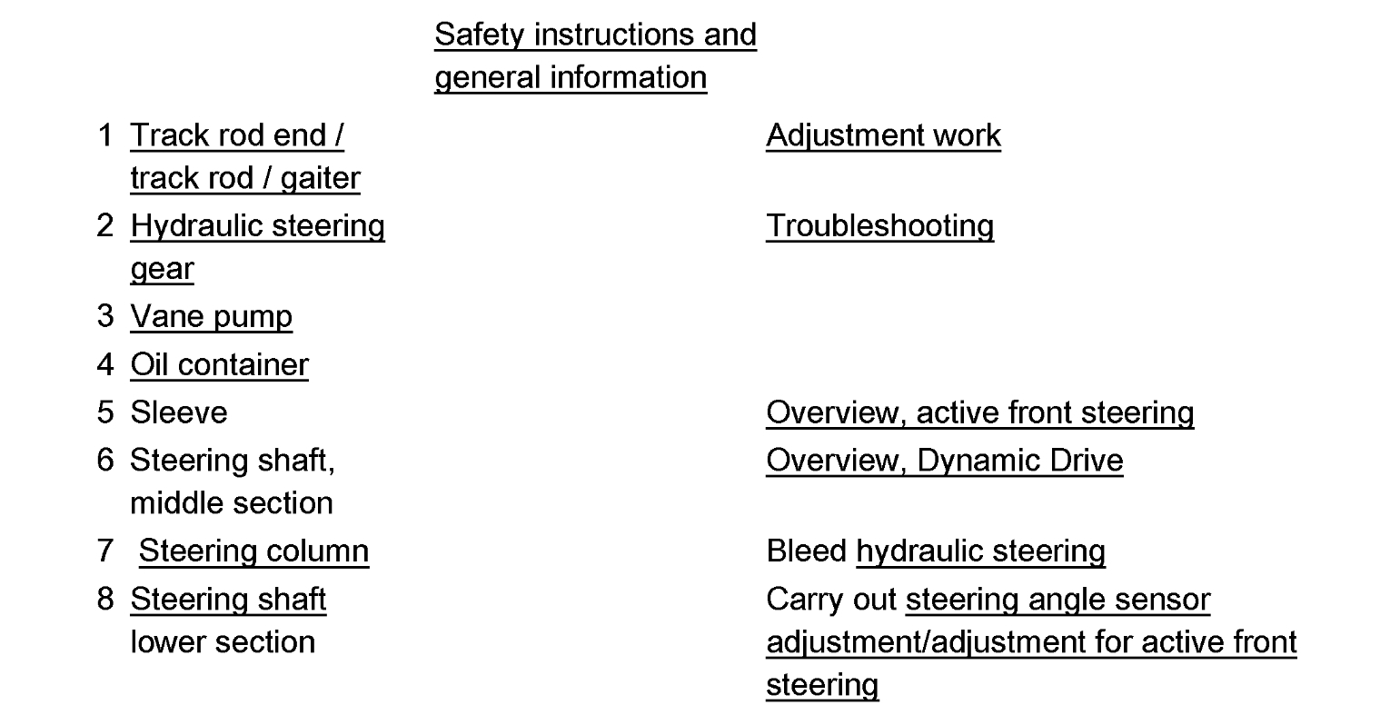

It is a combination steering with both electronic and hydraulic. Here is an exploded view with the part identification. I would get a flashlight and raise the front up to look for leaks. this guide can help. You might need to remove the lower panels.
Aug 4, 2022 at 11:31 AM
