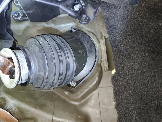

in the first picture the steering boot isn't completely on the plastic. Is that a concern and can i zip tie or hose clamp it back?

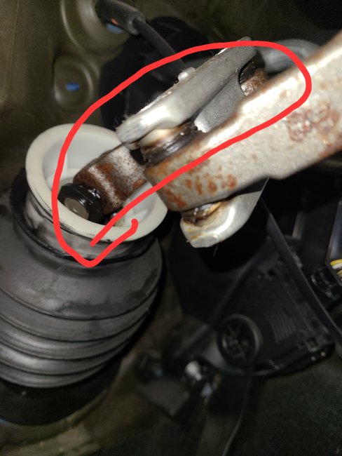

Second picture can i apply some lube to those areas and which kind can i use? i have heavy duty wheel hub / axle grease (green stuff) i have a white silicone grease and silicone spray.

I wouldn't be overly concerned with pic 1. If you want, you can use a zip tie to hold it in place. Just make sure not to crush the plastic component when you tighten it.
The items in pic 2 can be greased as well. I would use a general grease, the same as what is used on steering components. If you have wheel bearing grease, it can be used.
However, I don't know if you will successfully get the grease into the joint. These are usually sealed and not serviceable.
