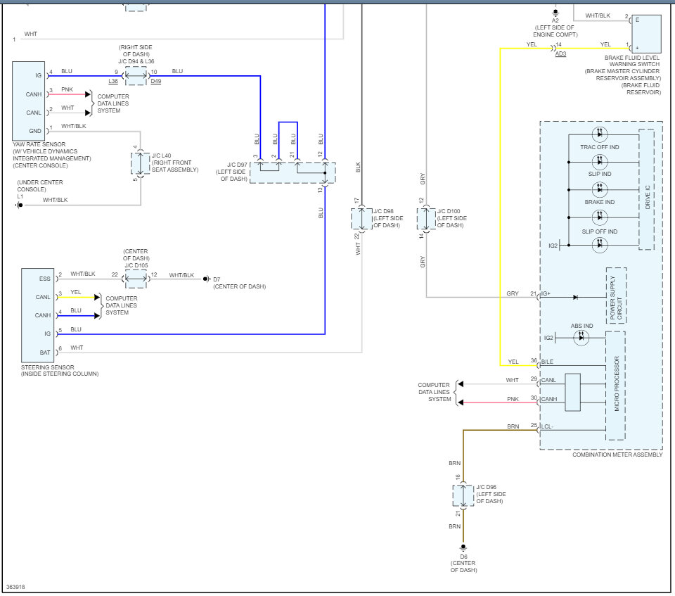

Good evening, the vehicle display light on the dashboard, when the scanner was connected it display "steering Angle Sensor Internal Circuit" as the code. The code was cleared but it came back immediately. The steering clock spring with the steering angle was replaced but the problem persisted. The scanner was set to live data on the steering angle sensor while the steering is been turned at some angle or left and right but the reading was not changing on the scanner. It has a ready of -864. It doesn't change at all. The fuses have been checked and they are ok. It was also confirm that there is voltage at the send connector.

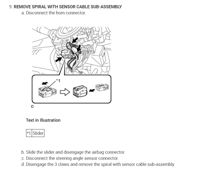

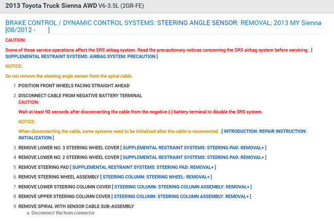

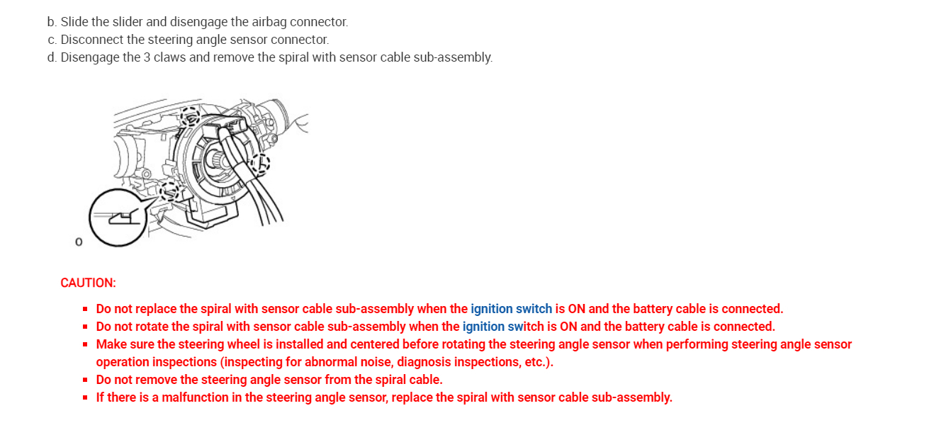

There are some cautions when doing this job.
CAUTION:
Do not replace the spiral with sensor cable sub-assembly when the ignition switch is on and the battery cable is connected.

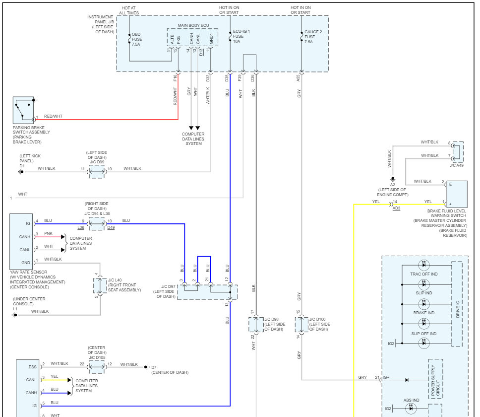

Here is how to replace the steering wheel angle sensor in the instructions below. You could have a bad sensor it is was not installed correctly. There is also a fuse that runs the system I would check ECU-IG 1 in the interior fuse panel on the left side of the dash. Here are the wiring diagrams for the sensor as well so you can see how the system works. Check out the images (below). Let us know what happens and please upload pictures or videos of the problem so we can see what's going on.
