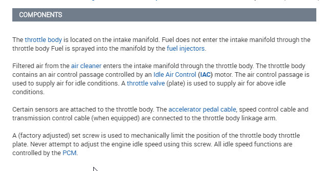

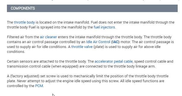

When you say you replaced the AIC, do you mean the IAC? Idle Air Control?
When you press the accelerator you are only opening the throttle plate to allow more air in. Fuel is only controlled by the PCM opening the injectors for a longer time.

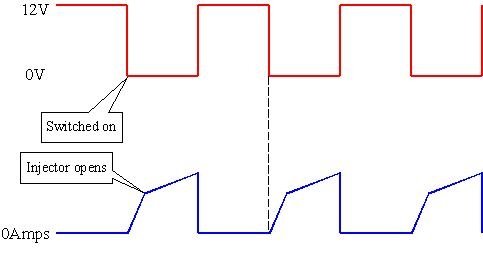

Some Engine Computers can detect some problems caused by injectors by monitoring the current wave forms. This graph shows the voltage and current for one injector. 12 volts is applied to all the injectors, then the control side is pulled to ground by the driver in the computer. That's the red "voltage" graph on top. Current, in the blue graph, ramps up relatively slowly as the electromagnetic field builds around the coil of wire in the injector. When that field gets strong enough, the pintle valve is pulled off its seat to open and let fuel spray in. The point at which that happens is shown by the transition in the "rise time" part of the wave form. That is what the computer looks for. If it doesn't see that transition, it sets a fault code for "injector circuit performance". As far as what I've been taught, Chrysler doesn't monitor that. They just apply the 12 volts and ground to the injector, then the computer assumes the injector responds properly, and it verifies that by watching the oxygen sensor signals.
I know it's a lot more work, but since injectors are way down at the bottom of the list of suspects, I would entertain a notion to switch the suspect injector with one of the others, erase the fault code, then drive it and see if a code sets for the same cylinder or the cylinder the suspect injector was moved to. I'd be very surprised if the fault code followed the injector, but there's always a first time.
