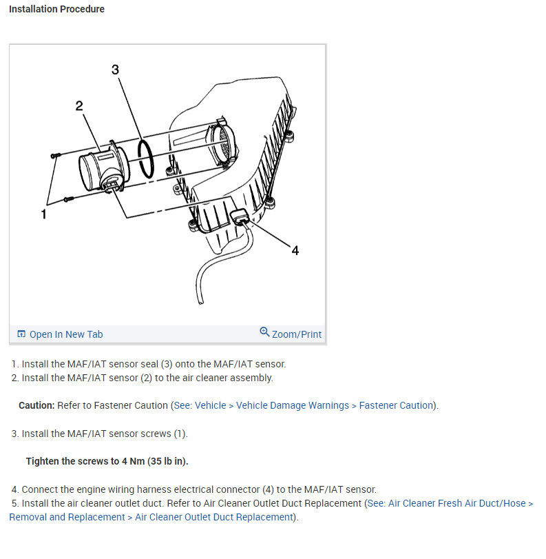

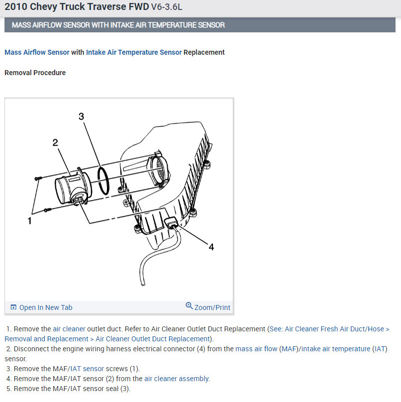

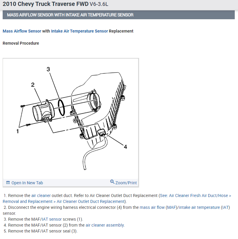

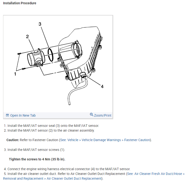

A dirty mass air flow sensor can impact the idle in this manner.
https://www.2carpros.com/articles/mass-air-flow-service
