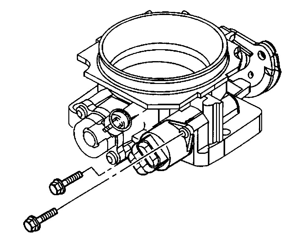

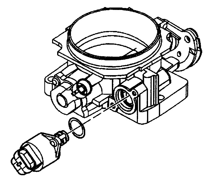

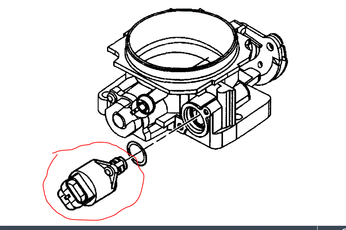

When we start our truck its rmp jumps to over 3000 then shuts off unless we hold the gas pedal. What could be wrong?

This could be the result of a few different things. First, check to see if there are any engine vacuum leaks. Here is a link that shows how to check:
Next, the idle air control valve (IAC) is responsible for maintaining engine idle speed. It is located on the throttle body. I attached two pics below (pics 1 and 2) showing the location. The IAC allows a metered amount of air enter the engine when the throttle plate is closed. So, if it is not functioning or is clogged with carbon, it will cause a problem
Here is a link that explains how to service the IAC:
https://www.2carpros.com/articles/idle-air-control-valve-service
If you determine it is bad, here are the directions for replacement. The last section below will indicate the relearn process.
These directions also explain how to inspect it.

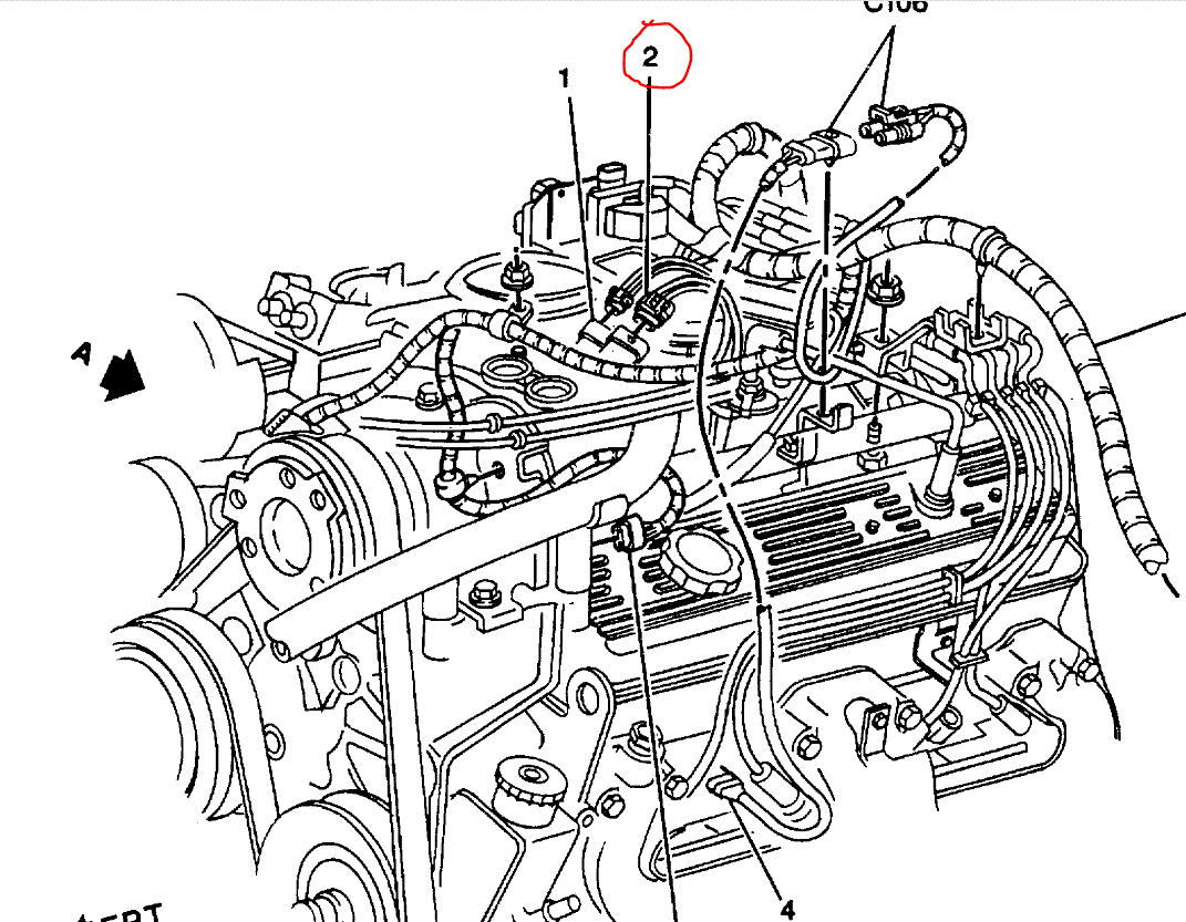

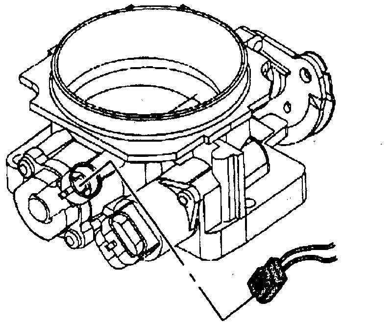

Throttle Position Sensor Electrical Connector

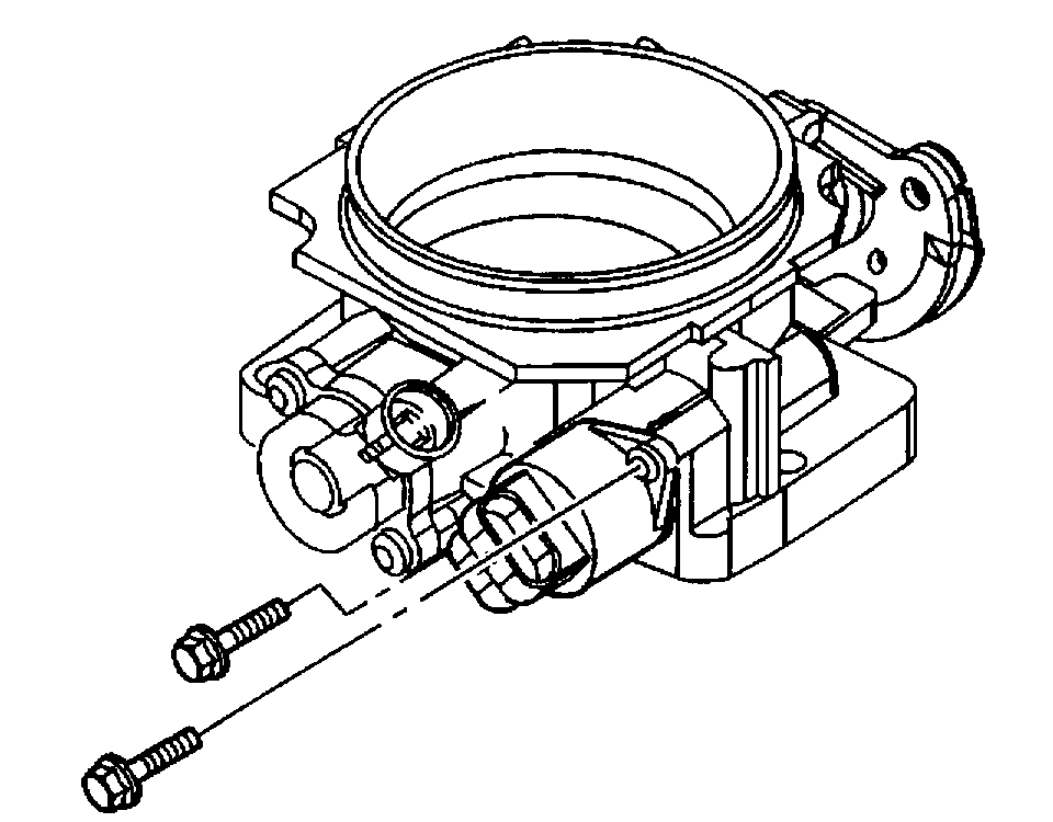

REMOVAL PROCEDURE
1. Remove the electrical connector from the Idle Air Control (IAC) valve
2. Remove the IAC valve attaching screws.
CAUTION: If the IAC valve has been in service: DO NOT push or pull on the IAC valve pintle. The force required to move the pintle may damage the threads on the worm drive. Also, DO NOT soak the IAC valve in any liquid cleaner or solvent, as damage may result.
3. Remove the IAC valve assembly.
4. Remove the O-ring.
CLEANING AND INSPECTION PROCEDURE
1. Clean the IAC valve O-ring sealing surface, pintle valve seat, and air passage.
Use the carburetor cleaner and a parts cleaning brush in order to remove carbon deposits. Follow instructions on the container.
Do not use a cleaner that contains methyl ethyl ketone, an extremely strong solvent and not necessary for this type of deposit.
Shiny spots on the pintle or seat are normal. They do not indicate misalignment or a bent pintle shaft.
If air passage has heavy deposits, remove the throttle body for complete cleaning.
2. Inspect the IAC valve O-ring for cuts, cracks, or distortion. Replace if damaged.
NOTE: If installing a new IAC valve, replace with an identical part. The IAC valve pintle shape and diameter are designed for the specific application.

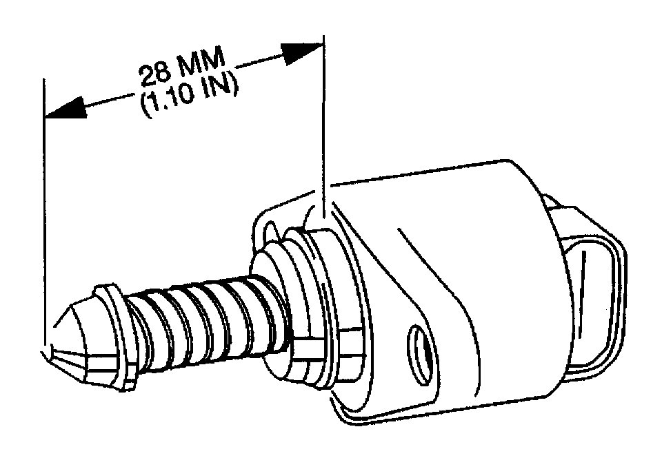

3. Measure the distance A between tip of IAC valve pintle and mounting flange. If greater than 28 mm, use finger pressure in order to slowly retract the pintle. The force required to retract the pintle of a new valve will not cause damage to the valve.
MEASUREMENT PROCEDURE
NOTE: If installing a new IAC valve, replace with an identical part. The AC valve pintle shape and diameter are designed for the specific application.
INSTALLATION PROCEDURE
2. Lubricate the IAC valve O-ring with clean engine oil.
2. Install the IAC valve assembly.
3. Install the attaching screws.
Tighten
Tighten the IAC valve attaching screws to 3.0 Nm (26 lb. in.).
4. Install the electrical connector.
5. Reset the IAC valve pintle position.
5.1.Turn the ignition switch to the ON position for 5 seconds.
5.2.Turn the ignition switch to the OFF position for 10 seconds.
5.3.Start the engine.
5.4.Check for the proper idle operation.

We have already replaced the throttle position sensor and the idle air flow sensor. I was driving it to get my husband the last night an it started losing power. I got to almost his work an had to stop at a light the it just completely shut off. We are lost at what could be wrong with it.

Whenever we start our truck it revs up to pass 3,000 RPM's and it is slowly come back down and shut off unless we keep and feather the gas and keep it running above 3,000 RPM's it'll run and we've already changed the throttle the position sensor and the idle airflow sensor and we've changed the mass flow thing too. we don't think it's a fuel pump because we was getting good gas and stuff. we just don't know what it could be. could it be our spiders? we replace them but they was refurbished a while back so I don't know if that could be it or not.
Nov 8, 2020 at 1:36 AM
Okay. We need to check 3 things. Even though you replaced these sensors that doesn't correct for an air restriction or faulty IAC. So Joe attached the info on the IAC which is different then the TP sensor or the mass air flow sensor. We need to remove that and clean it or replace it. The reason is, you are holding the throttle open which is bypassing the IAC and allowing more air to come in. So if the IAC is not allowing the proper amount of air in it will not allow the engine to keep running.
