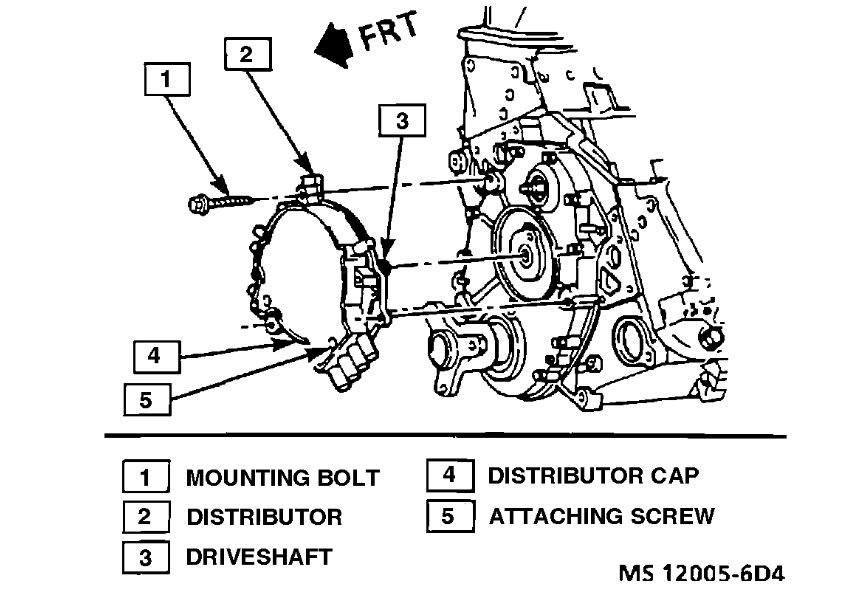

This engine and transmission has been installed in a 1951 Chevrolet. I had it running well last time I started it about a week ago. Now it starts as it should but shuts off within a few seconds. The fuel pressure is good. It doesn't run long enough to get any real info from my test equipment and hasn't set any codes. I used the stock engine and transmission but removed all the emissions systems. I have a tuner that allowed me to turn off VATS, EGR, and other non-essential items. The car ran very good last week.

I would also check the distributor. Common for the cap and rotor to get wet and cause this type of issue.

It is a project vehicle and has never been out of the shop so I know it isn't moisture related. Fuel pressure is 48 psi with the vacuum line disconnected. It starts every time I try it and then shuts off, no waiting required.

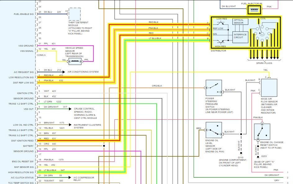

This does sound like you are losing spark.
Can you test the power to the distributor with the key on? I am wondering if you have power in the start position and not in the run position.
Do you have a scope that can monitor the signal from the distributor to the ECM?
