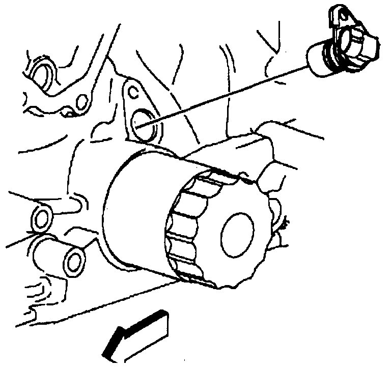

I bought this vehicle with a supposed bad fuel pump. I have found my problem is not fuel system related. New fuel pump, filter and regulator. Still same issue. The battery was new but totally dead when I bought the car. After charging battery, I found that when you turn the key on, the fuel pump stages as it should and the only instrument light that comes on is the check engine light. Fuel gauge works but no idiot lights. When you turn the switch to start, the engine fires, stumbles for just a second, then dies, the check engine light goes out and the engine will not fire at all until the key is turned off and then back on to stage the fuel pump again. I think someone had been investigating before because of evidence I have found with dash screws out and/or loose etc. Do you have any idea of where/ what to look for etc? Im stumped right now. Oh, all the exterior lights come on with the key, not just the daytime running lights. Thanks. Please help.

The idea that it starts, shudders, then stalls makes me think of a problem with the crankshaft position sensor. This sensor is responsible for sending a signal to the power-train control module. Based on the signal, the PCM then determines ignition timing, spark distribution, and fuel injection timing. Have you checked the sensor?
Here are directions for removal and replacement of the sensor. If it is failing, it could be the cause of the running issue. The attached picture correlates with the directions.

1996 Pontiac Grand AM L4-144 2.4L DOHC VIN T SFI
Crankshaft Position Sensor Replacement
Vehicle Powertrain Management Sensors and Switches - Powertrain Management Sensors and Switches - Computers and Control Systems Crankshaft Position Sensor Service and
CRANKSHAFT POSITION SENSOR REPLACEMENT
See pic 1
REMOVE OR DISCONNECT
1. Disconnect the Crankshaft Position Sensor (CKP) sensor harness connector at the sensor.
2. Remove the CKP sensor to block bolt.
3. Remove the CKP sensor from the engine.
INSTALL OR CONNECT
NOTE: inspect the sensor O-Ring for wear, cracks or leakage. Replace if necessary. Lubricate the new O-Ring with engine oil before installing.
1. Install the CKP sensor into the block.
2. Install the CKP sensor to block bolt.
- Tighten the bolt to 10 Nm (88 lb in).
3. Connect the CKP sensor harness connector.
