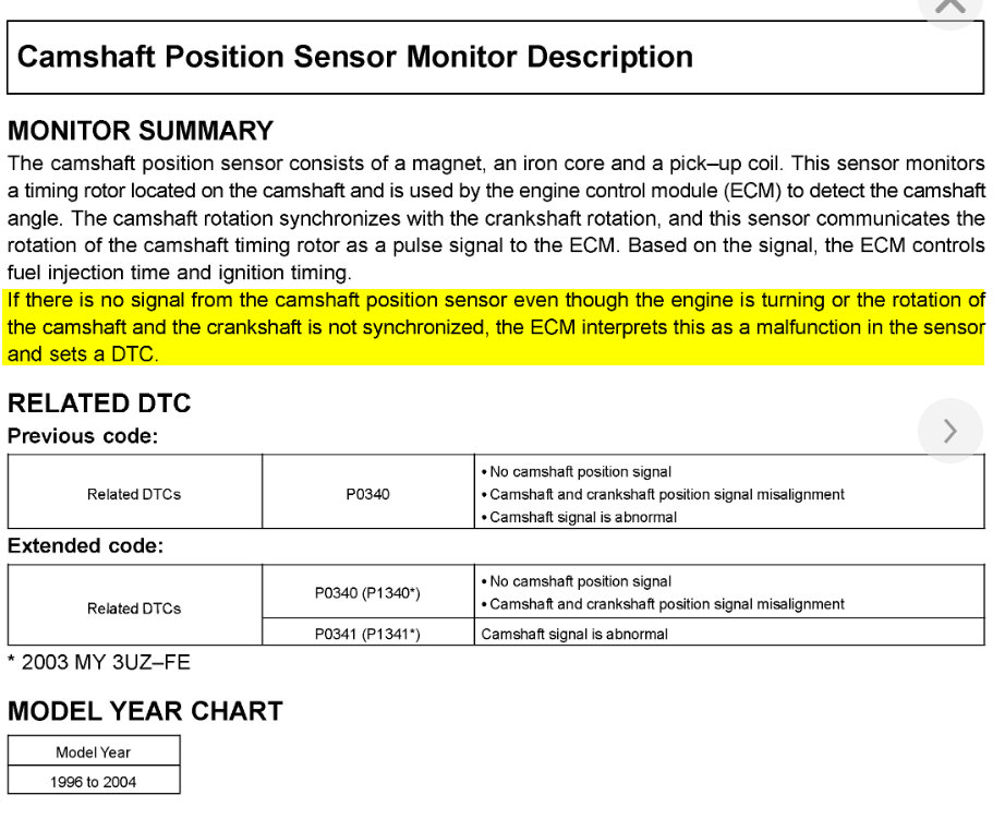

I replaced the alternator and battery engine turns over starts in early morning. Then it won’t start again until the next morning. Throwing code P0340. Camshaft Position Sensor A circuit bank 1 or single. I have read that this shouldn’t prevent it from running. I was told by shop It needs value cover gaskets, transmission speed sensor and block off plate.
Aug 6, 2019 at 12:17 AM
Hi Randy,
Have they suggested these items to address the no start issue? I am just not sure why any of these would cause a no start, so I am just a little confused on that.
As for diagnosing this, you are correct the cam code usually does not cause a no start because all that is required is the crankshaft on most engines. However, on your engine it is not crystal clear that this is the issue. Please refer to the highlighted attachment as it states the cam sensor is used for fuel and ignition timing.
If this is the case, it implies that if there is no signal that it will not fire the plugs or injectors. If this is the case, then the engine will not start. Normally it will just crank longer until it uses the crank sensor to determine cam position then it will start.
I would suggest measuring fuel pressure and checking for spark when it is acting up and that will be more definitive. Even if this is not causing your no start condition, they still need to address the code because this system needs to operate to ensure the engine is running efficiently.

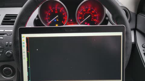

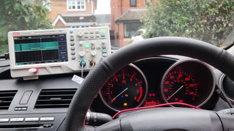

I'll put together a video today with the symptom and forscan/oscilloscope readings for spark/CKP/CMP

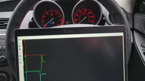

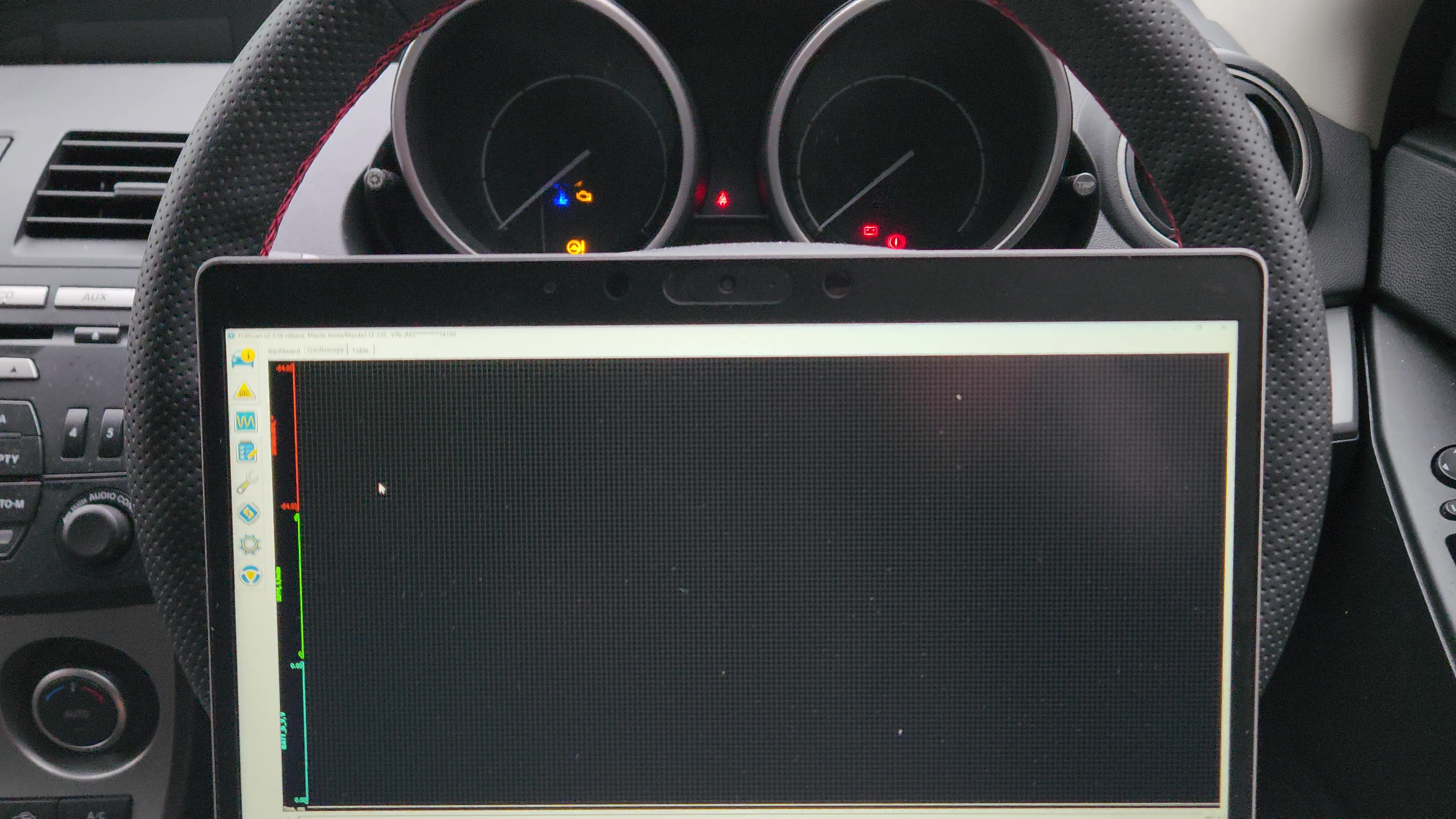

CATALIN BUICA
The engine sounds normal while cranking and has a brief start attempt then throws the code while still cranking until crank limit time is exceeded.
The CKP sensor is sending 5v pk to pk square signals as engine cranks.
The CMP sensor is sending 0.5v pk to pk square signals while cranking.
CMP harness has a 5V reference from PCM with the sensor disconnected, 0.6v on the same line with the sensor connected but dismantled from the engine block. 0V with the sensor close to metal.
CKP harness has 5V reference with the sensor connected and off the block. 0V with the sensor close to metal.
This is the third sensor (CMP). Original one gave the same error after the car stalled at 60mph with both CMP and CKP errors, after replacing CKP only the CMP error remained. New timing installed to no avail, same dreaded P0340.
I'm trying to get a properly triggered recording of both signals this evening after the battery is charged back up.

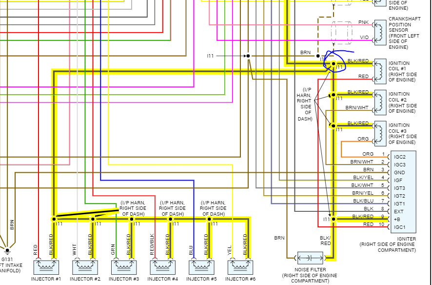

I watched the video. There is no RPM signal. The tachometer should move a little when cranking. Confirm that for me.
You indicated it has both fuel and spark. Are you certain that fuel is making its way into the engine? The engine sounds normal cranking. There is no indication of a timing issue. So, if we have compression, spark, fuel, and the timing is correct, the engine has no choice but to run. Try the starting fluid and let me know what happens.
If it does start and then stall with starting fluid (it should if there is spark), at each fuel injector will be a black wire with a red tracer. With the ignition in the run position, check any of those wires for power. I noted a splice between the power supply that could allow power to the coils but if it failed, we may have lost power to the injectors.
Also, please confirm this is the same year, make, and model as the original post.
See pic below.
