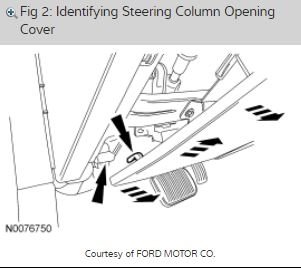

The car only starts (usually) when you simultaneously jerk the steering wheel and turn the ignition switch.

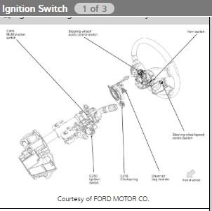

Wow, that is an interesting one, but anything is possible. First, keep in mind, the tumbler where you place the key is not the switch. The ignition switch is an electrical component located below the steering wheel in the column. Based on your description, it sounds like either you have a loose connection or the switch itself is going bad.
I have attached a picture of the component for you to see both the part and its location. It is picture 1.

2) Remove the column opening cover

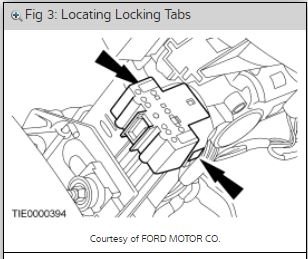

4) Remove the upper and lower steering column shrouds (see picture 2)
5) Disconnect the switch connector
6) Release the two retainer tabs and remove switch.
Replacement is reverse of removal. Check to see if the connector is lose or damaged. If it is not, suspect the switch itself.
