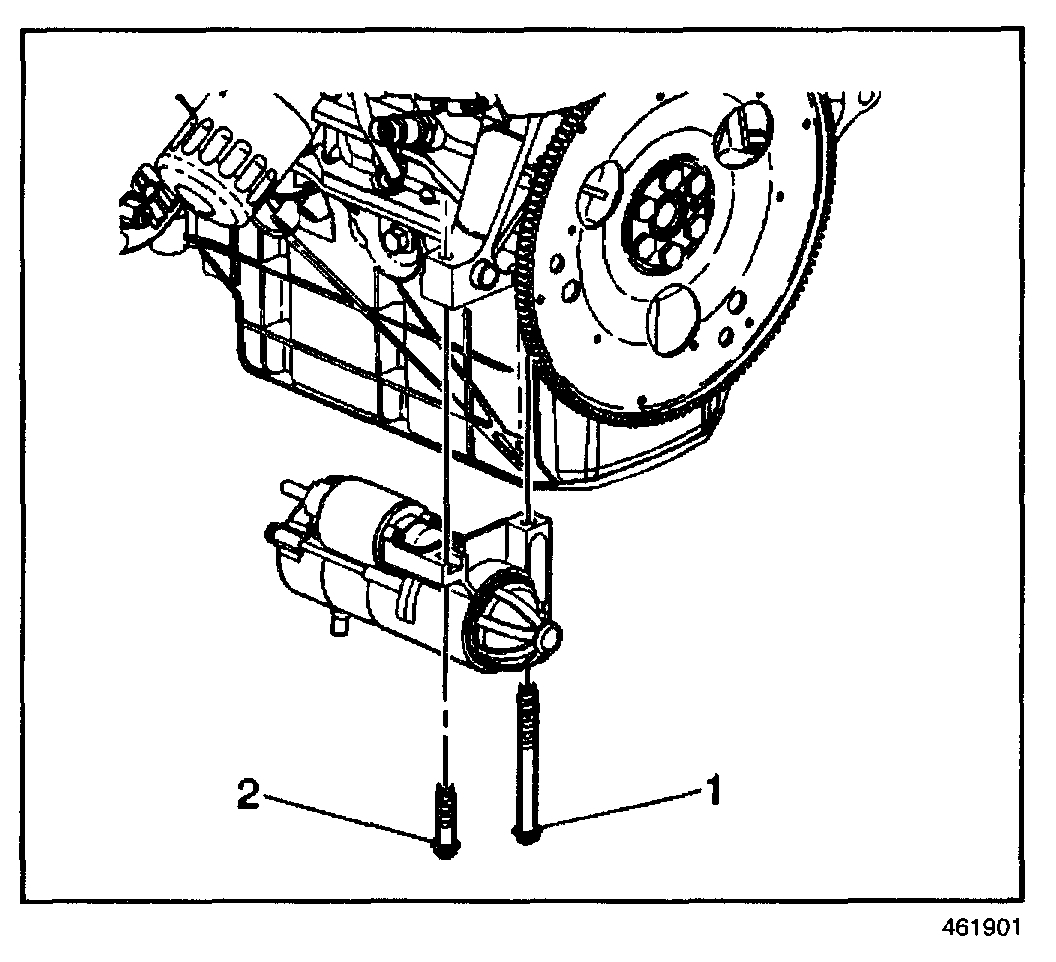

When trying to start starter will spin but won't extend and engage flywheel.

That sounds like the Bendix is bad. That is the part that forces the gear in the starter to extend and engage with the flywheel. If you hear the starter motor spinning really fast but the engine itself (look at the engine belt) isn't turning, replace the starter. There was a time when people would replace the solenoid/Bendix, but it really isn't cost effective anymore. Actually, I don't even know if you can still purchase individual parts like that.

REMOVAL PROCEDURE
IMPORTANT: The starter motor on this vehicle is NOT serviceable and must be replaced as a complete unit.
pic 1
1. Disconnect the negative battery cable.
2. Raise and support the vehicle. Refer to Lifting and Jacking the Vehicle.
3. Remove the lower air deflector.
4. Remove the torque converter covers.

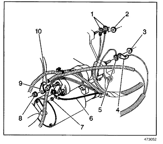

5. Remove the starter solenoid BAT terminal nut (8) and remove the positive battery cable (9) from the starter motor.
6. Remove the starter solenoid S terminal nut (7) and remove the starter solenoid wire (6) from the starter motor.
pic 2
7. Remove the starter bolts (1,2) and remove the starter motor. Remove the shims, if necessary.

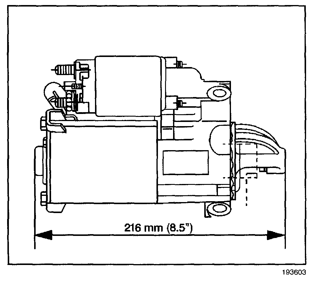

pic 3
1. The 3.4L uses a PG260 F1 starter motor. Verify that the correct starter motor is being installed.

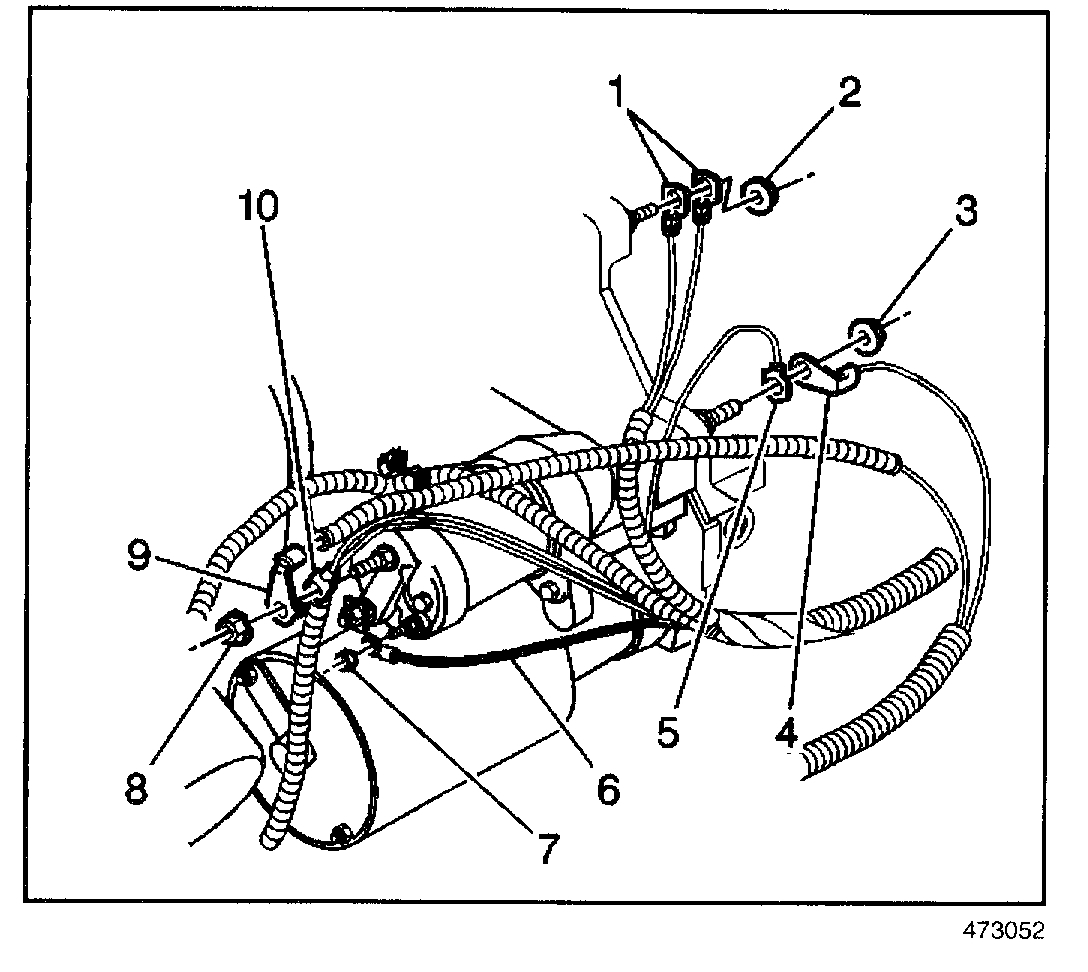

pic 4
2. Align the starter motor to the engine. Install any shims, if removed.
NOTE: Refer to Fastener Notice in Service Precautions.
3. Install the starter bolts (1,2) finger tight until seated.
Tighten
Tighten the starter bolts to 43 N.m (32 lb ft).

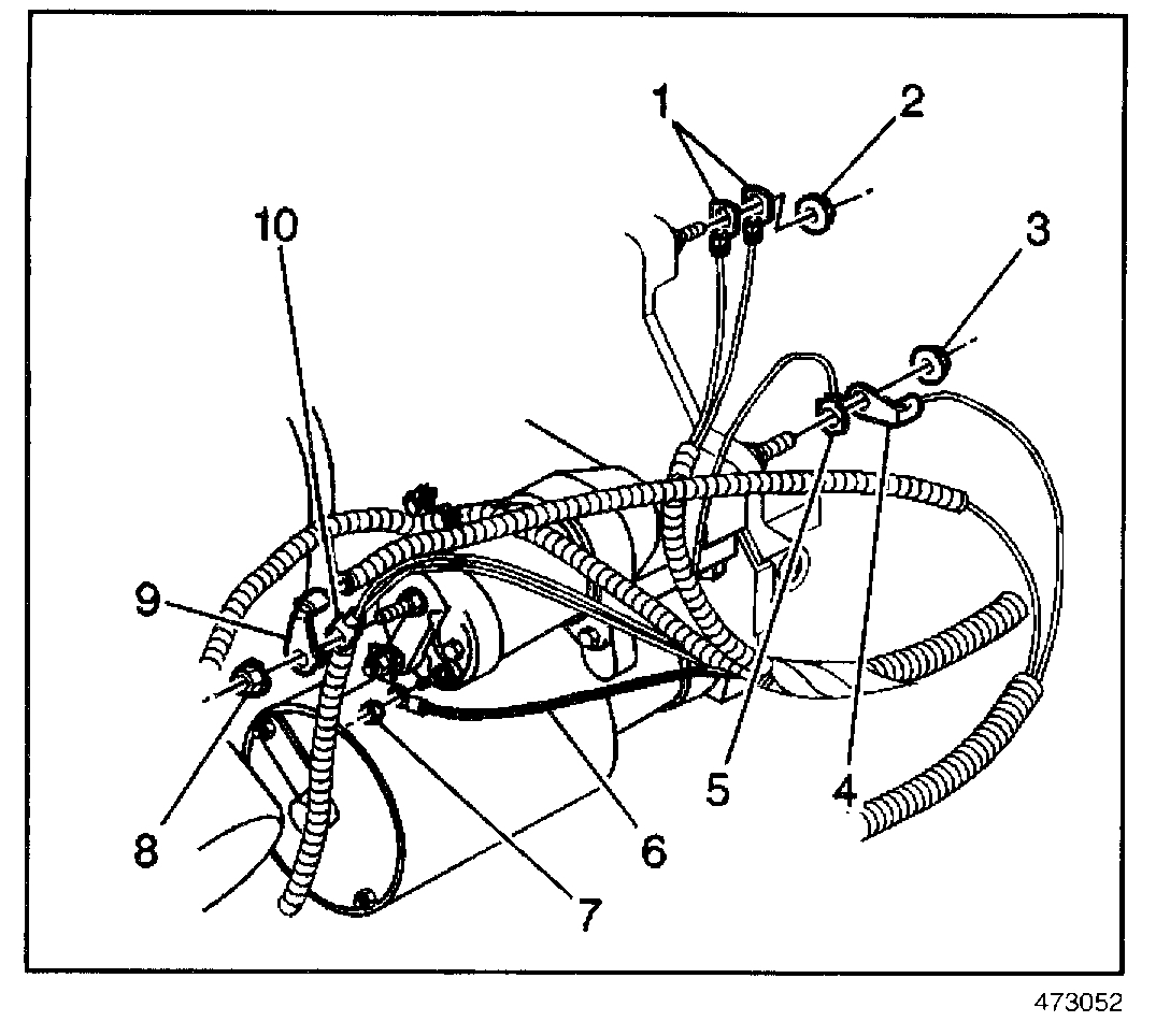

pic 5
4. Install the positive battery cable (9) and install the solenoid BAT terminal nut (8) finger tight to the starter motor.
Install the starter solenoid wire (6) and install the starter solenoid S terminal nut (7) finger tight to the starter motor.
Tighten
Tighten the solenoid BAT terminal nut (8) to 10 N.m (89 lb in).
Tighten the starter solenoid S terminal nut (7) to 2.3 N.m (20.5 lb in).
