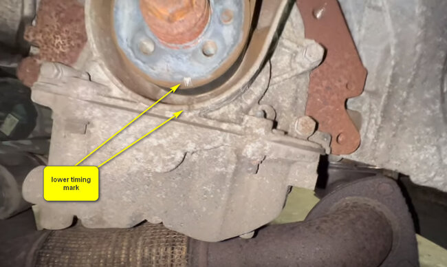

A quick way of checking is to line up the timing marks of the crankshaft sprocket with the lower oil pump casing, at about 6 o'clock, see image 1 below.

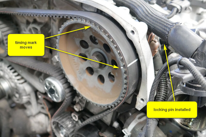

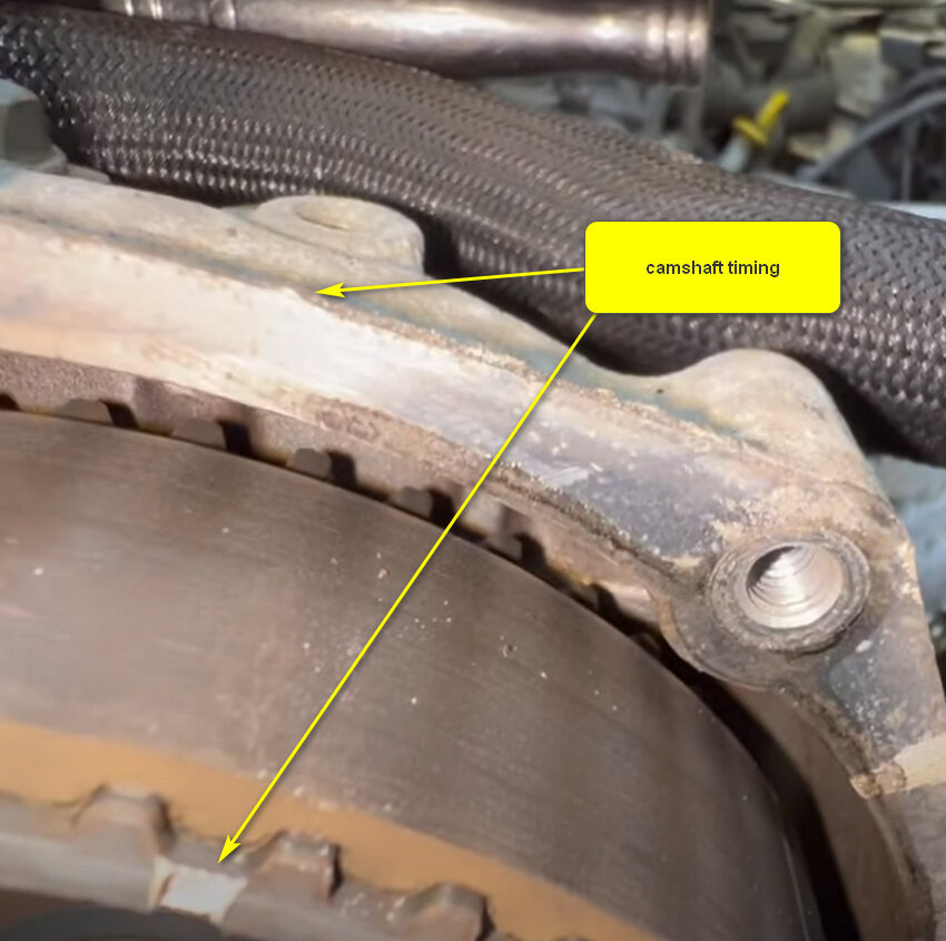

Also, the exhaust camshaft sprocket mark needs to line up with a very faint mark, hump, on the rear timing cover at about 1 o'clock. See image 2.

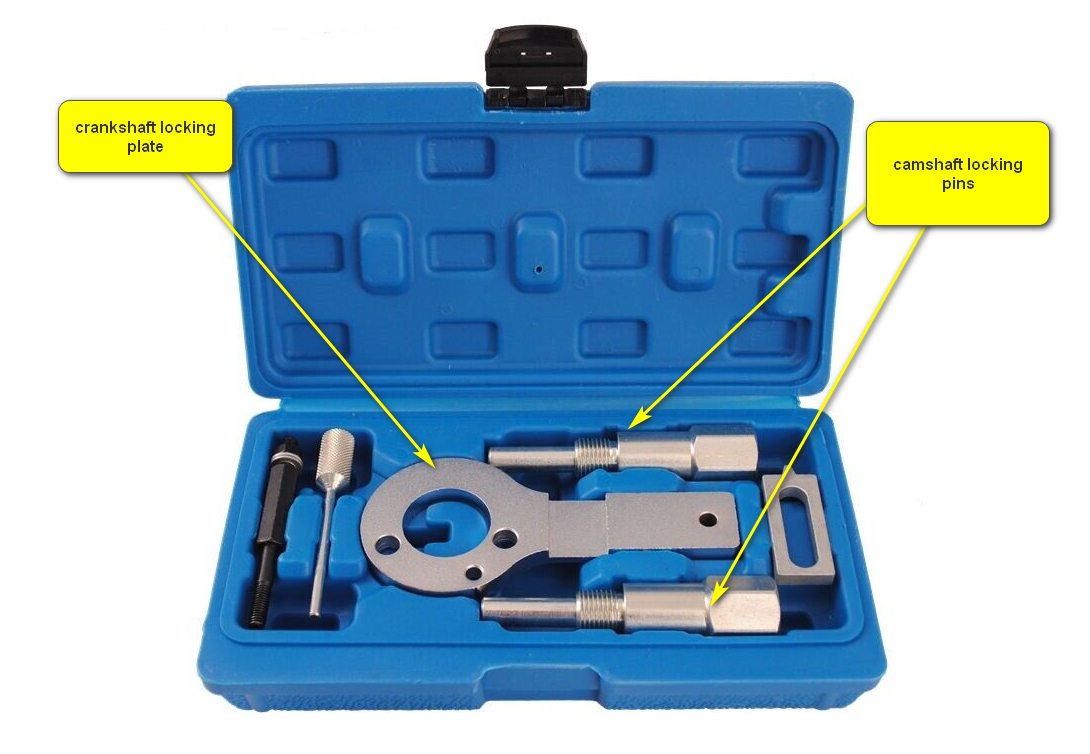

The only, proper, way to determine if the timing belt has slipped, apart from missing teeth/physical damage, is to time the engine up with the 3 locking tools. See image 7

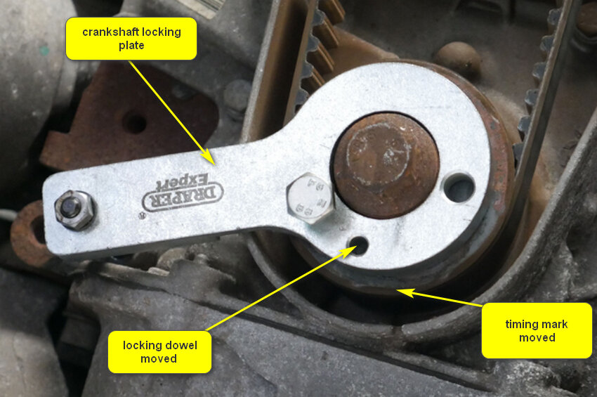

These consist of a crankshaft locking plate which is attached to the crankshaft front sprocket, requiring removal of the crankshaft pulley, and 2 crankshaft locking pins.
See image 3, crankshaft locking plate installed. Note that the crankshaft needs to be rotated off its TDC (Top Dead Center) mark to allow the locking plate to be installed.
The timing mark will move to the 9 o'clock position and the locking dowel moves from the 3 o'clock position to the 6 o'clock position.
Most technicians will only use the exhaust camshaft locking pin as both camshafts are geared together and only the exhaust camshaft is driven by the timing belt.

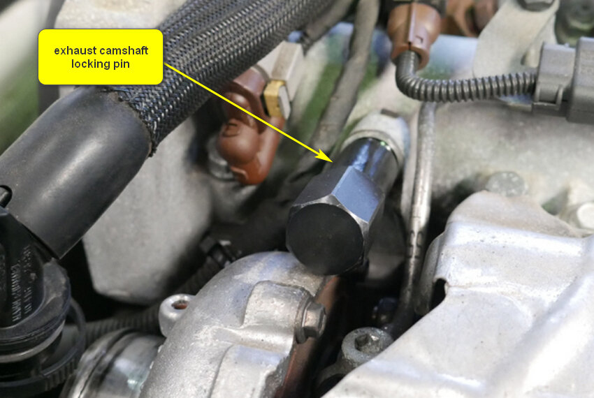

Once the engine has been locked at the crankshaft it should be possible for the exhaust camshaft locking pin to be installed, see image 4+5.

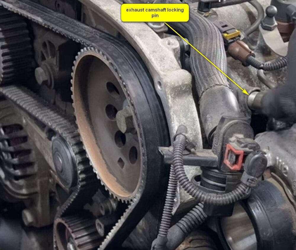

With the locking pin installed the timing mark on the camshaft pulley will move from about 1 o'clock to about 3 o'clock, see image 6.
