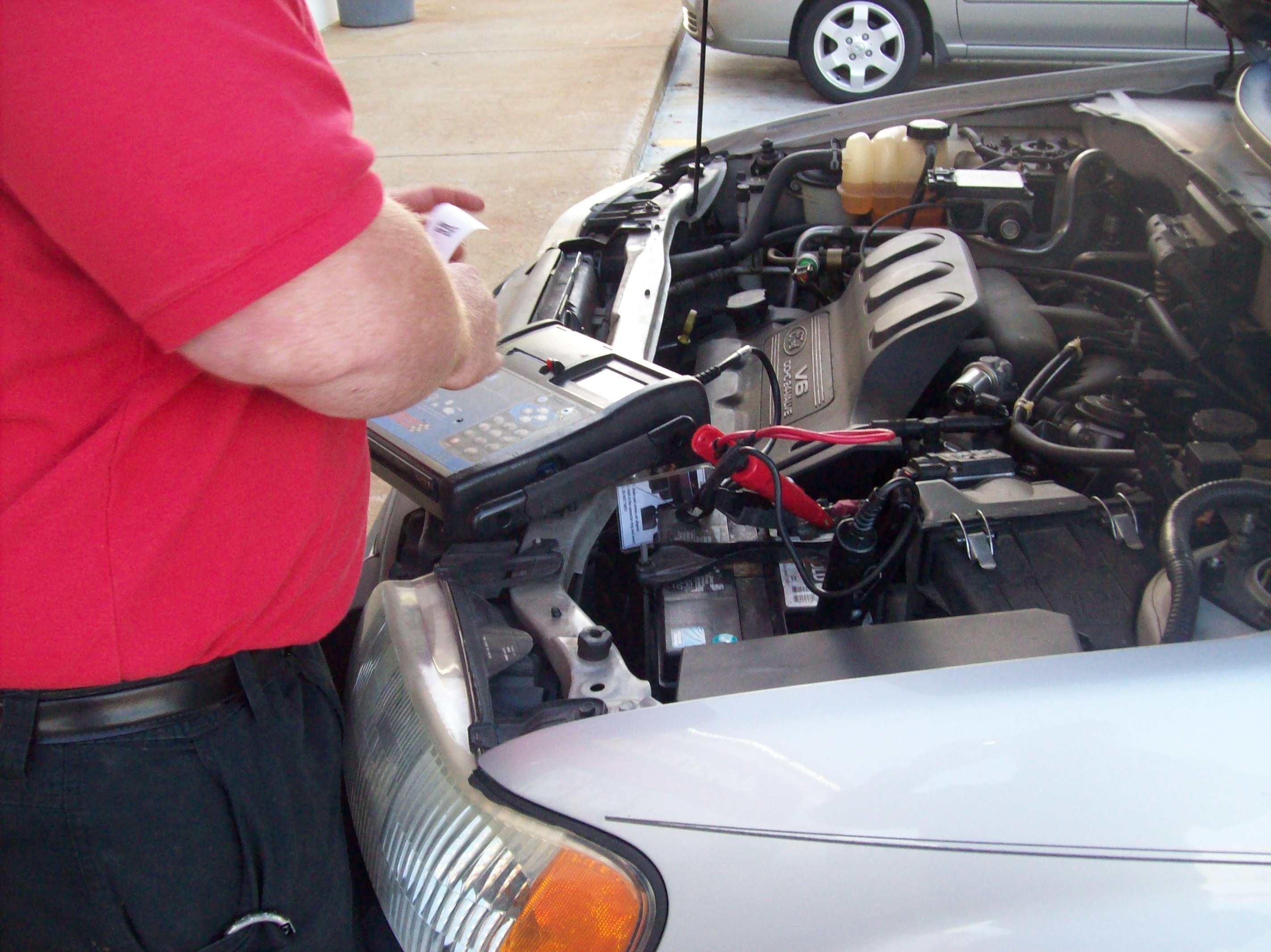

'FORE YOU DO ANYTHING ELSE....TAKE MR. BATTERY TO A POPULAR AUTO PARTS STORE TO BE THOROUGHLY TESTED......'ROUND HERE, THIS IS A FREE SERVICE!.........THIS IS NOT SIMPLE "VOLTAGE TESTING" THEY DO, THEY CHECK IT UNDER LOAD TOO........A BATTERY CAN BE BAD, RIGHT OFF OF THE SHELF...2 DAYS LATER...A MONTH LATER
