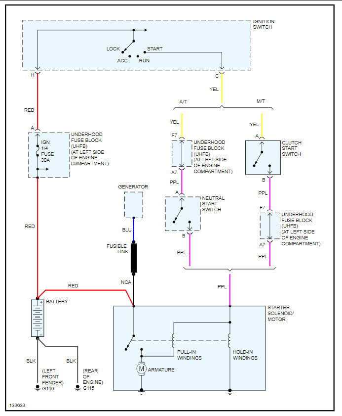

sometimes the car wont start i mean nothing turn to start nothing. i have to push it to start it luckily it a manual. a mechanic i know said it was my solenoid my starter is behind the engine. i had the the starter bench tested by Advance Auto and it came out good. Rick a mechanic said was the solenoid. so i really don't know. when turn key not even a click.
Aug 11, 2020 at 7:55 AM
This could be the solenoid but we need to start with checking for power. I suspect you will not have power to the starter in which case we have another issue. You should have 12 volts all the time on the red wire, and then 12 volts on the purple wire only when cranking. If you don't we need to go in this direction. If you do have this voltage then your starter solenoid is the issue.
However, if they bench tested it, that means they put 12 volts to the solenoid and it turned on so I assume that is okay. This is why we need to check voltage on the vehicle.
Let me know what questions you have. Thanks
