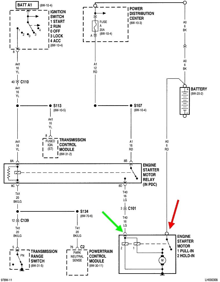

Starter solenoid wiring diagram needed?
1997 EAGLE VISION
123,000 MILES • 3.5L • 6 CYL • AUTOMATIC
EAGLEVISION3.5
Not sure how to connect new starter solenoid.

There's only two wires on Chrysler starter solenoids. The larger red cable is from the battery and goes to the large copper stud, (red arrow). The smaller light green wire bolts to the smaller terminal on the solenoid, (light green arrow).
Let me know if I overlooked something.
