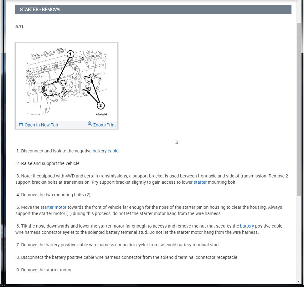

I am replacing the starter on my wife's vehicle listed above. There is no online information on how to do this to be found, but I did discover that in order to replace it, you must remove the catalytic converter from the drivers side which requires removal of the front prop shaft. It consists of a CV joint at each end with 6 Allen head bolts. I've removed the bolts but cannot get the the driveshaft flanges to separate from either the front differential or the transfer case. One person advised hammering on the ends but I cannot seem to find an optimal place to hit that produces results. Someone help!

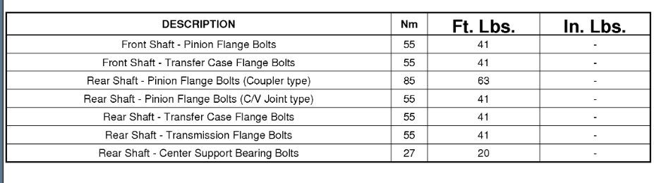

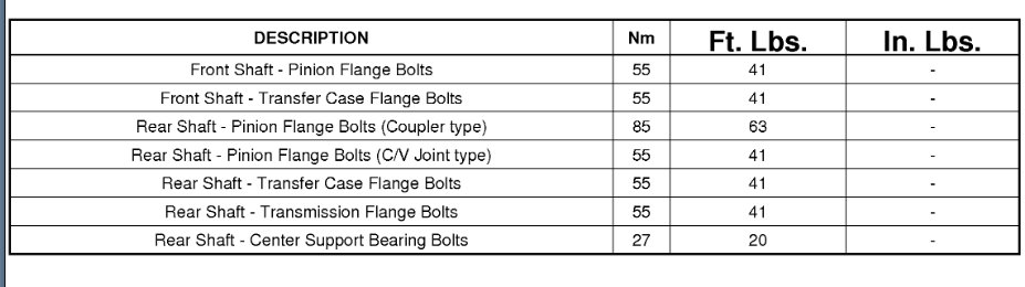

Yes. There are not special tools but most mechanics use long extensions and can get to it from further back in the vehicle. Keep in mind, all these procedures were written for a mechanic in a shop working on a lift. If you are in your driveway then you will probably need to remove the drive shaft just as you are doing. I have watch a few videos and they all do the same thing you are doing.

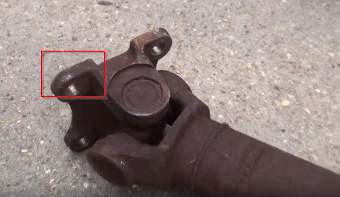

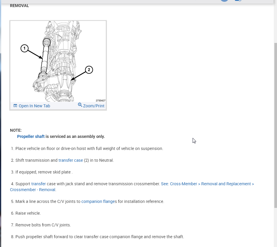

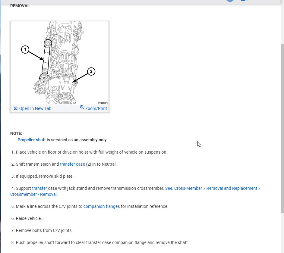

As for getting the driveshaft out, if you have all the bolts out I would suggest putting one of them back in only a quarter of the way and then smacking the flange with a hammer where I circled in the first screen shot below. Try not to smack at an angle because this can distort the flange.

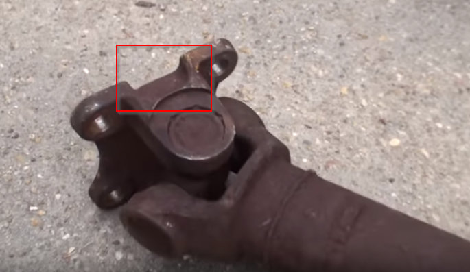

Next screen shot you can put a pry bar in this slot and pry it back away from the flange.
Basically this is seized due to rust. Keep in mind this is metal so you can be rough with it, just don't go crazy on it.
When you get the CV side loose you can push the end towards the CV joint and that should collapse just enough to get it down.
Jan 12, 2020 at 11:17 PM
KPOWERSJR

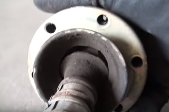

Unfortunately my driveshaft has the CV joint at both ends, unlike the one you have pictured above.
I did, however, manage to get it out with some (lots) persuasion. I ran out of time so I will be putting the driveshaft back in later this week.
Jan 12, 2020 at 11:52 PM
Sorry. You are correct. That was a picture of a 2005 and that was changed in 2012. You may want to check the CV joint of both ends while it is out because they are well known for making a clunking noise when they get worn.
