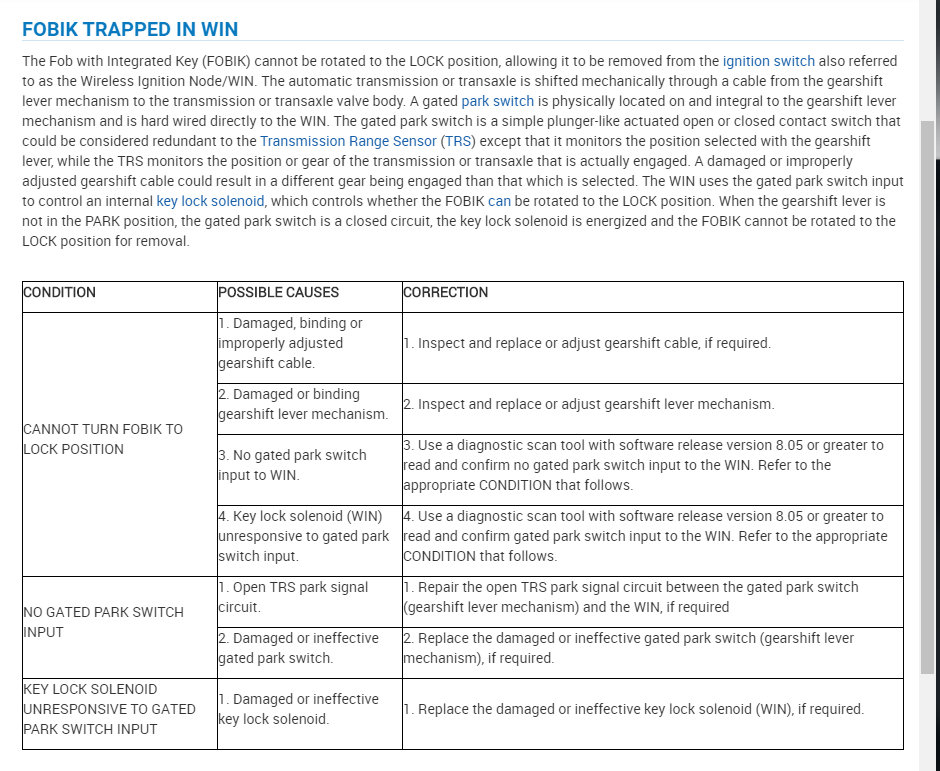

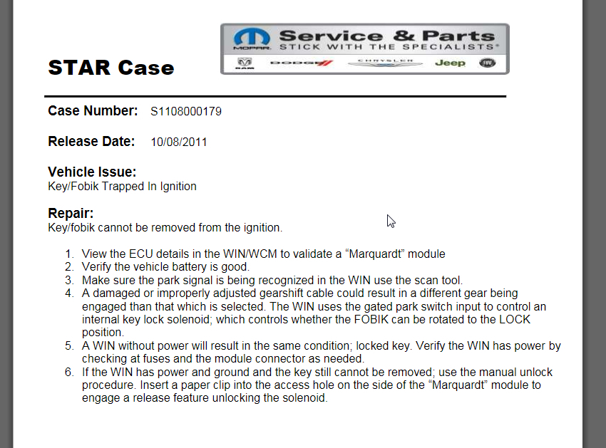

Key is locked in ignition
2011 DODGE CARAVAN
105,000 MILES
WARD MERKELEY
key is locked in starter and will not turn.
Nov 29, 2019 at 1:57 AM
Unfortunately this issue happens on these for a number of reasons. I attached the info needed to determine what the issue is but we are going need a scan tool to look at the computer info to see what the issue may be.
If you don't have access to the scan tool then we are going to need to take it to a shop or a dealer.
Let me know if you have questions and we can go from there. Thanks
