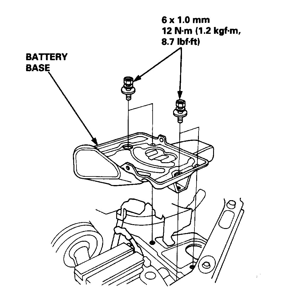

3. Raise the coolant reservoir, then remove the battery and battery base.

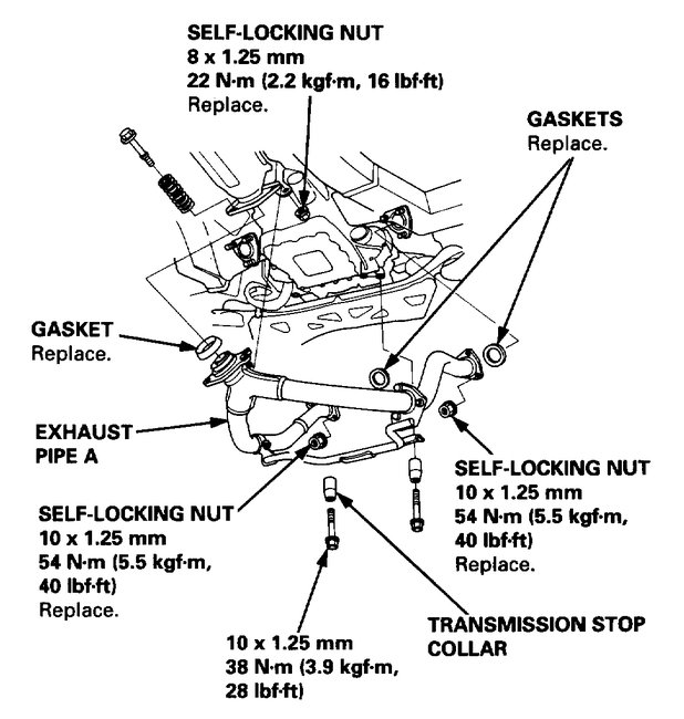

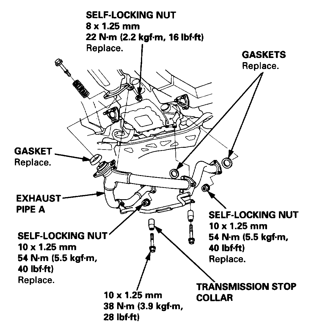

9. Remove the transmission stop collar, then remove the exhaust pipe A.

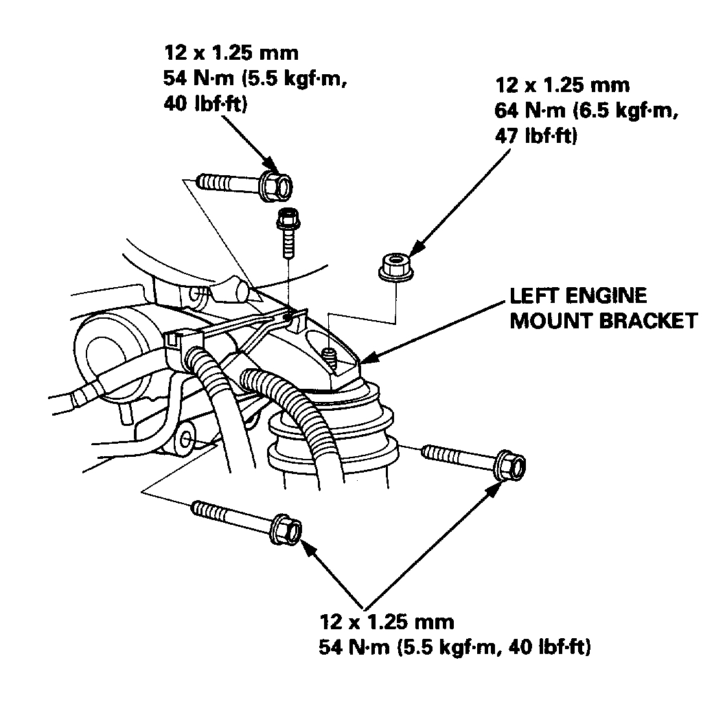

12. Remove the left engine mount bracket.

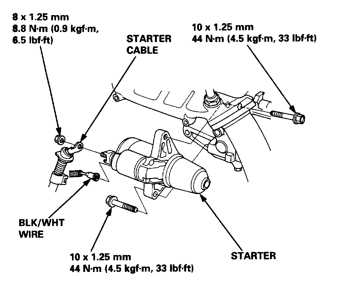

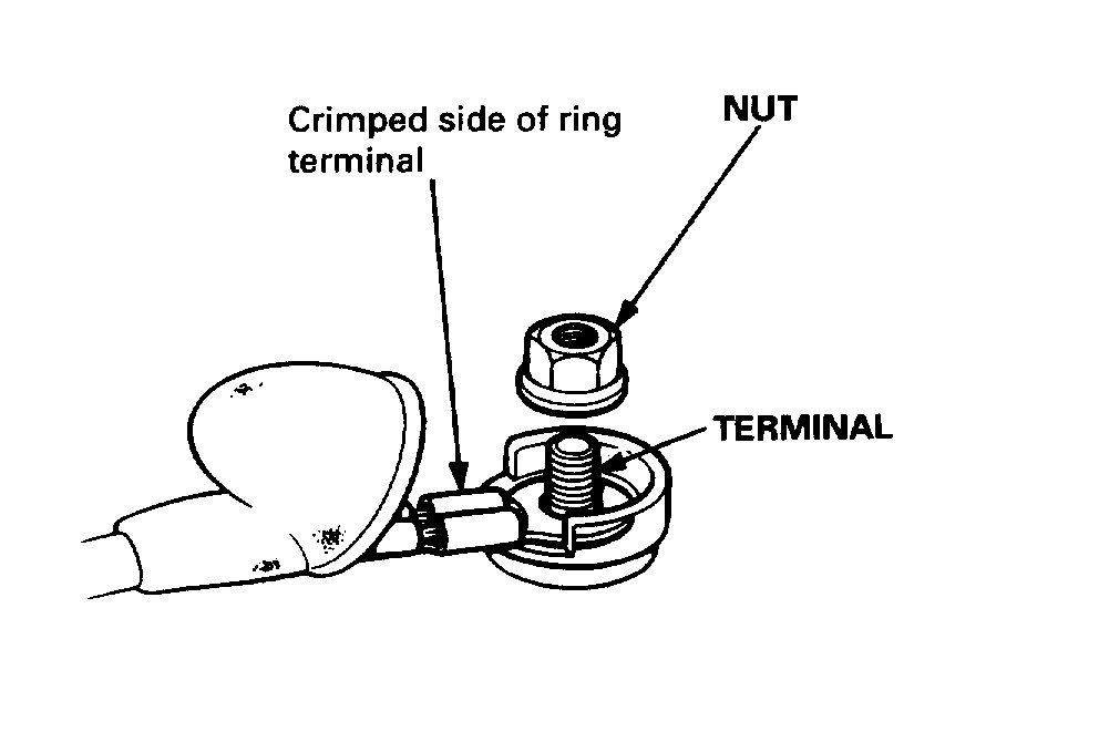

13. Disconnect the starter cable and BLK/WHT wire, then remove the starter.

NOTE: When installing the starter cable, make sure that the crimped side of the ring terminal is facing out.
