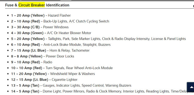

I had it fired up after the rain. While idling it shut down. Tried to start again but there is no power to the panel, radio, wont crank over. Lights and such still work though. I've checked all the fuses and they are fine. There was what looked like a little smoke coming from the driver side under the hood but there is no burnt electrical smell.

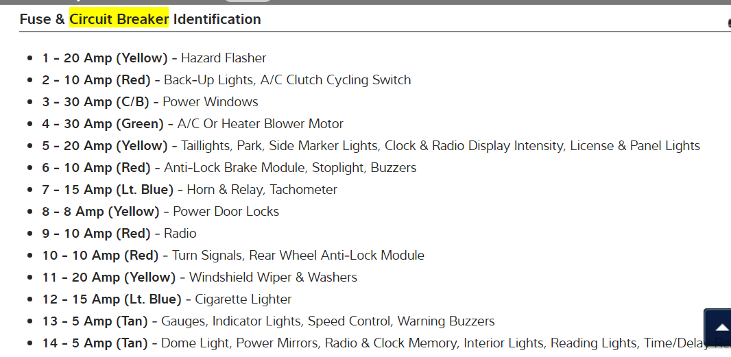

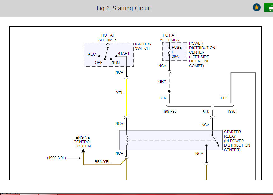

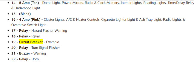

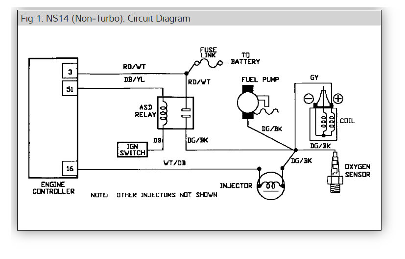

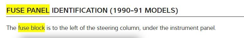

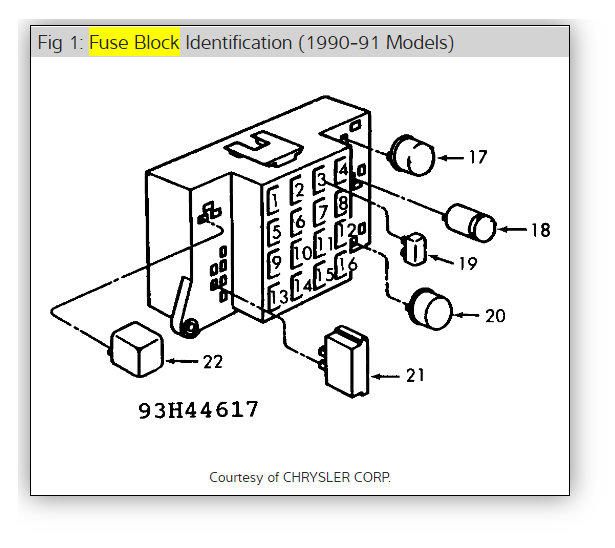

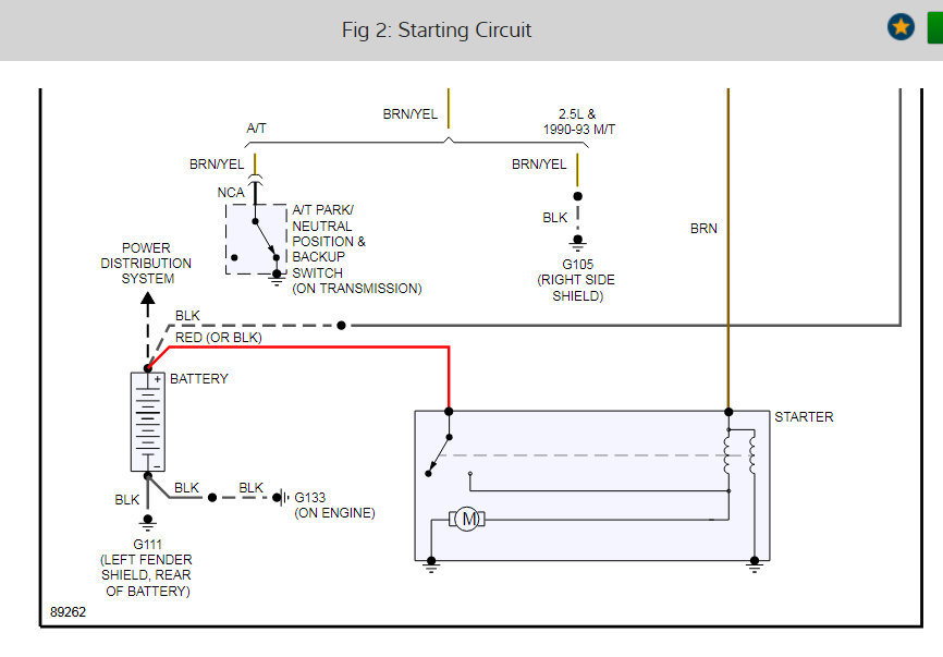

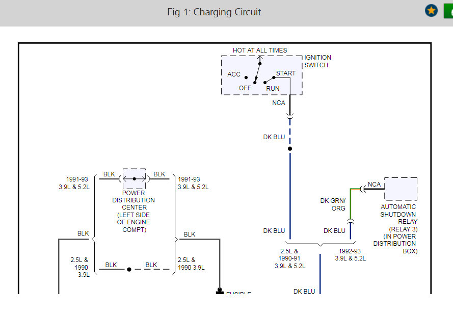

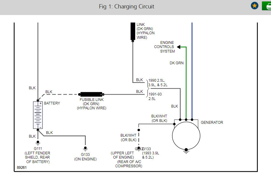

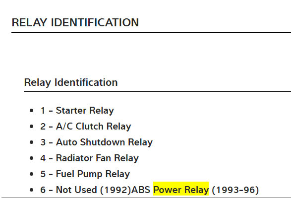

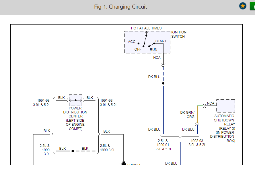

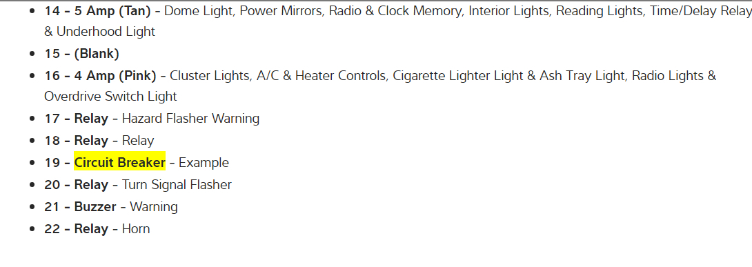

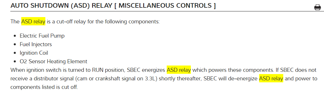

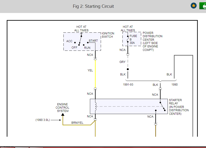

This could be a problem with your vehicle's Auto Shut Down Relay (ASD) relay which is located in your vehicle's fuse panel under the left hand side of the dash. In the diagrams down below I have included a description of the ASD relay, it's location, wiring diagrams of your vehicle's charging and starting circuits, and a diagram with callout for the fuse panel. Please go through this guide and get back to us with what you are able to find out.

I replaced the ASD relay and still nada. I did buy a test light and there is no power going to the ASD relay. I looked at the schematics to figure what the next step is. What does it sound like the issue is if there is no power to the wire harness that goes into the ASD relay? Thank you for all your help.

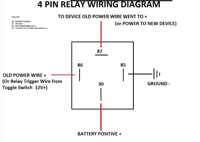

Hello again,

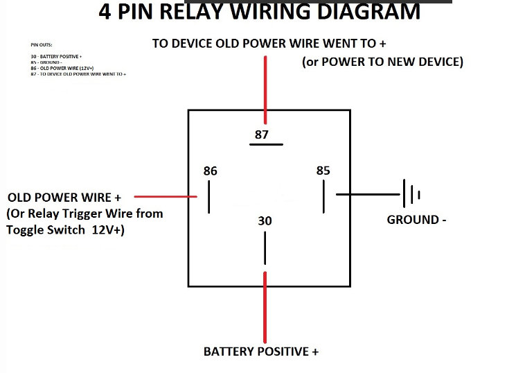

In the diagrams down below I have included a diagram of a typical 4 pin relay. When the relay is active there should be battery voltage at pins 86 and 30 and 87. There should be trace voltage at pin 85 0.10 volts or around there. Could you take a voltage reading at each of the four pins and get back to us with what you get, please.
Thanks,
Alex

Zero voltage on all. Nothing clicks or does anything when I turn the key. I’m now thinking it’s the ignition switch.

You hit the nail right on the head. The electrical current that energizes the coil on the control side of the relay and goes into pin #86 comes from the ignition switch when the switch is turned to "start". Replace the ignition switch and get back to us with how everything turns out. If you need instructions on how to do this let us know and we will get those to you.

Traced wires from asd harness towards the battery. I found a corroded and broke wire. Spiced it and it fired right up. Thank you so much for all the help.
