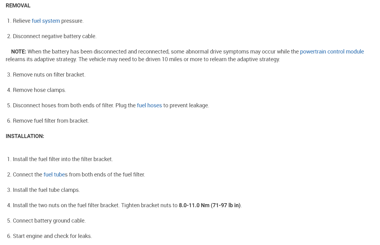

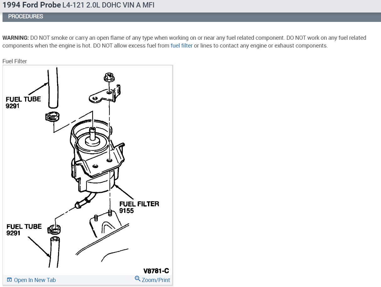

My car has never started as quickly as i would like but it has gotten worse lately. The 'check engine light" has started to go on (now) with key-on position. If I turn it to 'start', the engine turns over for quite a long time, until the light goes off-then starts right up. Can't figure out if it is fuel or electric. Thankfully, I have a new battery, but don't want the starter to overwork as it is now. Any thoughts.
One other thing. On my heater/AC system, 'air' only comes out of the 'defrost' outlets!! What's up with that?
Jul 12, 2023 at 4:37 AM
  • 55,118 POSTS
I would start by changing out the fuel filter and then checking for a vacuum leak and also service the throttle body. Here are guides to help us fix the problem with instructions for your car in the images below:

Check out the images (below). Please let us know how it goes
