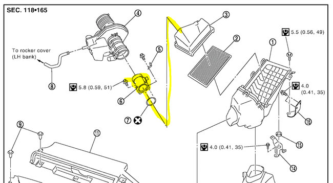

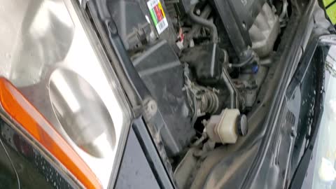

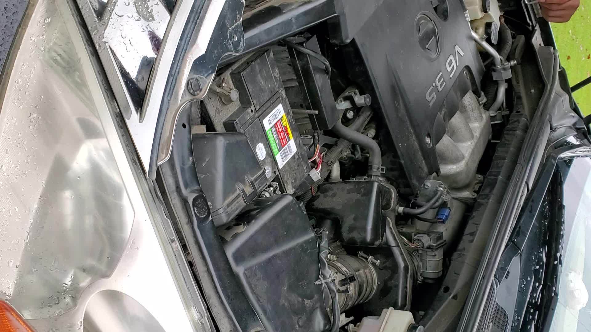

Okay, the scan tool will need to be able to read the CAN. Tell me, does your scanner have live data? I'm asking because after listening to it and the idea that it always starts right back up leads me to think it could be related to the mass airflow sensor (MAF).
The sensor is in the air intake tube between the air filter box and the throttle body. See the pic below. Do me a favor. Disconnect it and see if it makes a difference. By disconnecting it, the computer will go into a mode that is set by the factor to keep the car running.
Let me know what happens.
See pic below.
Sep 18, 2021 at 1:12 PM

I scanned my car today and the only code that came up was P0051 which I already know since the cat was cut off so I'm not sure what it could be. I think it has live data on it but the car won't stay running long enough for me to be able to read it. It will read when it's off but I don't know the values are if they are normal or whatnot. I checked all the connections and everything that is the MAF but nothing is loose, disconnected or messed up so... I am hoping that if I can get a piece of flex pipe and/or eventually get a new cat that it will create back pressure enough to start the car but right now, the scanner isn't giving me any information. I made sure it could read the CAN before I purchased. I will disconnect it when I get home from work this afternoon and see if it makes a difference. Thank you!
Sep 19, 2021 at 9:36 PM
BRITTANYMARIE_1992
  • 8 POSTS
It will start without the sensor connected but it won't start with it connected. That means I should get a new sensor, right?

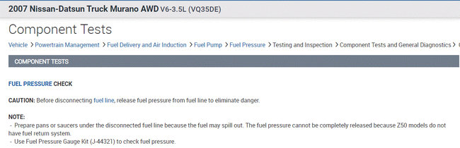

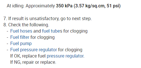

Have you confirmed the fuel pressure is within spec since the pump was replaced? Here is a link showing how that is done:

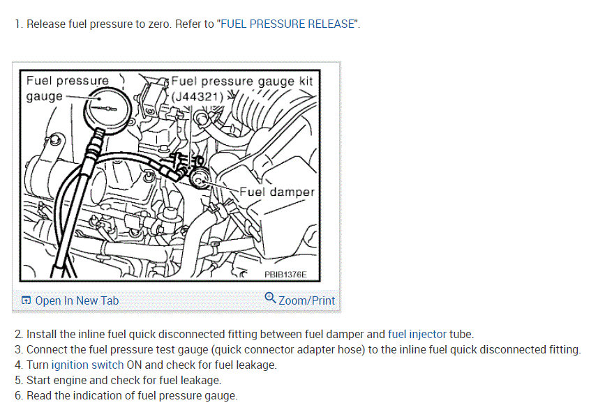

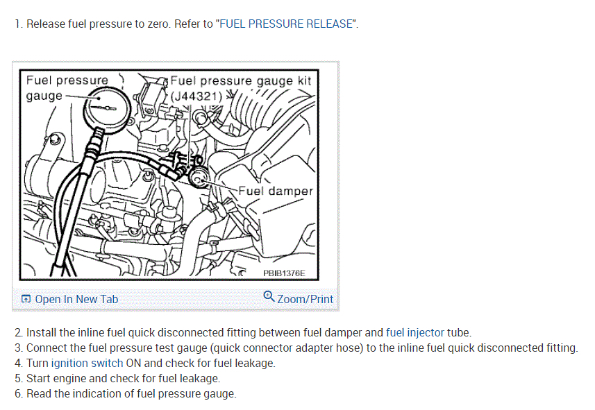

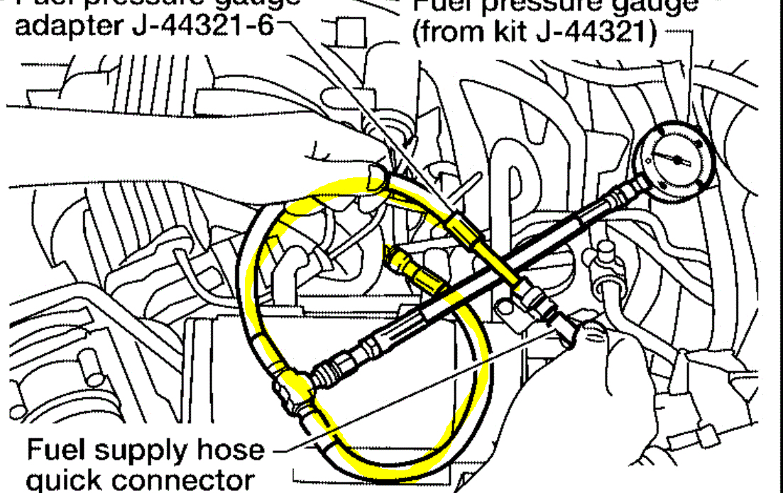

I have not had a chance to check the fuel pressure because I have no idea where I would put the fuel pressure gauge. I do not have a Schrader valve on my car so I'm not 100% sure where on my car I would put the end of the gauge to be read. I have tried looking online, in videos but none show my specific car and how to check it.
Sep 20, 2021 at 11:52 AM
  • 110,244 POSTS
There is a special tool (hose) that connects between the pressure damper and the fuel injector rail.
If you look at the pic below, I attached what the tool looks like. It is part or a fuel pressure gauge kit (J-44321). (see pic 1)

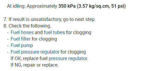

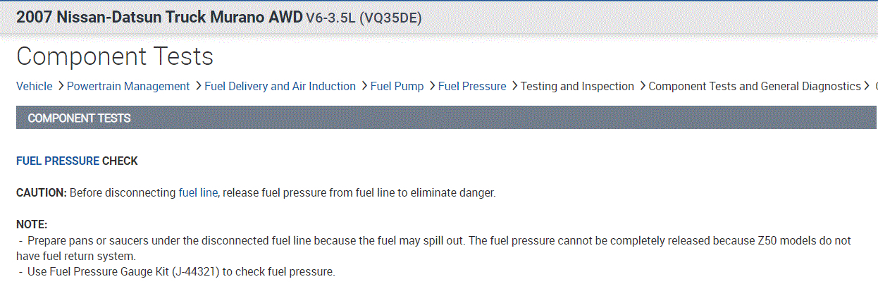

The remaining pics are the directions for testing.
Sep 20, 2021 at 12:58 PM

Thank you so so much! For all your help! Disconnecting the sensor for the MAF made it actually stay on and I am so darn happy it's running again! You are a genius! I am so grateful for your help and for you taking time to help me when you don't have to! It actually is running but I am going to check the fuel pressure tomorrow after I get home from work to make sure everything is good with it. I am in the process of getting a new sensor and replacing the cats so it doesn't sound like a race car. Lol. But thank you use much for helping me with this problem. Other then the that, it is running! I'm not ready to take it out on the road just yet but I wouldn't even have it running if it wasn't for you.
Sep 20, 2021 at 1:14 PM
  • 110,244 POSTS
You are very welcome, but you don't need to thank me. You did it, not me. Good job.
Chances are the sensor is bad and that is what caused the issues originally. When you disconnected it, the car's computer went into a predetermined setting to allow the vehicle to run in the event the sensor failed.
