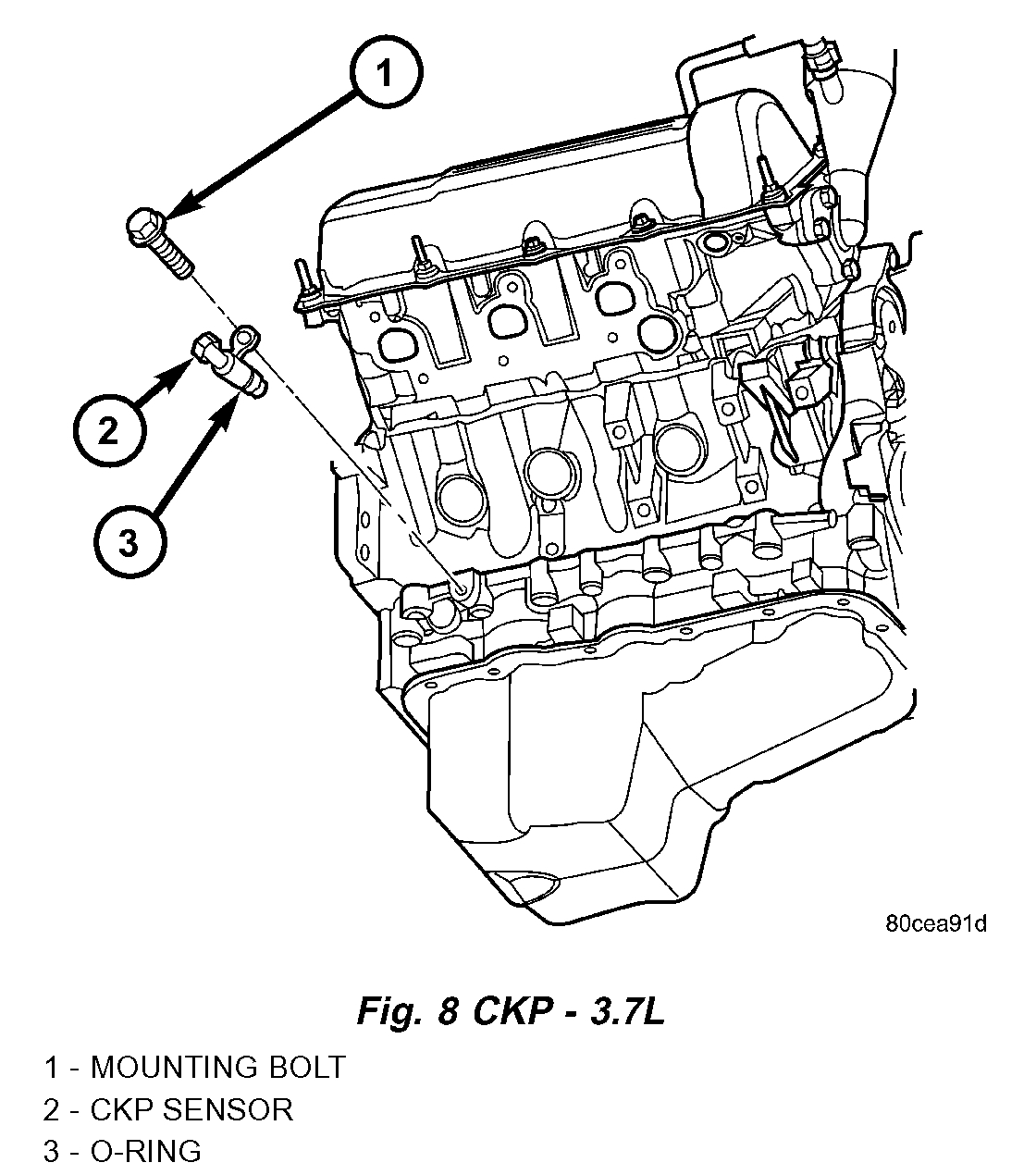

It sounds like a bad crankshaft position sensor. When they get hot, they can fail. Take a look at these links:
https://www.2carpros.com/articles/how-a-crank-shaft-angle-sensor-works
If you feel these links mirror what you are experiencing, here is a link that shows how one is replaced:
Here are the directions specific to your vehicle:
__________________________________________
2003 Jeep Truck Liberty 2WD V6-3.7L VIN K
Procedures
Vehicle Powertrain Management Sensors and Switches - Powertrain Management Sensors and Switches - Computers and Control Systems Crankshaft Position Sensor Service and Repair Procedures
PROCEDURES
REMOVAL
Fig.8 CKP - 3.7L
pic 1
The Crankshaft Position (CKP) sensor is mounted into the right rear side of the cylinder block. It is positioned and bolted into a machined hole.
1. Raise vehicle.
2. Disconnect sensor electrical connector.
3. Remove sensor mounting bolt.
4. Carefully remove sensor from cylinder block in a rocking and twisting action.
5. Check condition of sensor O-ring.
INSTALLATION
1. Clean out machined hole in engine block.
2. Apply a small amount of engine oil to sensor O-ring.
3. Install sensor into engine block with a slight rocking and twisting action.
CAUTION: Before tightening sensor mounting bolt, be sure sensor is completely flush to cylinder block. If sensor is not flush, damage to sensor mounting tang may result.
4. Install mounting bolt and tighten to 28 Nm (21 ft. lbs.) torque.
5. Connect electrical connector to sensor.
6. Lower vehicle.

How important is the torque for this sensor bolt? I'm having one heck of a time getting a torque wrench up in there.
Sep 29, 2019 at 12:14 PM
  • 110,194 POSTS
Welcome back:
Sorry for the delay. I had to make an unexpected trip this weekend.
Just make sure it is tight. If it isn't exactly 21 ft/lbs don't worry.
Sep 29, 2019 at 4:59 PM
ANGIE POWELL
  • 8 POSTS
Thank you! It's all good, I so appreciate your help! It was the crankshaft position sensor! Got it changed yesturday and not even a slight hesitation since!
