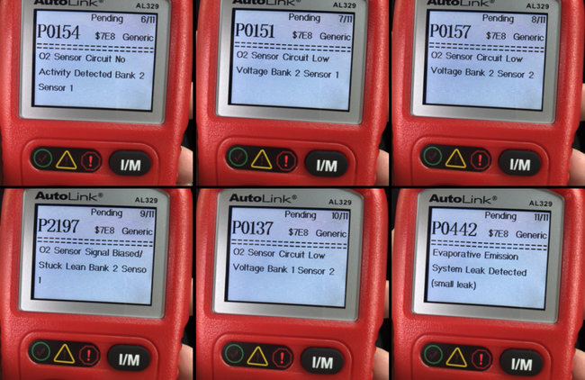

Also, the o2 sensor in bank 2 are new from AutoZone. I also removed bank 1 sensor 2 to let air flow to see if it’s the catalytic converter. It doesn’t appear to be.
May 17, 2020 at 4:41 AM
  • 110,244 POSTS
Since the codes indicate lean or low voltage from the sensors, have you checked to make sure the fuel pressure is within the manufacturer's specs?

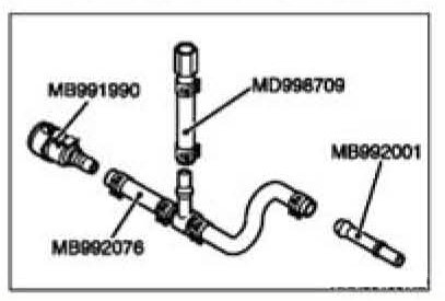

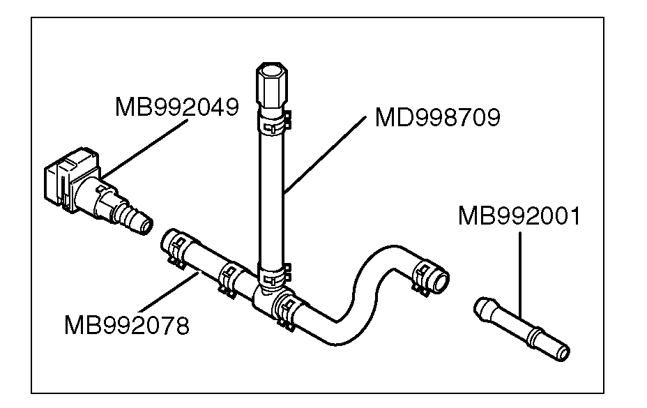

3. Assemble the special tool MD998707 of special tool as shown in figure.
NOTE: The special tool MB992076 (injector test set) is compatible with the special tool MB998706 (injector test set).
In case of vehicle using (square) quick connector
W/ Square Quick Connector
pic 2
(1) Remove the injector installation adapter from the hose. Remove another hose together with the adapter and remove the adapter from the remaining hose.
(2) Install the special tool MB992049 (quick connector) and the special tool MB992001 (hose adapter) to the hose without the adapter.
(3) Remove the nipple of the bolt of the special tool MD998709 (hose adapter).
(4) Install the special tool prepared in the procedure (3) to the nipple that was removed together with hose in the procedure (1).

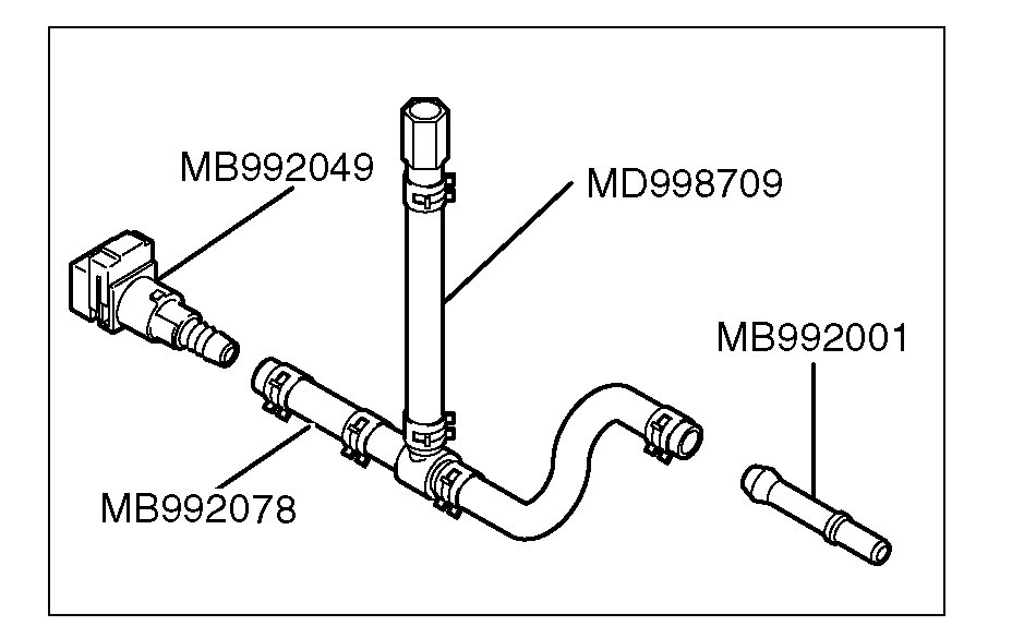

In case of vehicle using (round) quick connector
W/ Round Quick Connector
pic 3
(2) Install the special tool MB991990 (quick connector) and the special tool MB992001 (hose adapter) to the hose without the adapter.

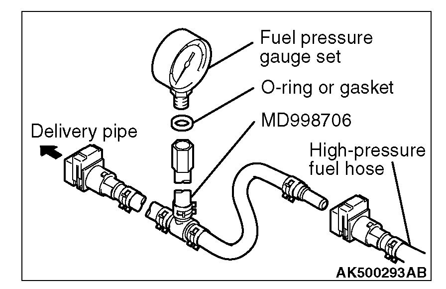

4. Install the special tool assembled in step 3 between the fuel rail and the fuel high-pressure hose.
[When using the fuel pressure gauge]
pic 4
1. Via a suitable O-ring or gasket, install the fuel pressure gauge to the special tool that has already assembled as described.
2. Install the assembled fuel pressure measurement tools between the fuel rail and fuel high-pressure hose.

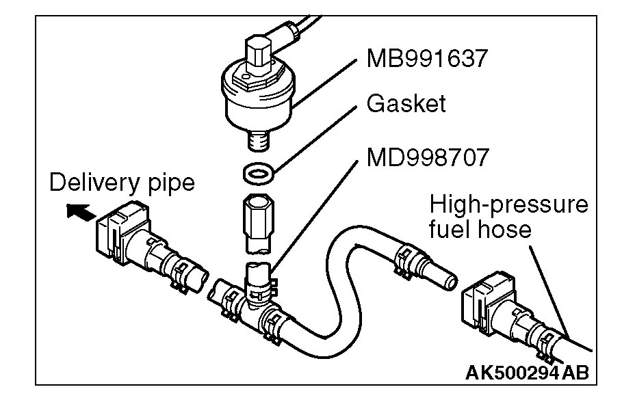

pic 5
1. Via a gasket, install the special tool MB991637 (fuel pressure gauge set) into the special tool that has already assembled as described.

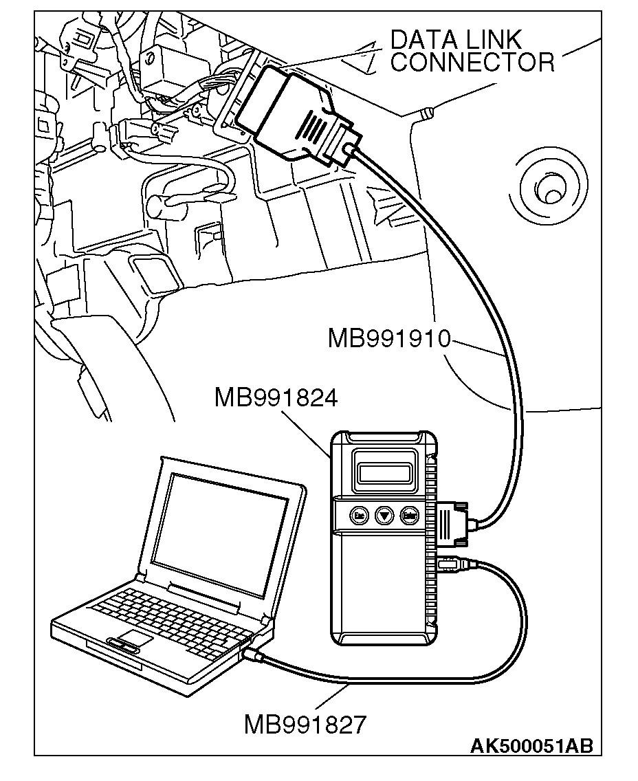

CAUTION: To prevent damage to scan tool MB991958, always turn the ignition switch to the "LOCK" (OFF) position before connecting or disconnecting scan tool MB991958.
pic 6
7. Connect scan tool MB991958 to the data link connector.
8. Use Actuator test 9 to drive the fuel pump. Check that there is no fuel leaking from any section when the fuel pump is operating.

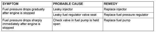

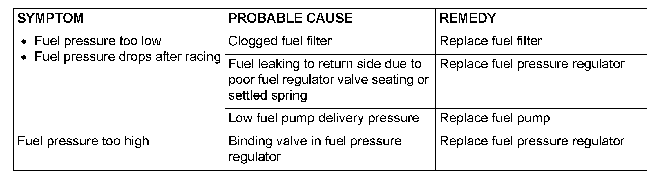

13. If any of fuel pressure measured in steps 11 to 12 is out of specification, troubleshoot and repair according to the table below.
pic 7

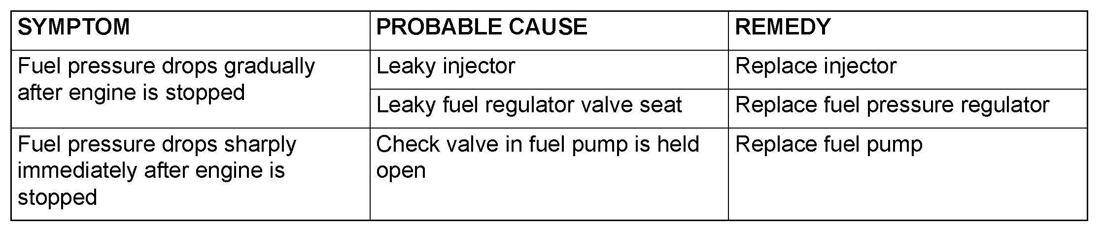

14. Stop the engine and observe fuel pressure gauge reading. It is normal if the reading does not drop within two minutes. If it does, observe the rate of drop and troubleshoot and repair according to the table below. Start, then stop the engine.
1. Squeeze the fuel supply line closed to confirm leak-down occurs from defective fuel pump check valve.
2. If pressure continues to drop with both fuel lines squeezed closed, injector(s) are leaking.
pic 8

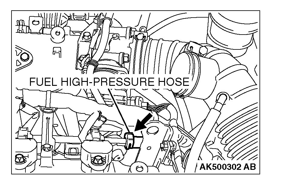

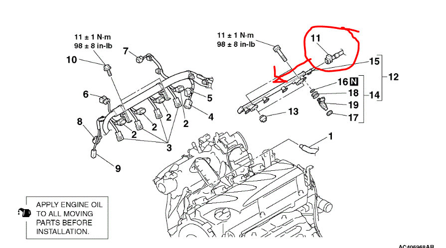

I can’t seem to safely assume which hose is the correct fuel hose valve to test. The 2006 Eclipse GS seems to have little exact information online. Can you circle it on a picture of someone’s GS bay? It also appears I’ll need to buy a gauge since it’s for fuel.
May 18, 2020 at 4:52 PM
  • 110,244 POSTS
The high pressure hose will be at the end of the fuel rail. I attached a picture. Let me know if it helps.
May 19, 2020 at 2:24 PM
