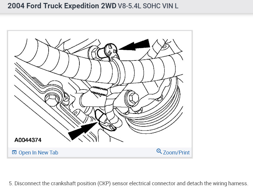

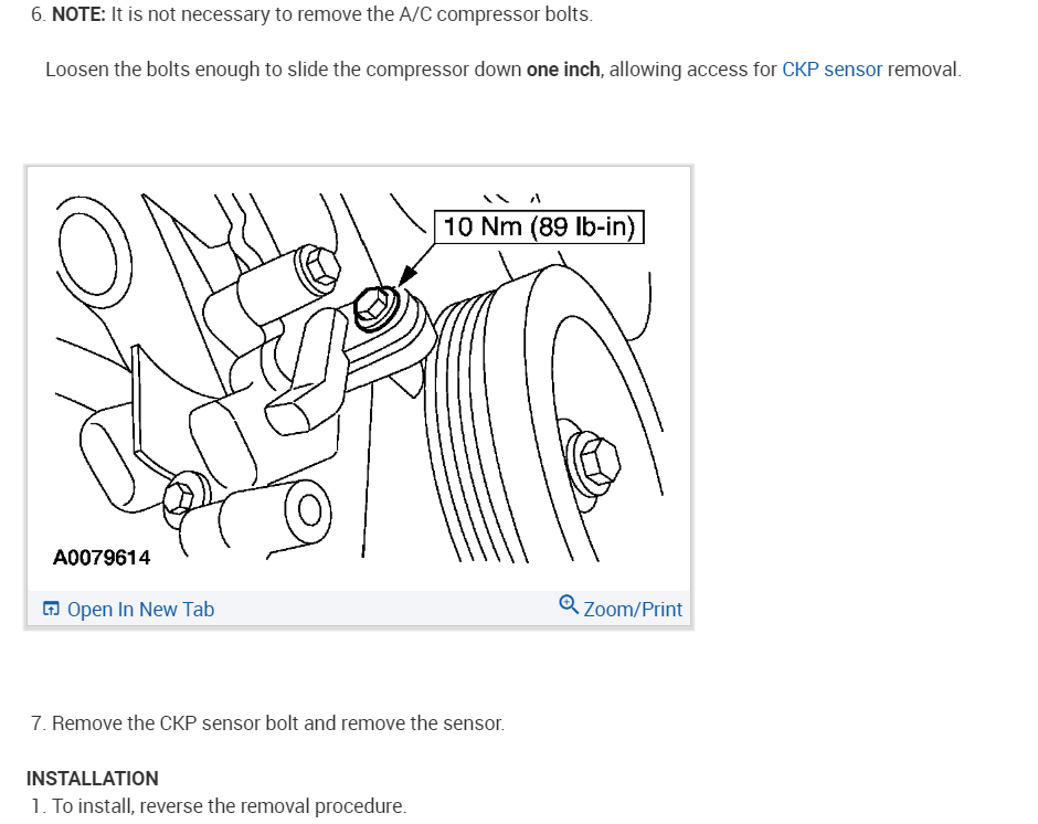

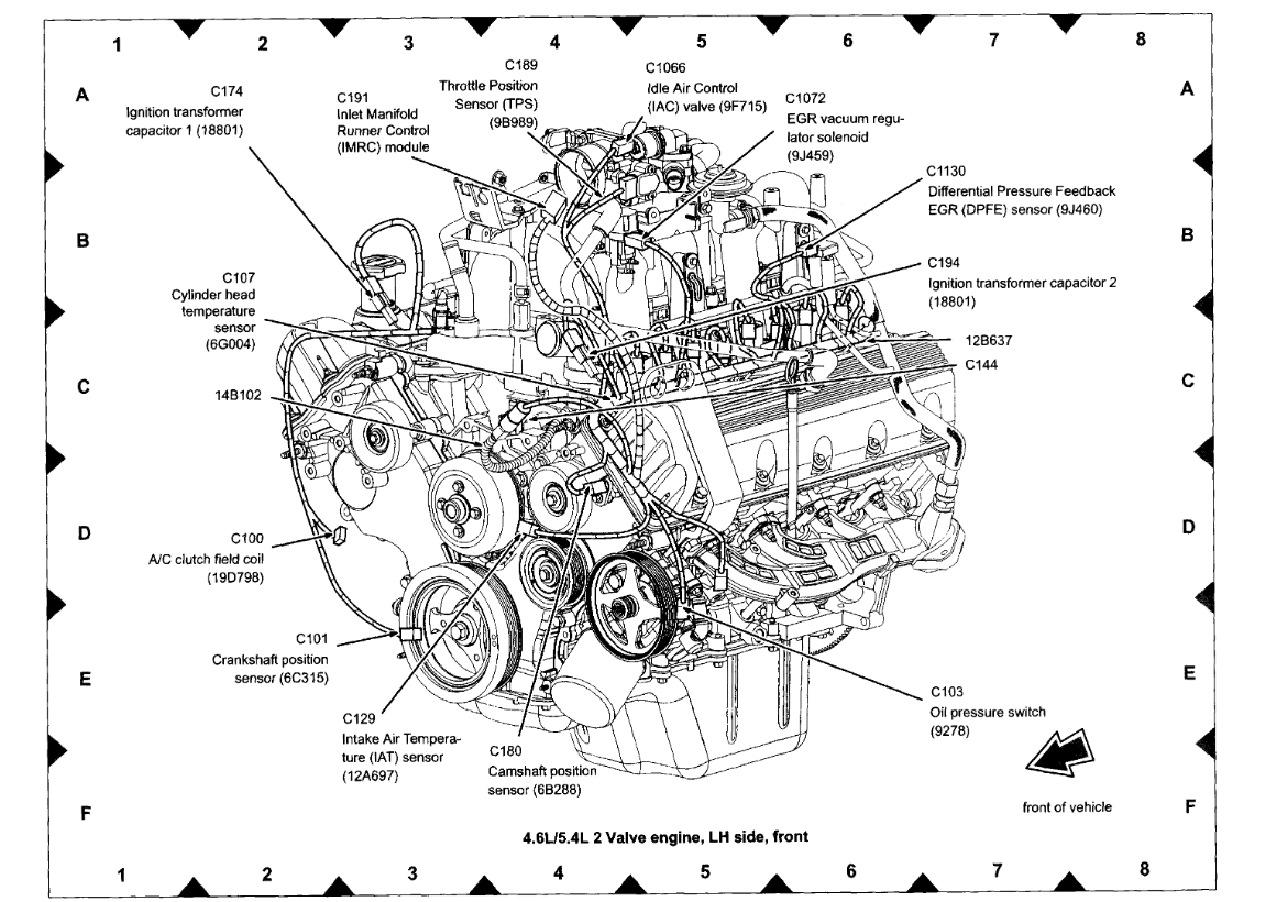

My SUV Eddie Bauer Edition will stall at anytime fast or slow. The only code that it shows is "too lean bank 1". It has been to several mechanics with several diagnostics done and no solutions. We cleaned the MAF sensor, seemed to fix the problem for about three months then started stalling again. The engine just shuts off and will restart almost immediately. Longest it took was about a minute to restart. Replaced the MAF sensor worked for another three months and just started stalling again. The only other symptom is a slightly rough idle when just under 1,000 rpm and then corrects itself. It also just started making a humming/whining noise when on and gets worse with acceleration or deceleration. Could be unrelated not sure. Any ideas would be appreciated. We are stumped!

It has been inspected for vacuum leaks. A minor leak was found and I was assured it was not big enough to cause any problems. Is the PCV system where the crank shaft angle sensor is? That is one of the things that is getting checked on thanks to another post I saw here.

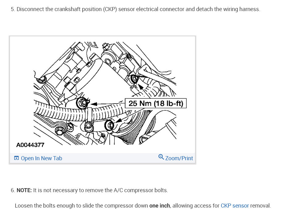

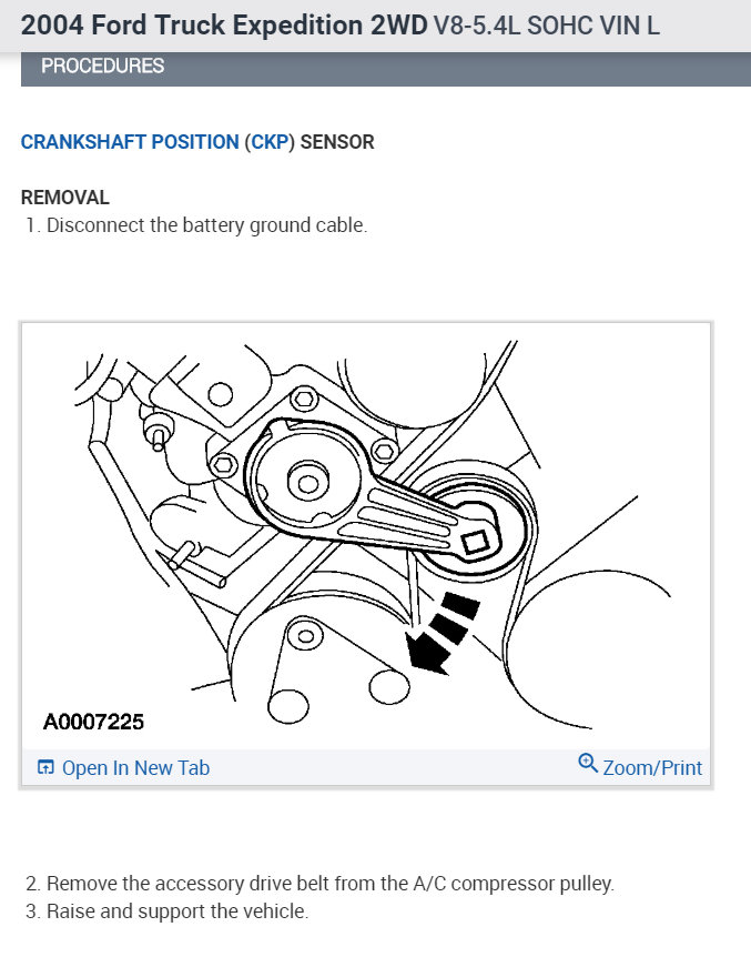

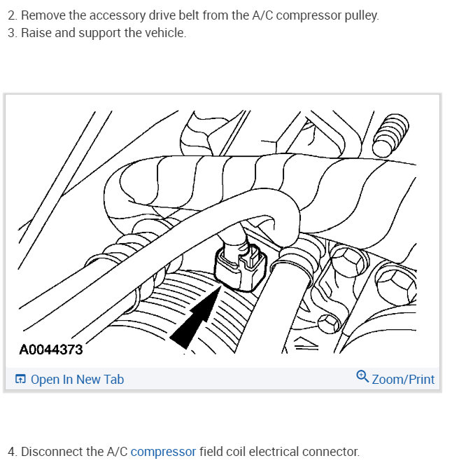

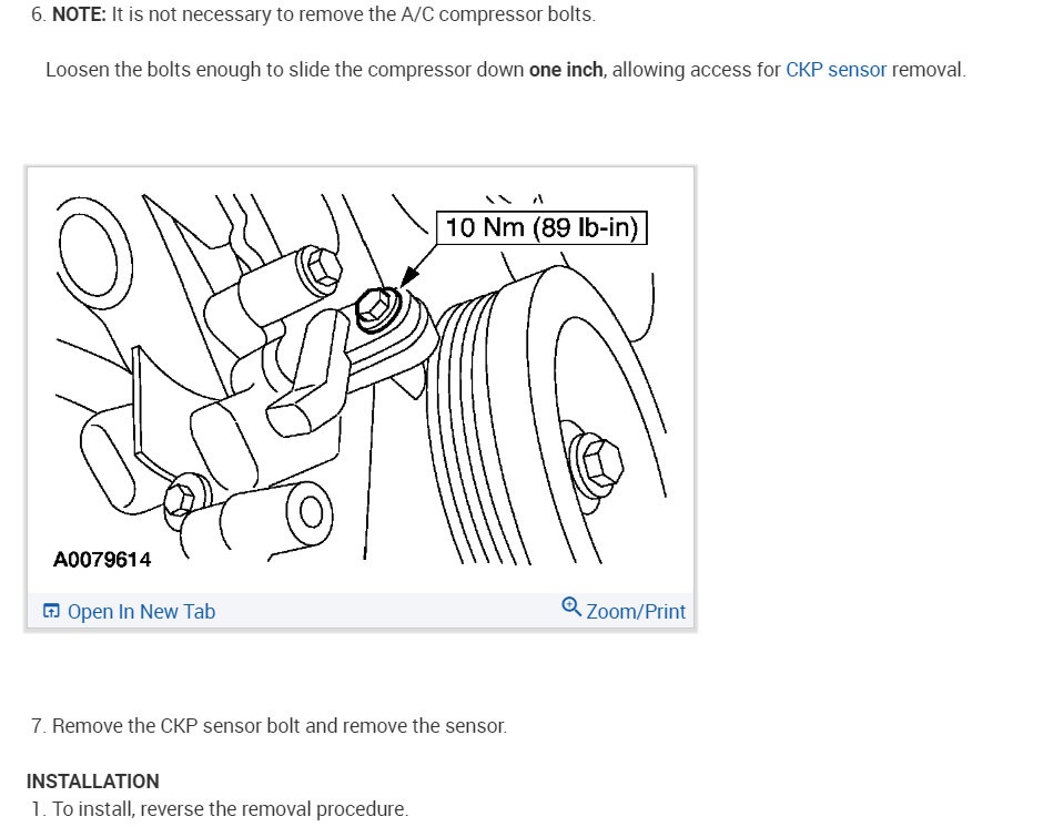

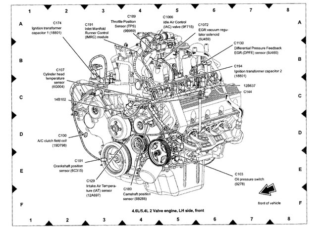

Yep, the crankshaft sensor is what I would replace, it gives you a clue at slow speeds partial failing and then catching itself. Here is a guide that will walk you through the repairs and diagrams below to show you how on your car.
