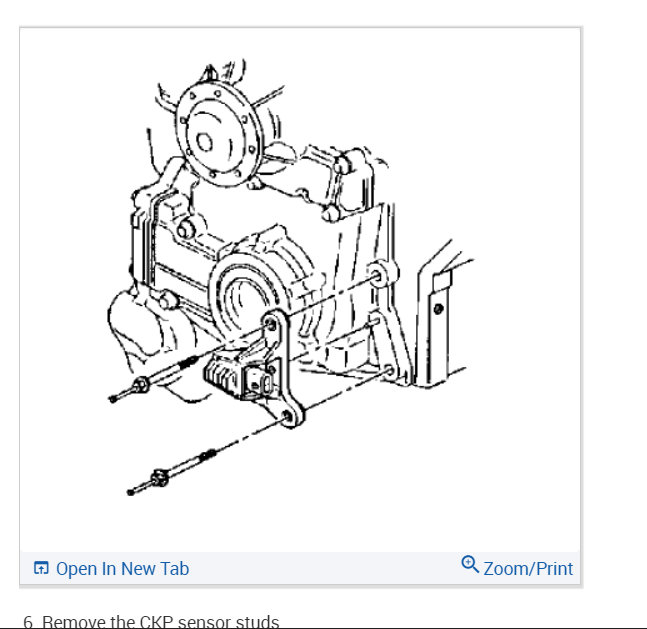

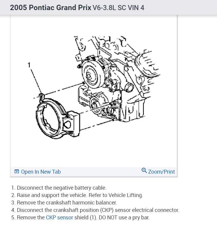

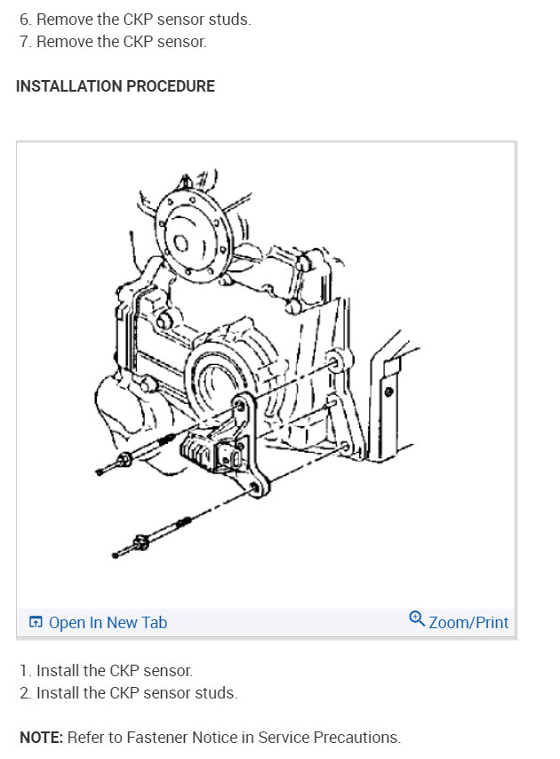

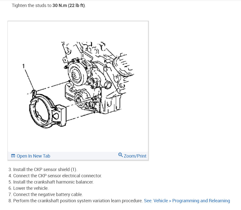

It still can be the fuel pump but can I ask if the check engine light is on? I have seen the crankshaft angle sensor cause this issue as well. If it is a bad crankshaft sensor it will not show a trouble code or trigger a check engine light. Here is a guide to help us see what's going on with how to change out the crankshaft sensor in the diagrams below.

Also we should check the fuel pump pressure this guide can show you how.
Check out the diagrams (Below). Let us know what happens and please upload pictures or videos of the problem.
