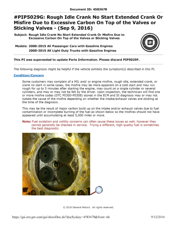

In your first post, you identified throttle. Did you replace the entire throttle body? Also, I did some research and the only thing I can find related to an idle issue and no start is a carbon issue that was indicated in a technical service bulletin. Take a look at the pic attached.
