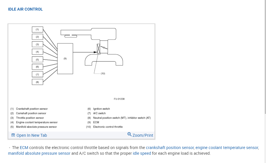

I have the vehicle listed above that i just picked up. I was told the head gaskets were replaced about 6,000 miles ago. if i press the brake down at a light and hold it until the lights green the car will stall.
Jan 22, 2020 at 12:32 AM
Does the engine run poorly at all?

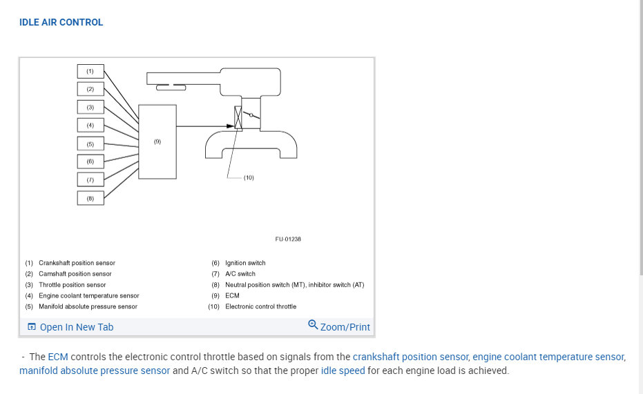

If holding the brakes down causes the engine to stall it is either a vacuum leak or the IAC is failing. It could be other things but we need to start here. I doubt it is related to the head gaskets but we need to check for a vacuum leak as maybe a line came off or is leaking.
Let's start with these things and go from there.
https://www.2carpros.com/articles/idle-air-control-valve-service
