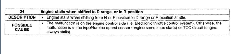

Keeps stalling after putting in gear and taking off. Idles fine.

I can hold the brake and give it gas and seems fine. But as soon as you start to take off it shuts off does it in reverse too just not as much. But yes goes into gear fine and has no check engine light.

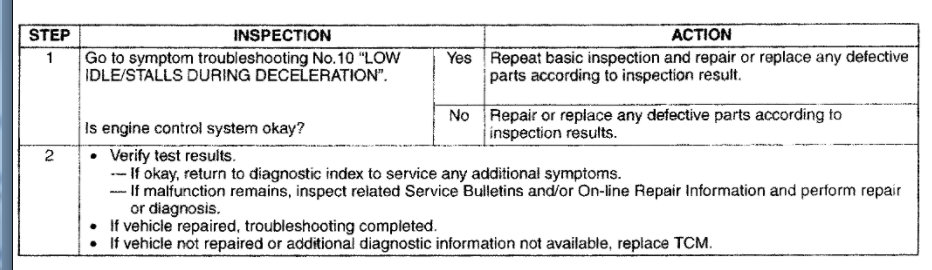

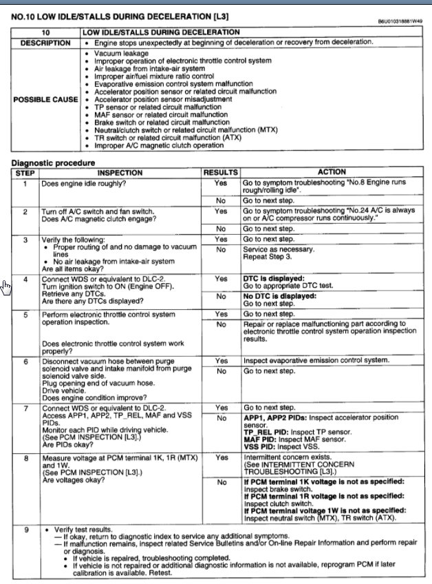

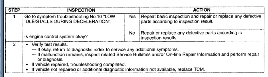

Okay. I suspect this issue is caused by an idle issue in gear. So let's do a couple things. Here are a couple guides that we need to review and start crossing things off the list.
This will get us started on what this issue is:
Then I think we have a vacuum leak as the root cause. So here is a guide that will help us find a vacuum leak:
Lastly I am attaching the process from the manual to figure this out and as you can see the top issue is a vacuum leak so let's start there. If we prove there is no vacuum leak then work through the rest of this list attached below. Thanks
