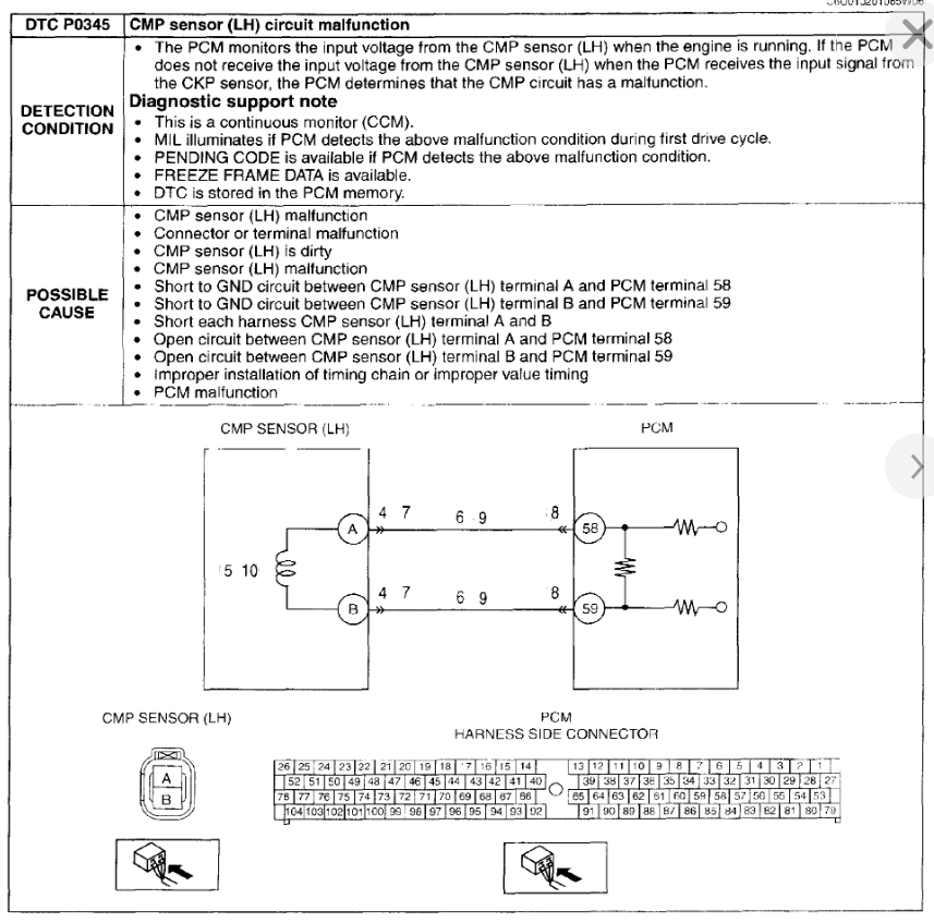

Code P0345, when transmission is shifted into gear the engine shakes then shuts off
2004 MAZDA 6
135,000 MILES • 3.0L • V6 • 2WD • AUTOMATIC
STAN2012
  • 5 POSTS
Car starts and runs fine except when car is put into gear [forward or reverse]. The engine always shakes and then shuts off. I have replaced both camshaft sensors two times already and cleared codes. Code is always P0345 any ideas? This car is in really nice condition so I don't want to get rid of it.
Feb 28, 2020 at 4:02 PM
  • CAR REPAIR CONTRIBUTOR

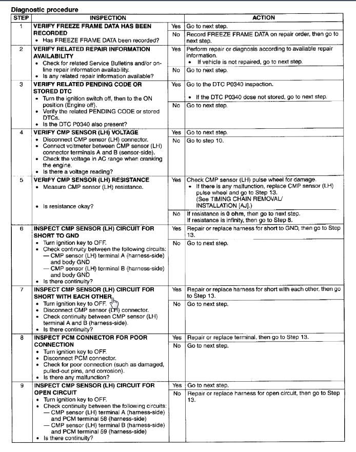

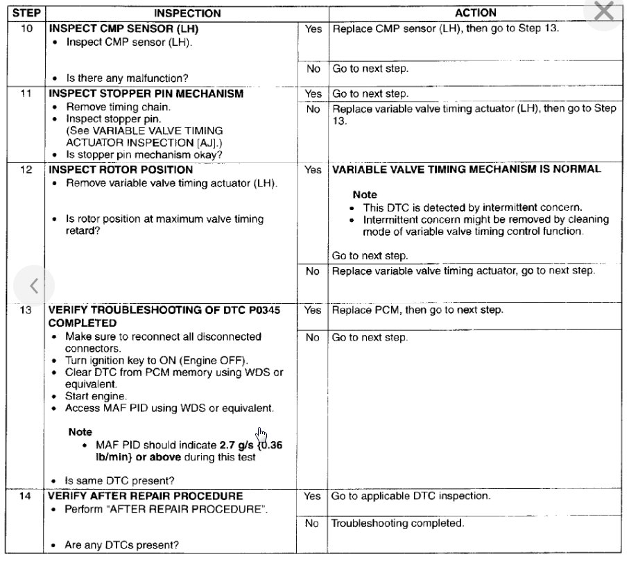

Good thing we have a code but I would think the issue is a wiring issue or some other issue with the circuit.
Here is the testing that we need to do in order to find out what the cause is. Please notice the first page where it gives a list of possible causes so we need to work through this to find out what it is.
Please let me know what questions you have. Thanks.
