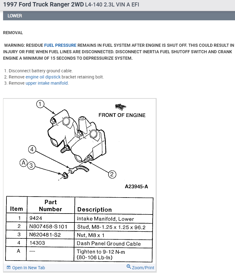

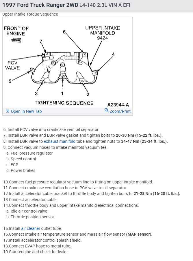

When the outside temperature is 70F or above the truck stalls going down the road or coming to a stop light or turn right or left turns. No codes when I plug in my pocket scanner.

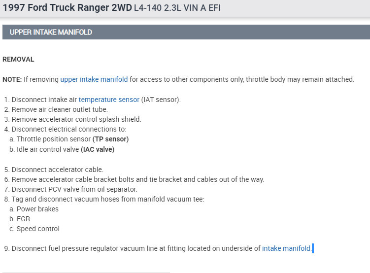

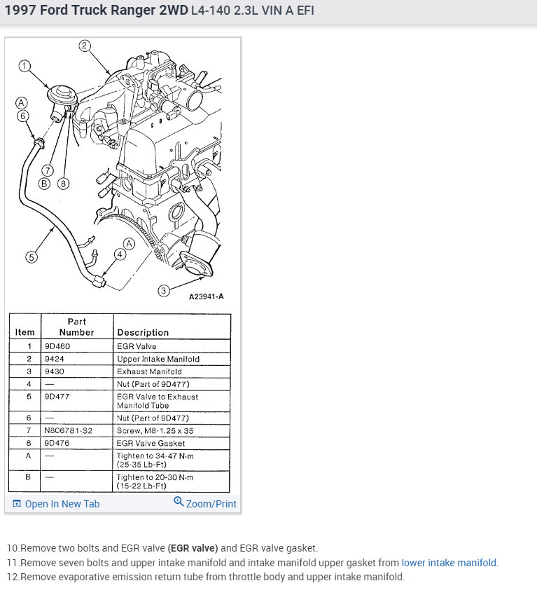

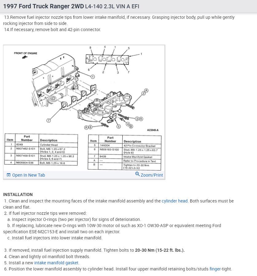

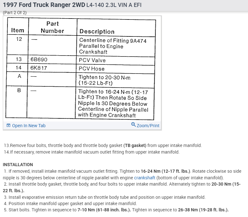

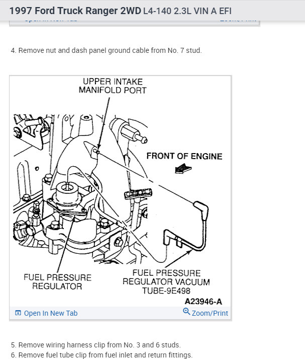

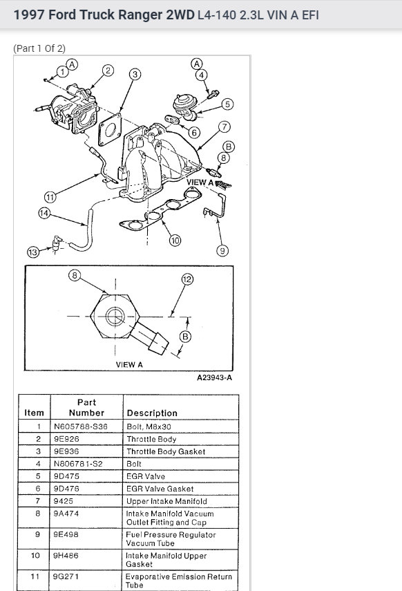

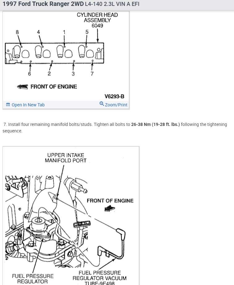

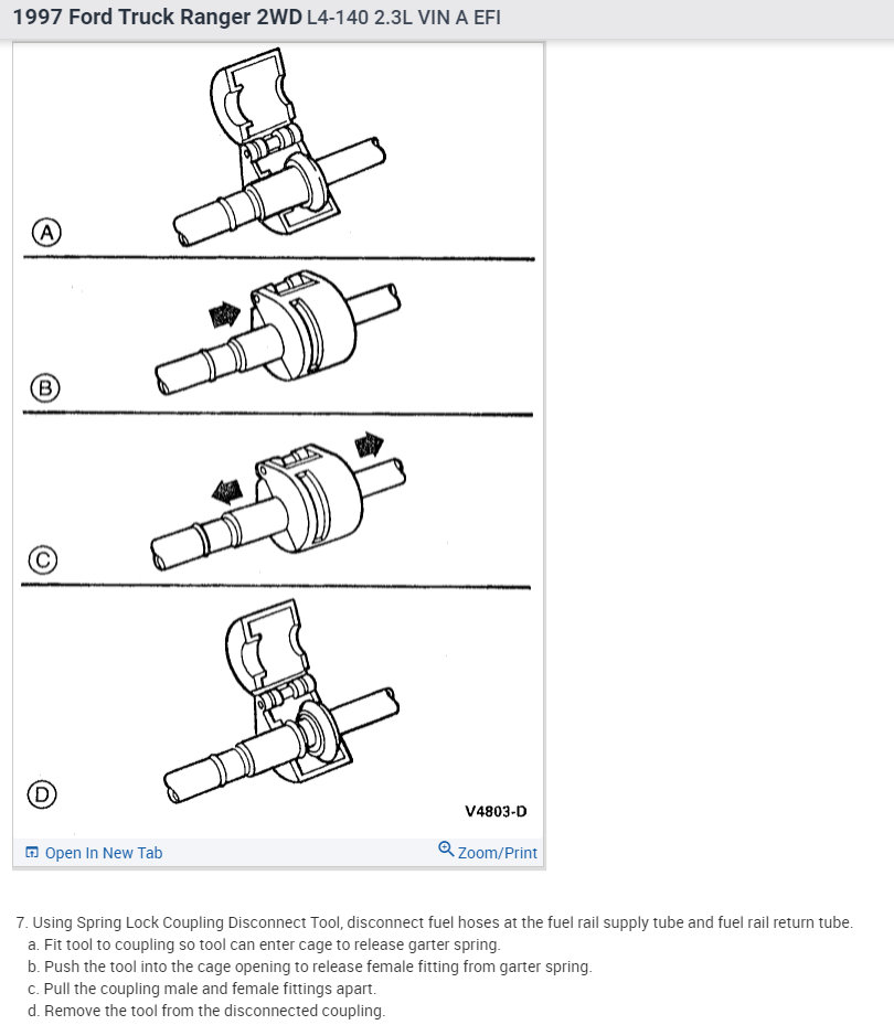

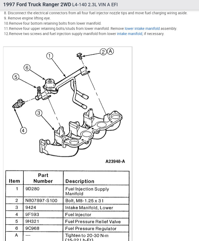

This could be due to a leak in the intake gasket. The leaks on the intake gasket can make the engine run too lean and stall.
So, you might want to check for the leaks in the intake gasket.
One way to check for leak is to spray carb cleaner at the base of the manifold (with the engine at idle), if there is leak the engine will react to the cleaner and the idle will increase. Then it will go down after the chemical is burnt off.
https://www.2carpros.com/articles/replace-intake-manifold-gasket

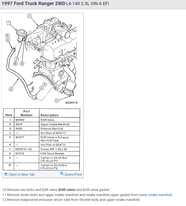

I have attached diagrams below for your reference.

Thanks for that info and diagrams, I tried spraying cleaner with engine running and no reaction. Any other ideas please?
