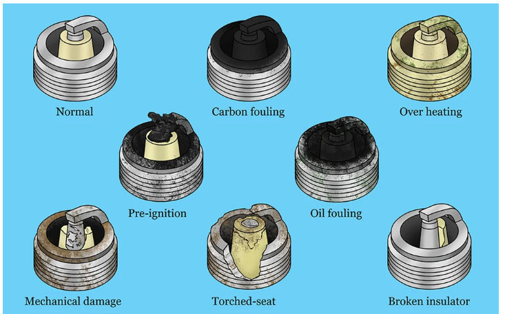

Let's start with checking the fuel pressure when this is happening. I suspect the injectors are leaking which is actually stalling the engine and causing a no start until the fuel evaporates and then it starts.
Also, you pumping the gas pedal will just let more air in so if that is helping with starting the engine then you are evening out the air fuel ratio.
https://www.2carpros.com/articles/engine-stalls
You can try doing a clear flood start and see if that helps as well. This is where you hold the accelerator to the floor and start the vehicle. If it starts then you most likely have an issue here. All this does is cut the injectors when you are cranking the engine so that means you already have fuel in the engine in order to get it to start.
Lastly we need to pull the plugs and see if they are fouled. See below for more detail on what damaged plugs look like.
If you can get some pictures of the plugs as well that would be great.

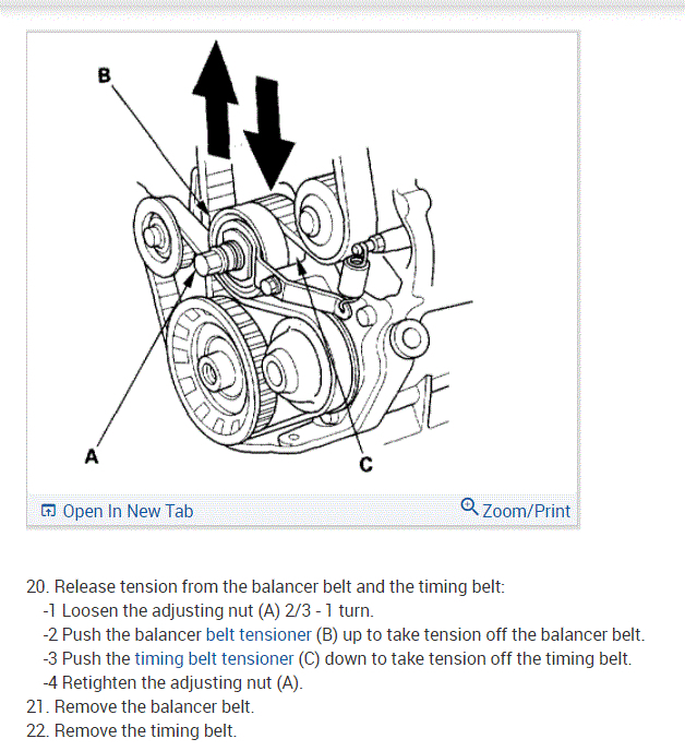

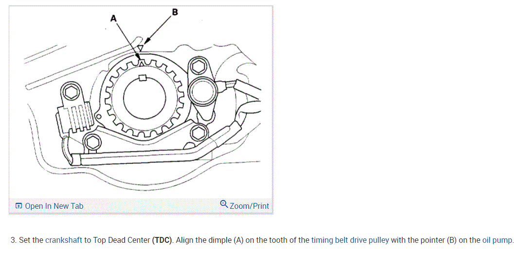

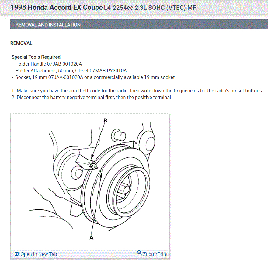

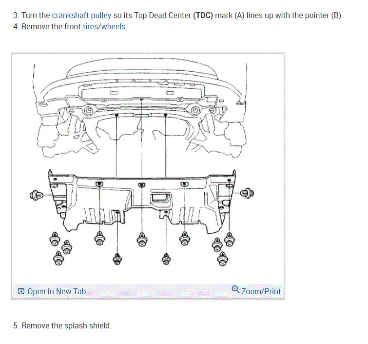

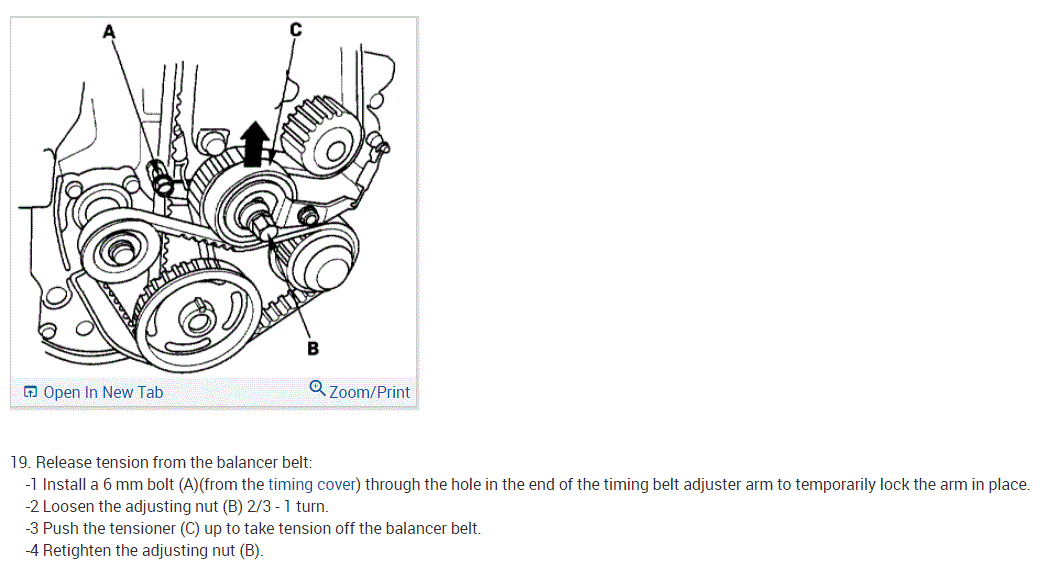

Have you checked the fuel mixture to confirm it is within the manufacturer's specs? Also, when it won't start, have you checked to see if there is spark to the plugs?
When you say it stalls and then won't start for some time passes, it sounds like the crankshaft position sensor may be bad. When they start to fail, heat affects them. Once they cool enough, the vehicle starts again.
Do me a favor. Take a look through this link. It describes the most common symptoms related to a bad crankshaft position sensor. Read through it and let me know if it seems to mirror what you experience.
If the sensor is bad, you will lose spark to the plugs. Also, if you have a live data scan tool, you can check for an RPM signal. No RPM signal usually is related to this sensor.
Here is a link that shows how to check for spark:
The easiest thing to do is see if it starts for a couple of seconds using starting fluid. If it does and then stalls, chances are it is fuel-related. If it doesn't change at all, then it is likely ignition-related.

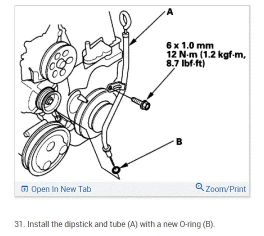

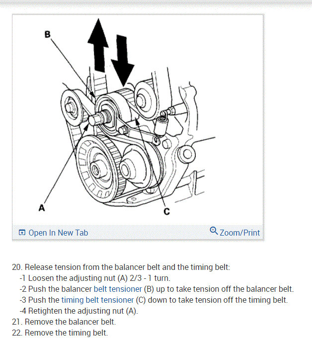

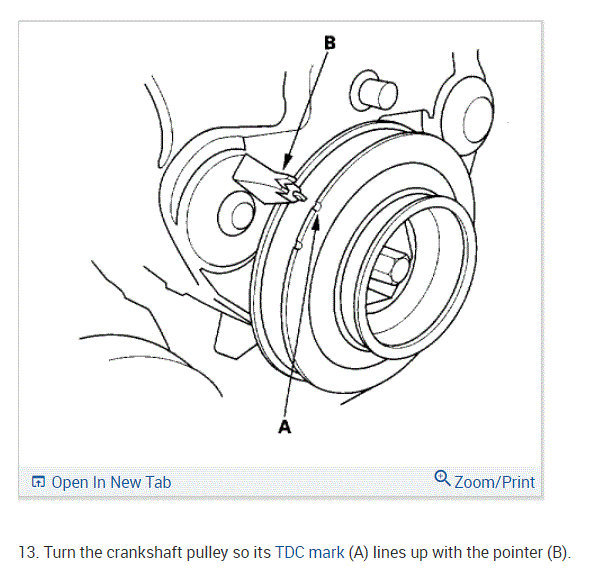

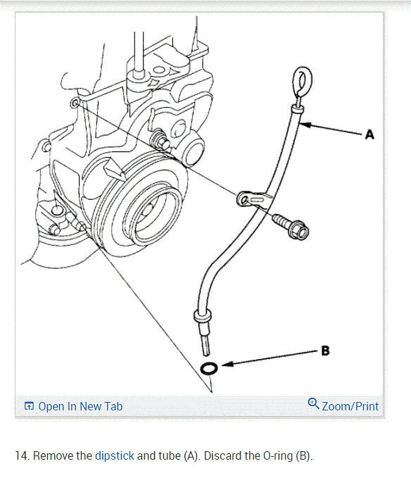

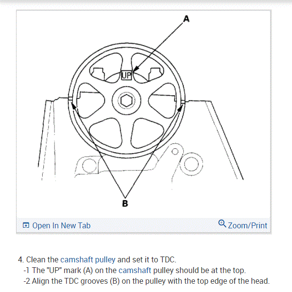

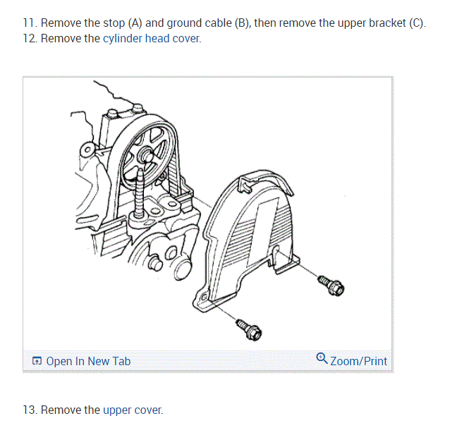

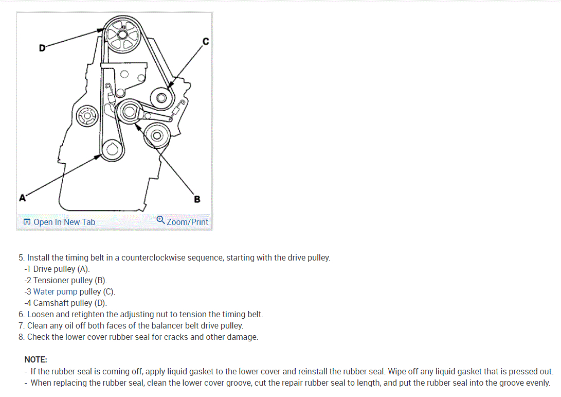

If you determine the sensor is bad, here is a link that shows in general how to replace one:

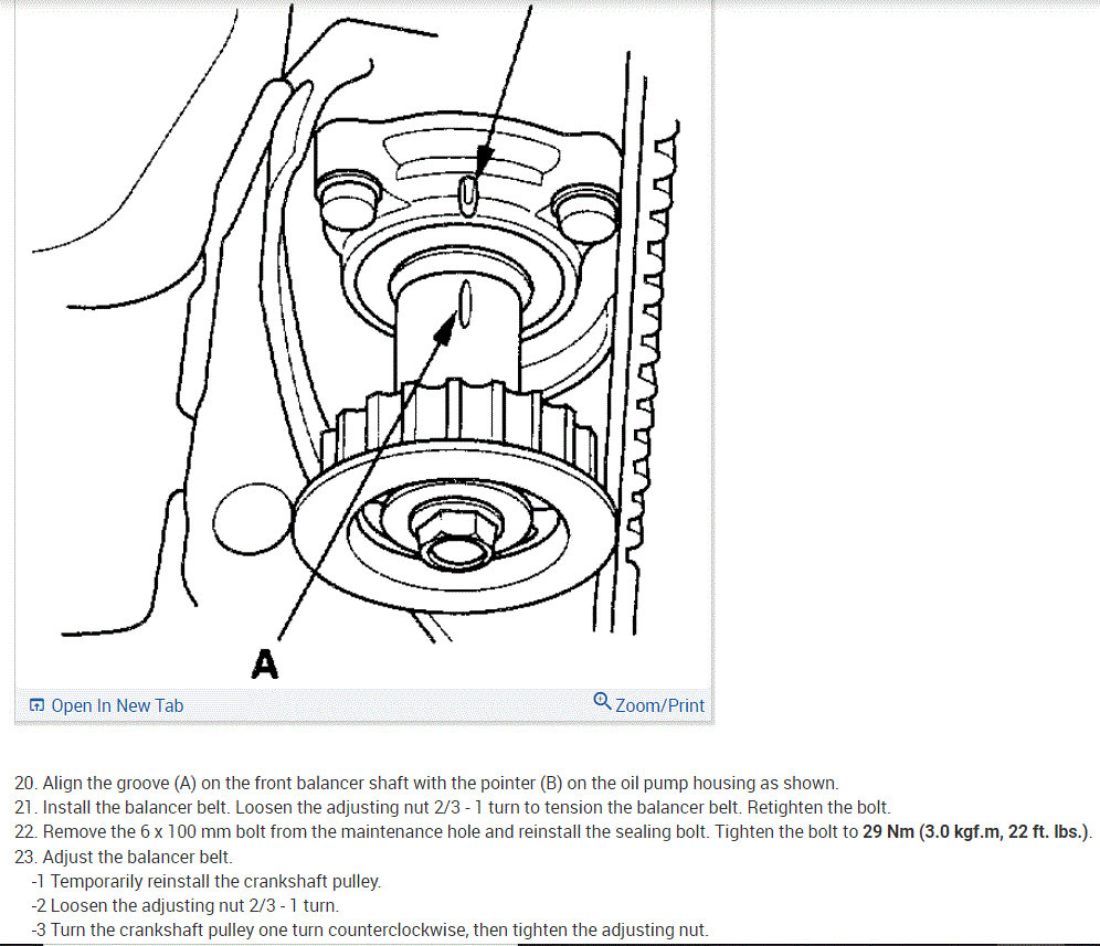

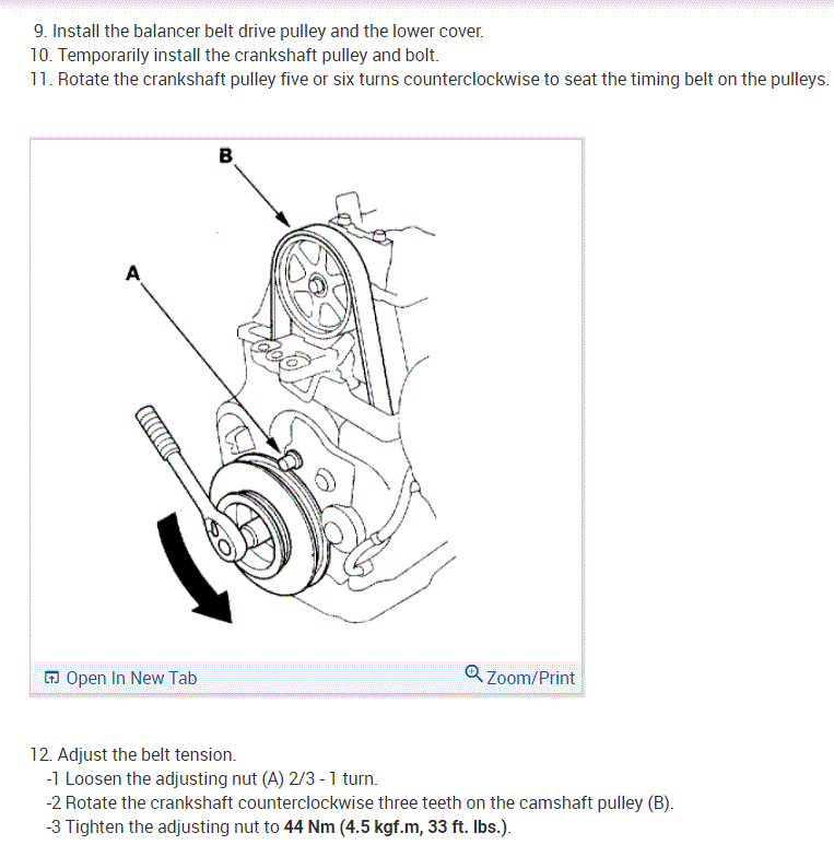

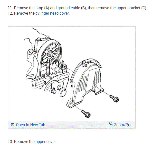

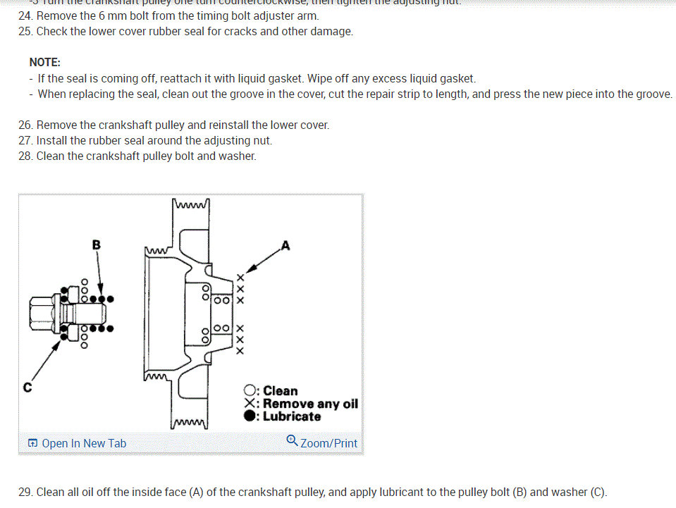

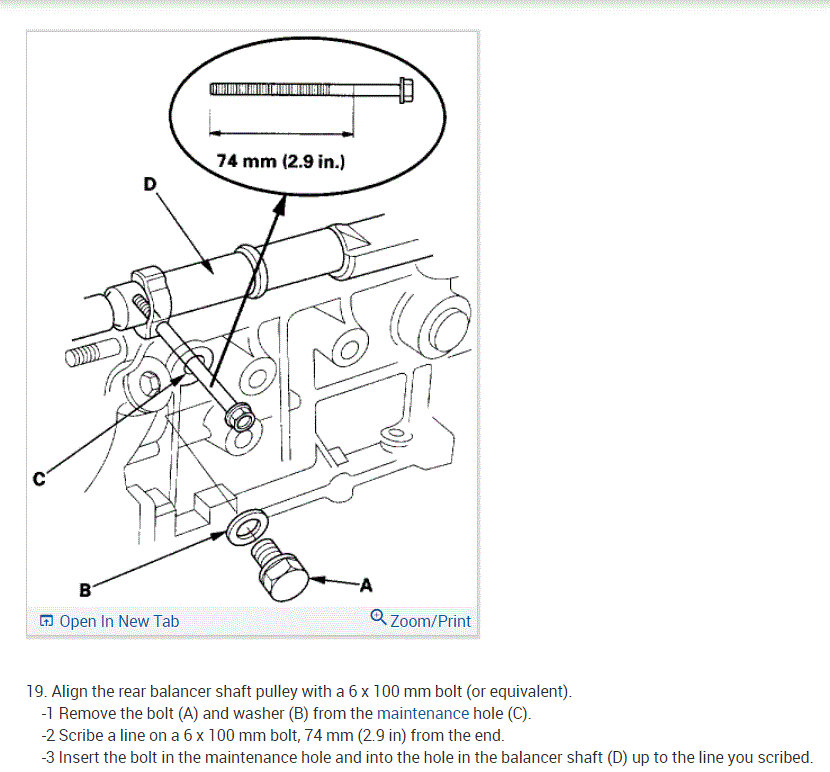

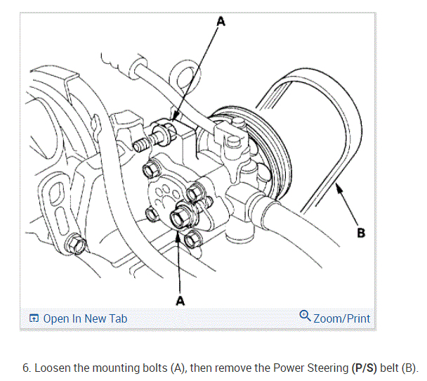

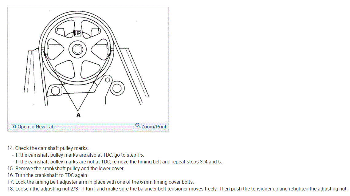

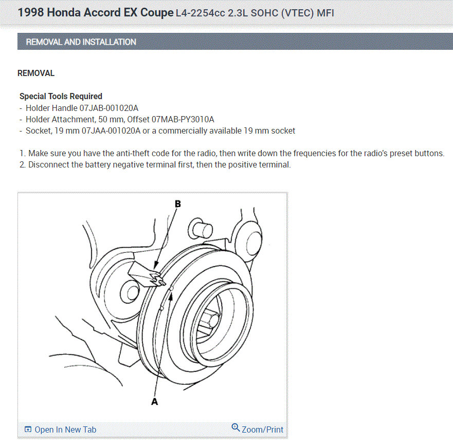

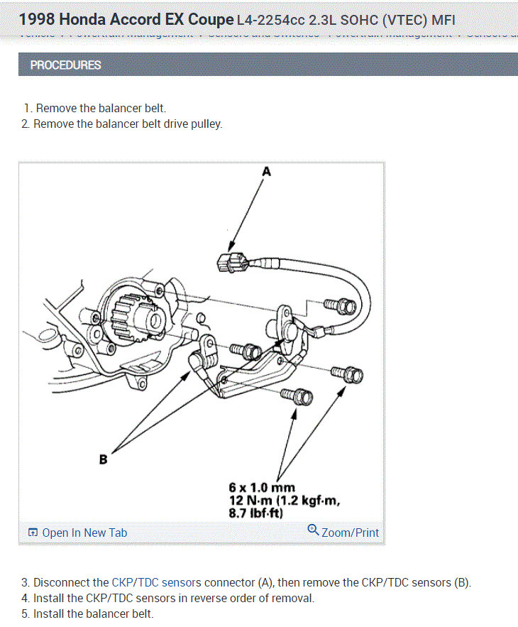

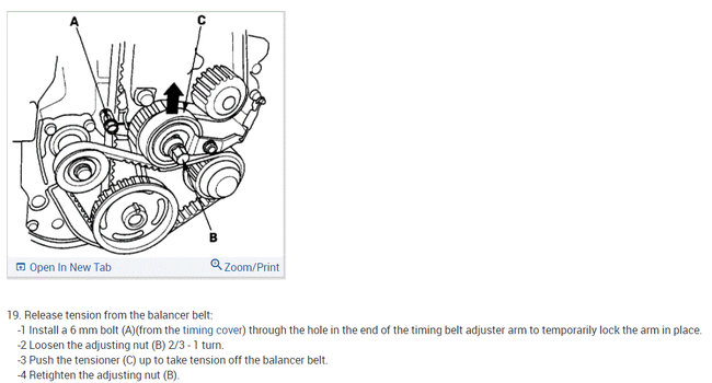

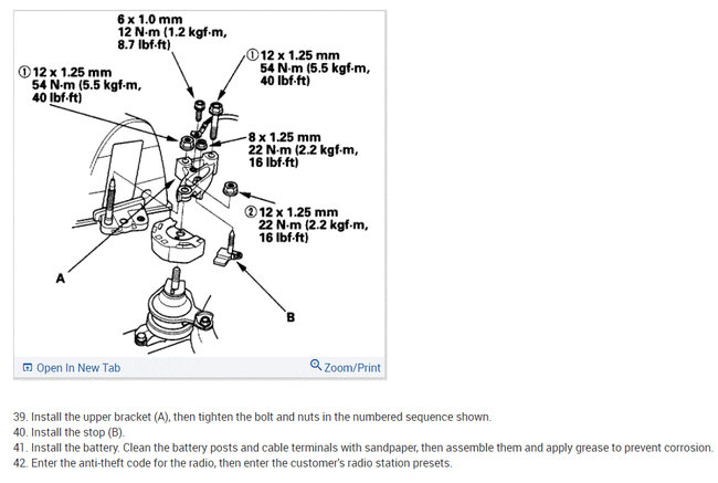

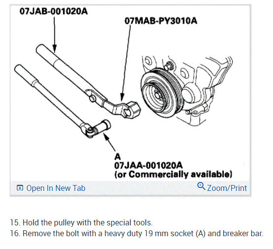

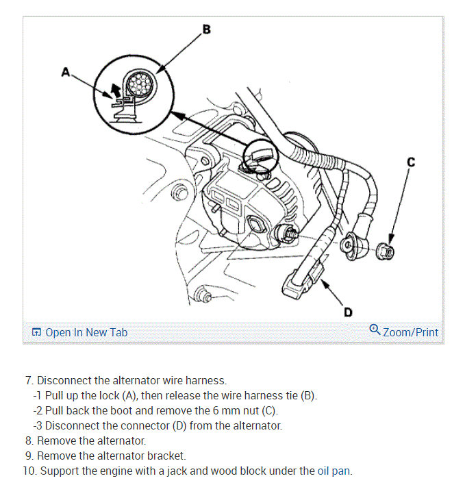

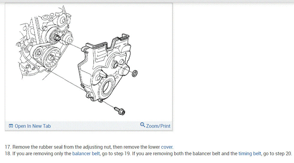

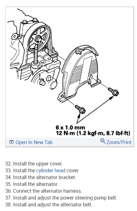

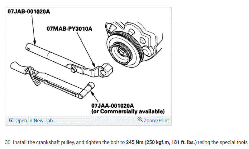

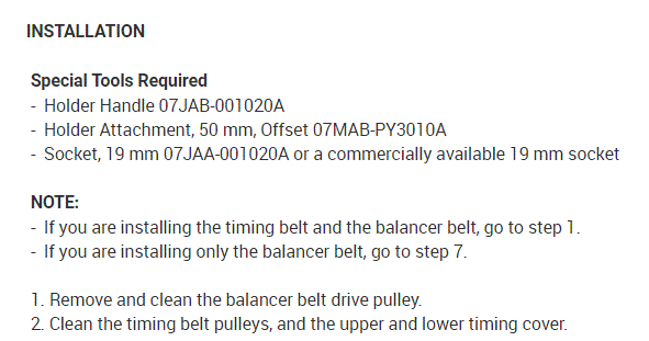

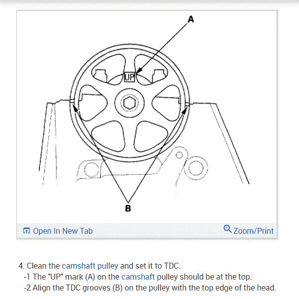

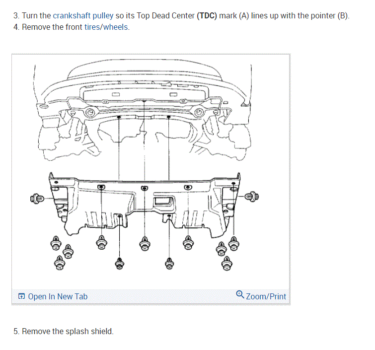

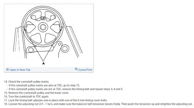

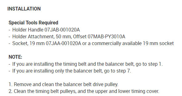

If you look at the attached pic, it shows the sensor-specific to your vehicle. This one is a little more involved because the balancer belt (timing) needs to be removed.
The first pic below is how the sensor is replaced once the belt is off. The remaining pics explain how to remove and replace the belt.
I hope this helps. Let me know if you have other questions and what you find.

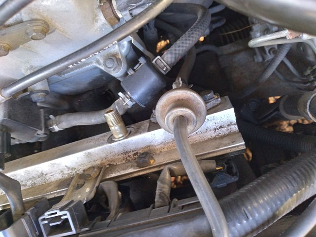

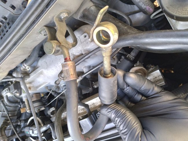

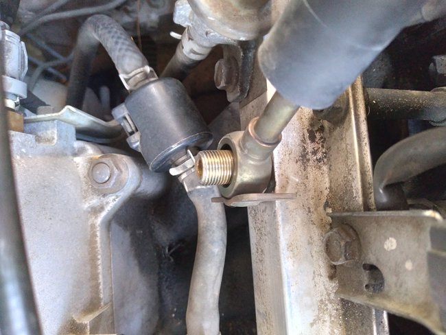

Okay, so I thought a fuel pressure test kit and the issue I'm having is that when I took the damper off the fuel rail none of my attachments for the fuel gauge out of the couplings actually fit on the threaded piece. I found one that went on a few threads but I felt like I was going to strip it because the threads feel different on the fuel rail than the ones that are on the test gauge attachments. but it fit on snug enough that I thought I could do the test. so I turn the key to the on position are fuel squirted out of the line set is underneath the damper. I sent a picture showing the line that goes on the threaded piece of the rail before the damper even if I found a coupling or attachment that goes to that part of the fuel rail I don't know how I would stop the fuel from coming out of that. mine in order to test pressure I had the fuel gauge hooked up the best I could to the threaded part of the fuel rail and when I turn the car over fuel squirted out of that line. so I don't know if there's some way of keeping it attached or if I have to undo that line from the firewall and pressure test it from that line instead? but I read online that the Accords have the same issue with finding an attachment.

When it stalls, does it start right back up? If you had the tester on a few threads and fuel shot out, pressure doesn't sound like the issue.
Let me know. Also, do you have a live data scan tool?
