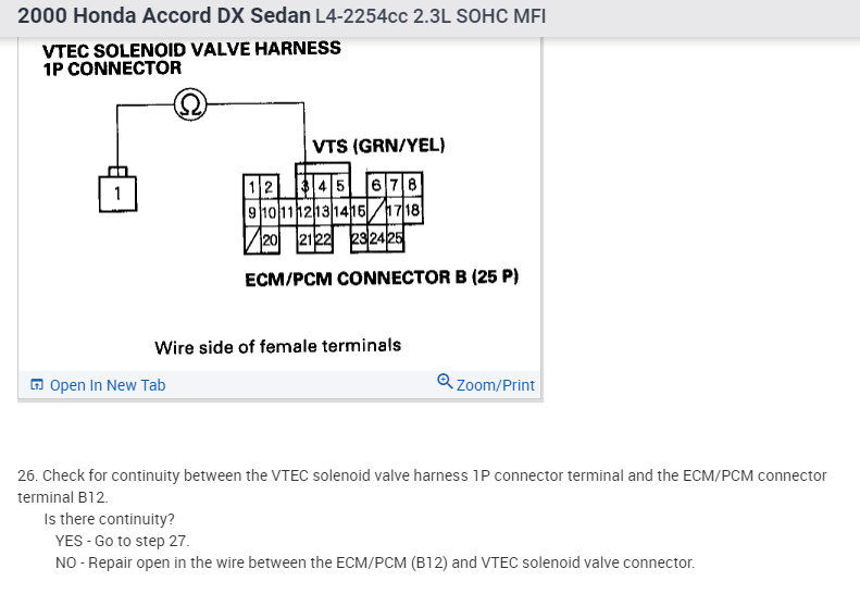

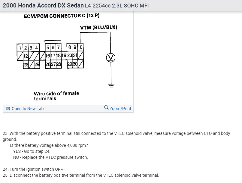

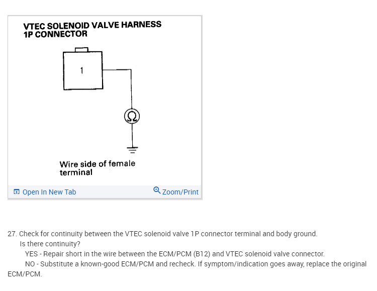

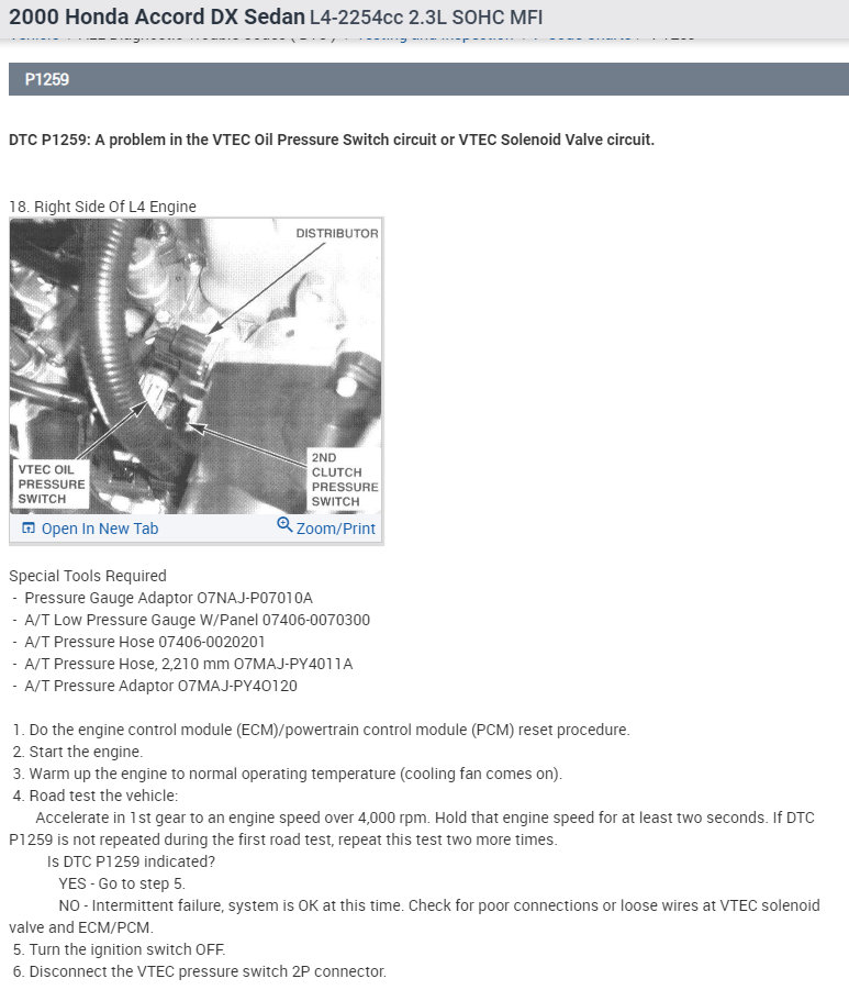

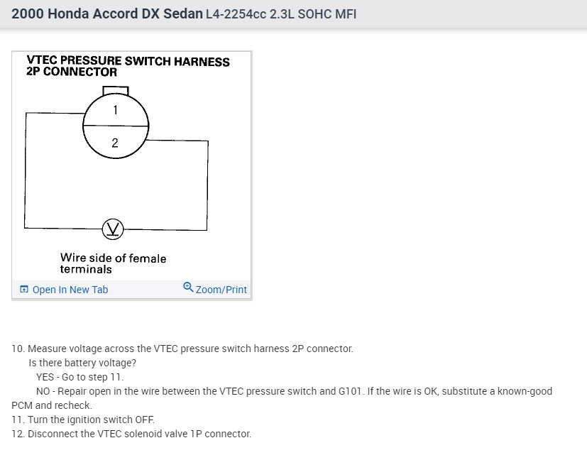

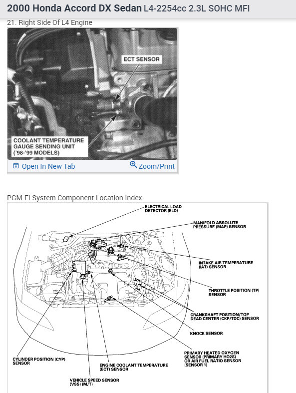

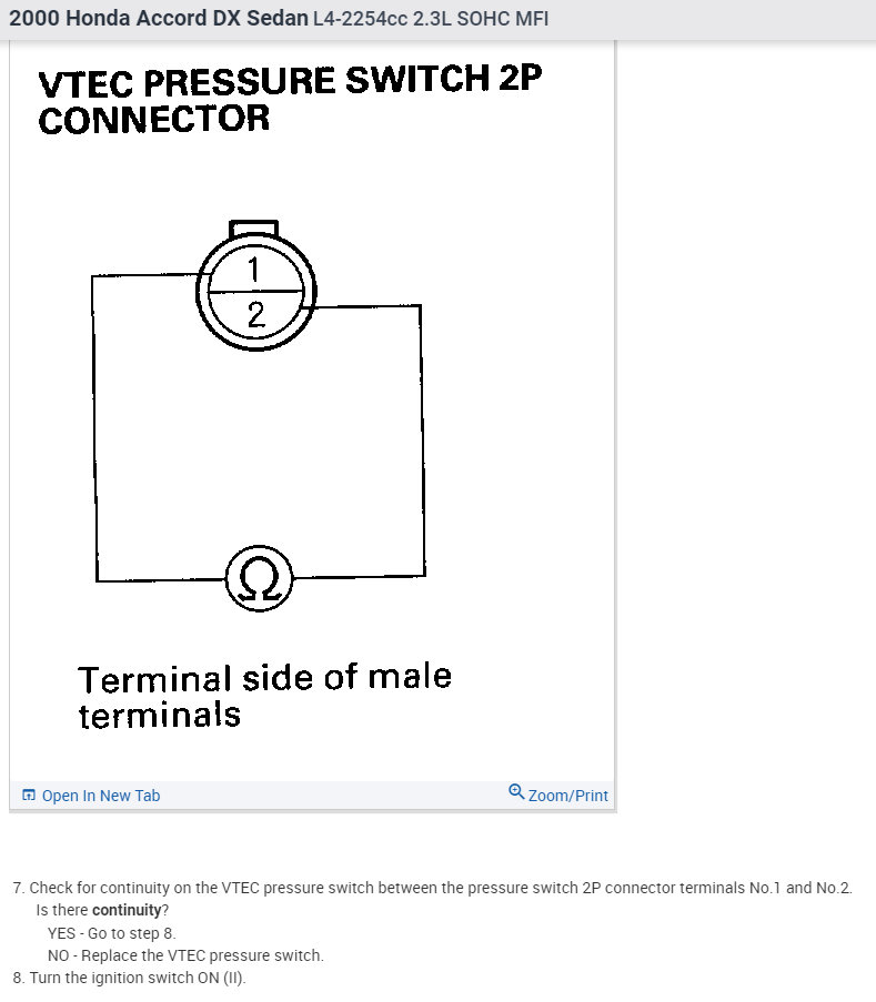

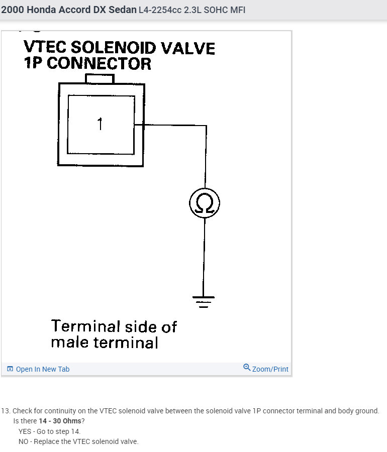

My car stalled after driving for about 10-15 minutes later than won't start back up until next day. I have put new plugs, wires, thermostat, ignition module, and fuel pump. I checked all the relays and fuses, and everything is good there. It does have two codes, one is p1259 and the other one is p1486.
Jun 5, 2022 at 6:33 AM
SQM
  • 6,383 POSTS

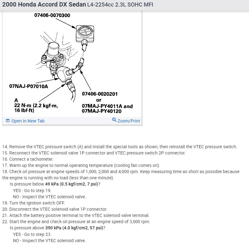

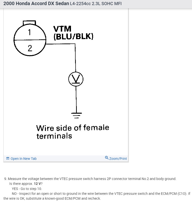

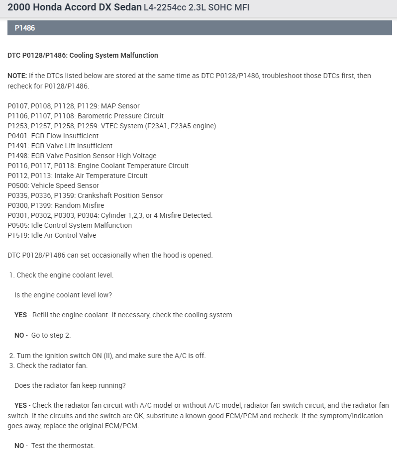

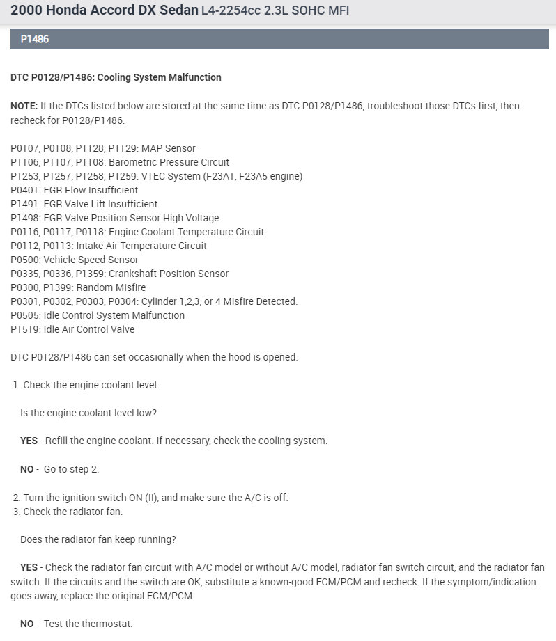

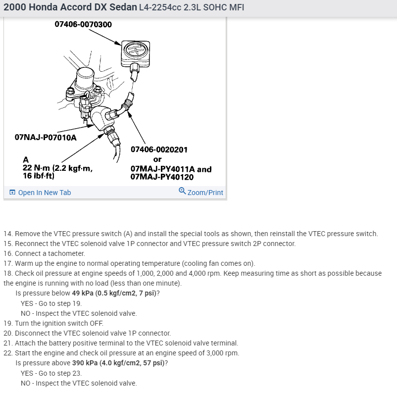

The codes
P1259 A problem in the VTEC Oil Pressure Switch circuit or VTEC Solenoid Valve circuit.
P1486 Cooling System Malfunction.

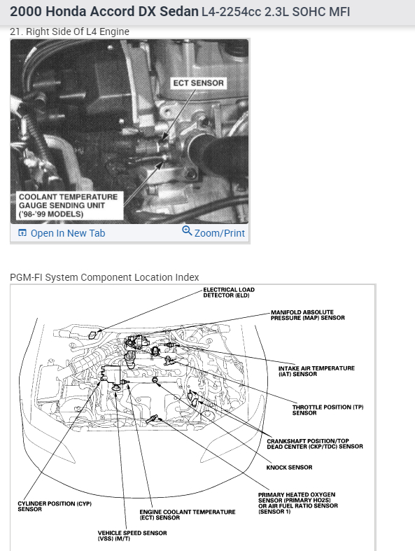

From what you are describing it could be due to a faulty coolant temperature sensor. It is possible that the sensor is defective and sending a signal to the ECM that the engine is too hot and that is triggering the engine shut off. As it cools down it allows you to start the engine.
https://www.2carpros.com/articles/symptoms-of-a-bad-coolant-temperature-sensor
I have attached the diagram as well as the diagnostics for the codes below.
Let me know of any questions.
