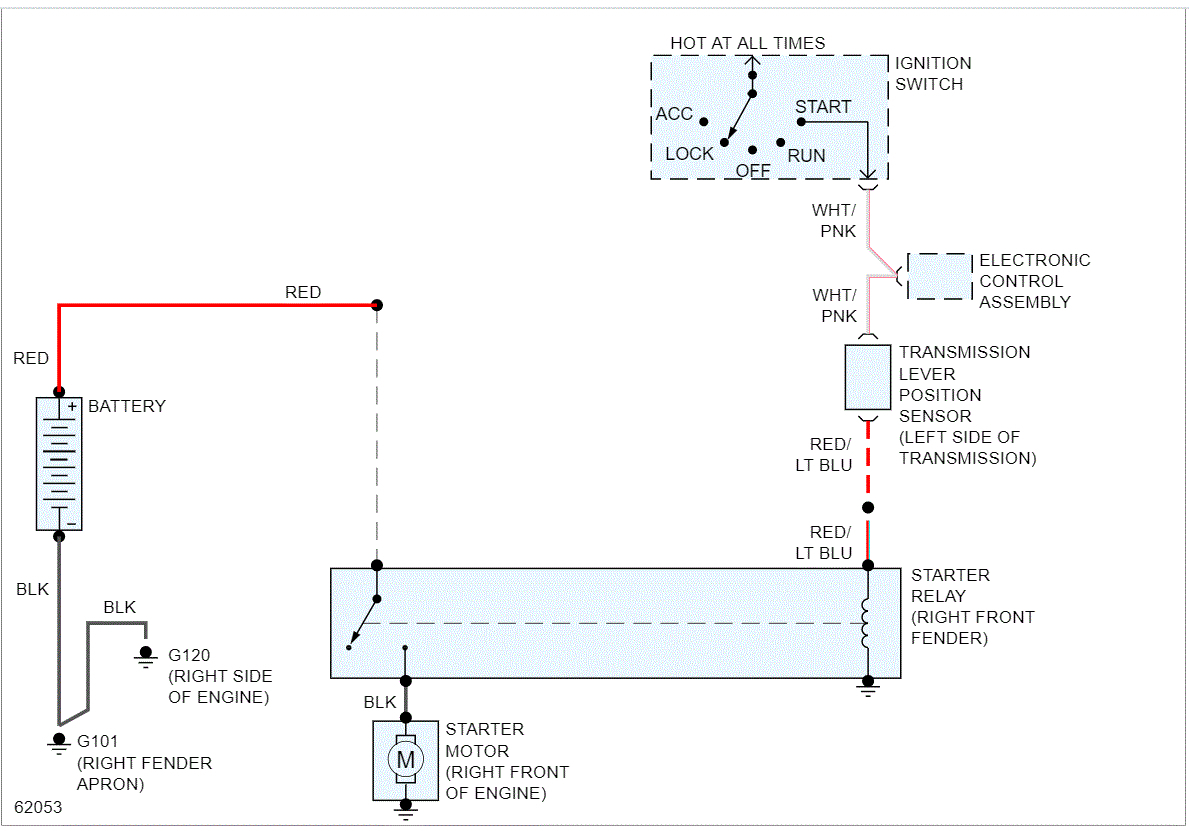

I have so many questions, I acquired a Mobile Traveler Class C Motorhome with a Ford Econoline 350, beautiful in and out. but,
it has two starter solenoids (why? and how do they work?) and there’s two transistor relays on the firewall with two terminals on each, I don’t know what they are for, I’ve seen one on cars but never two (why would there be two?).
okay, but my issues are with it starting, because it wont!
When I got it home, out of curiosity, I cranked it over and it sounded like it wanted to start but didn’t. It was full of stale gas, so I disconnected the fuel pump so no gas would get to the engine, and I poured good gas directly into the throttle body and cranked it over but this time it didn't even try to start.
Could the stale gas have put a coating on the plugs to hinder their spark?
What might be going on here?
And does anybody know where I can find a free download of a manual for this beast.

I attached the starter system wiring schematic. It shows one relay on the right front inner fender. See the attached schematic. If there are two, chances are it is for something that was added by the body company.
As far as what is on the fire wall, can you take a pic of them and upload them for me to see? It sounds like you are describing a ballast resistor. That would be part of the ignition system
What you need to keep in mind is the body company that made it has made many modifications to turn it into an RV. It started as a cab and chassis from Ford.
As far as the no start, have you checked for ignition spark? If you put gas in the throttle body and it didn't even try to start, it seems you lost spark. Check that first and let me know what you find. Here is a link you may find helpful. It explains how to check for spark.
Here is a link that explains how to check a crank no start condition:
Start with checking ignition spark and let me know what you find. Even if the fuel in the tank was old, it still should have tried to start when you put fuel to it manually.
