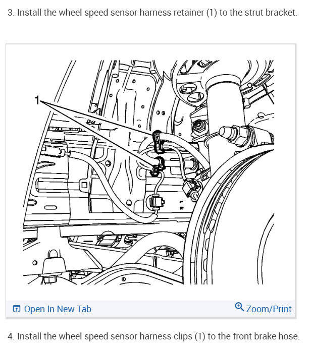

I just got my car back from an accident and within the week, this light has come on making my car shake a little. The light has never come on before. I have to take my car back to the dealership to have some details put back on my car and I am going to leave it with them to see if this was caused by my previous accident.

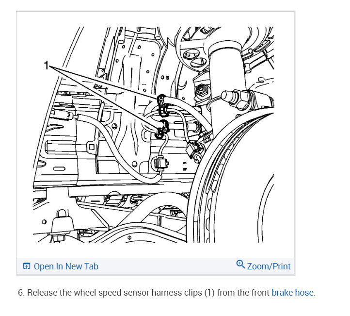

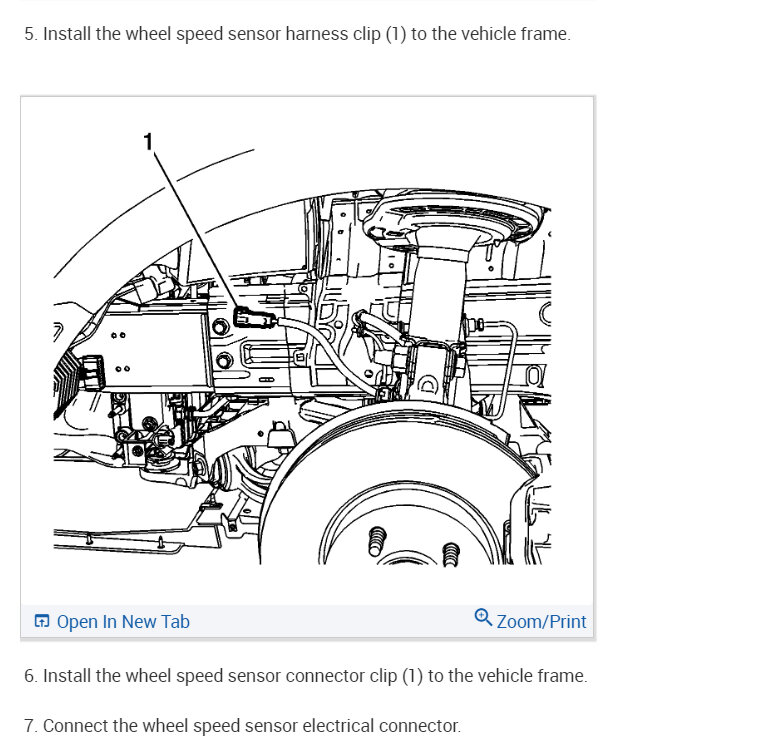

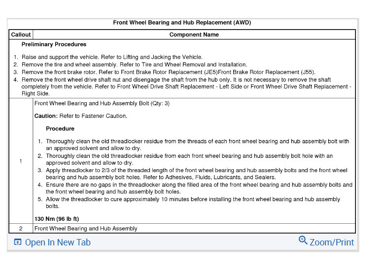

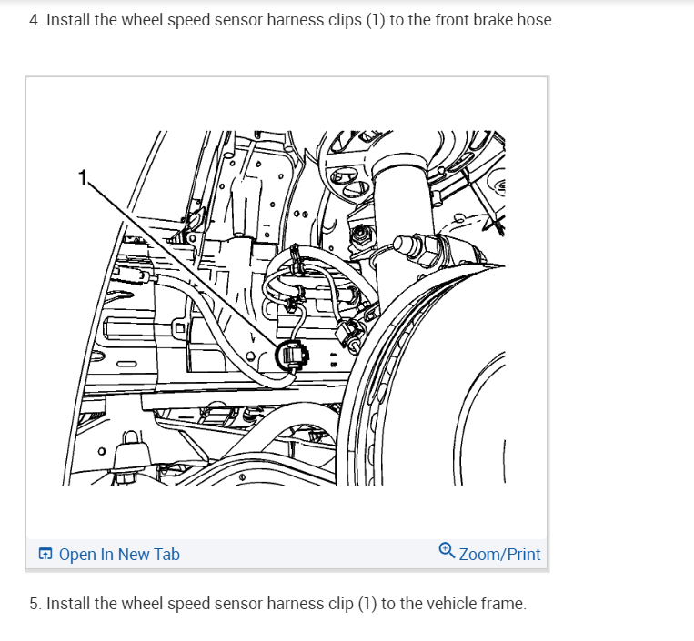

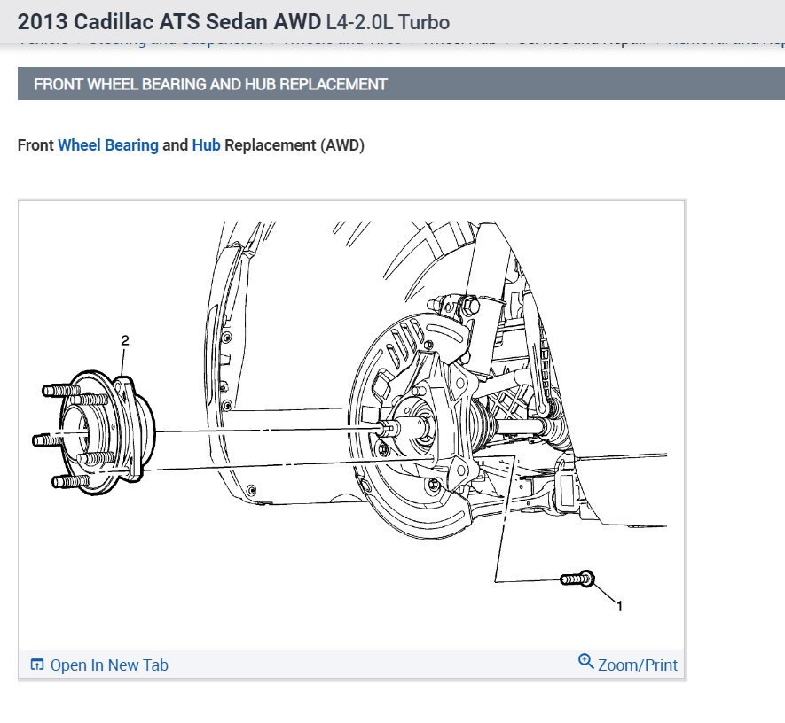

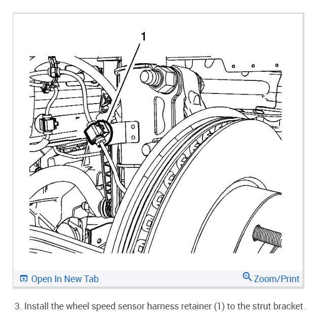

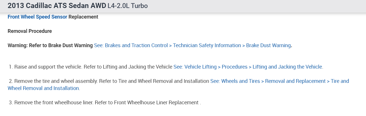

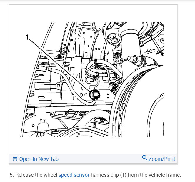

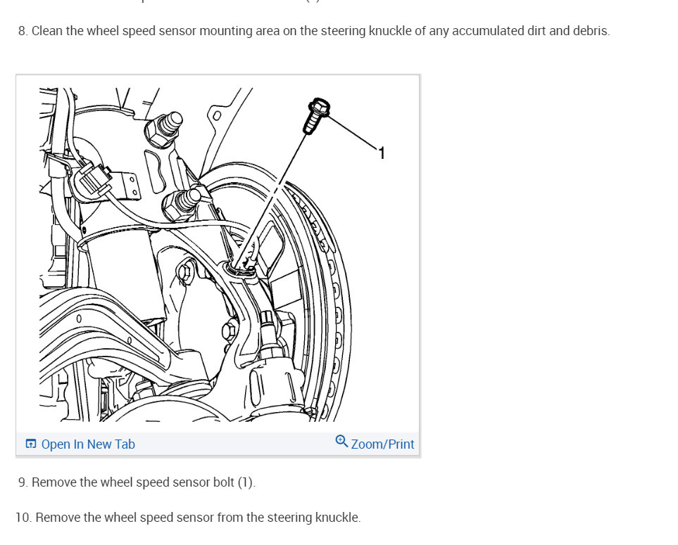

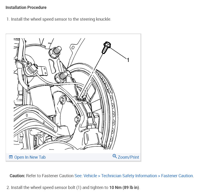

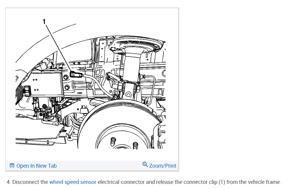

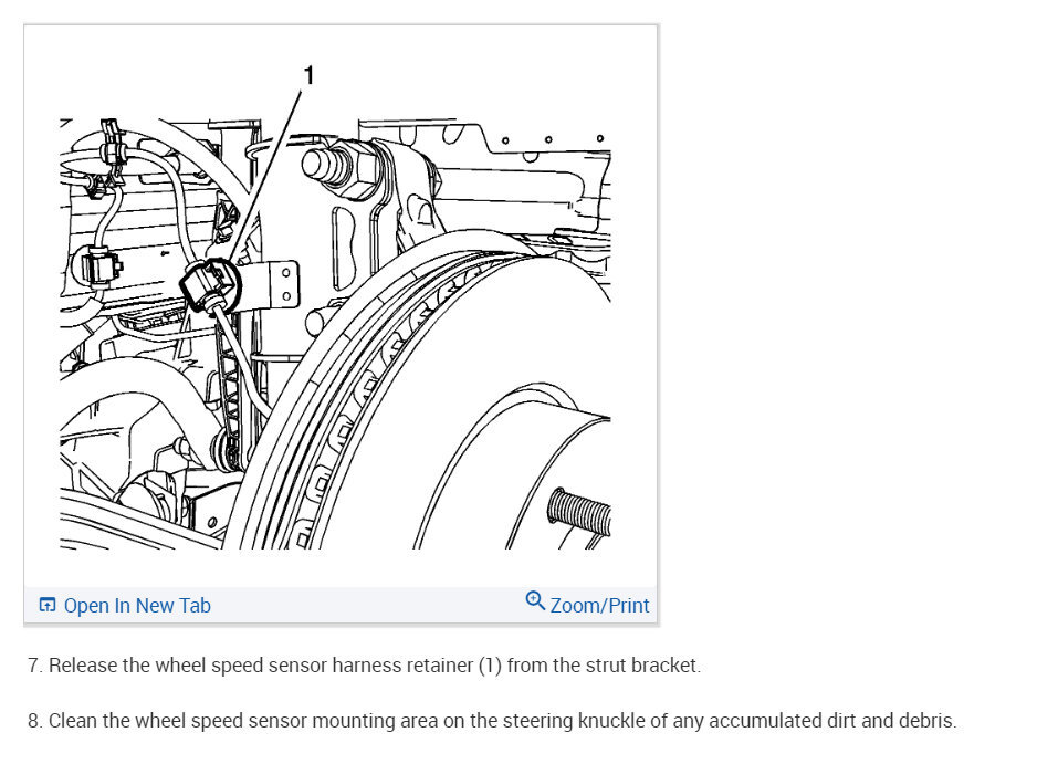

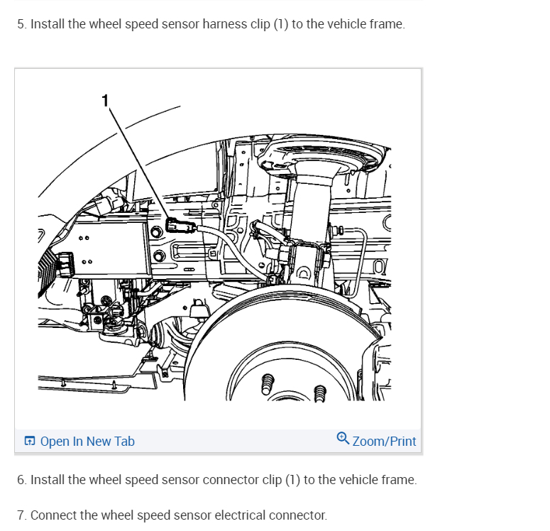

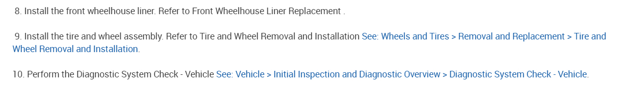

Hello Jessdevitt,
Can I ask if the airbags went off in the accident?
https://www.2carpros.com/articles/anti-lock-system-testing-and-repair-abs
Sometimes it is a front wheel bearing hub which houses the ABS sensor that causes the light to come on, the code will tell us which one it is. For this I have included the instructions on how to change the bearing hub out in the images below. Please let us know what happens and check the images below.
