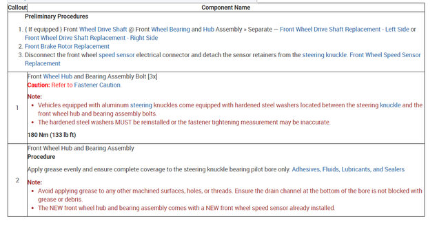

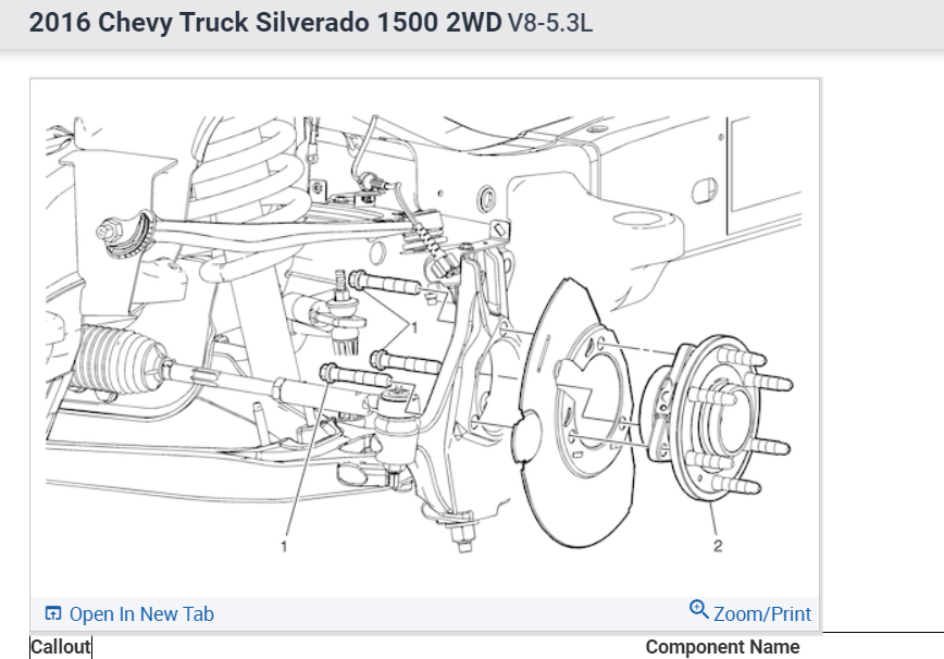

It sounds like a bearing hub is going out which is where the wheel speed sensor is. The sensor cannot read correctly when the hub is misaligned. Here is how to change the front bearing hub out in the images below in case you need it. The problem could also be the BCM which would cause both of these issues, but the scan is needed to be sure. This video shows the job being done on an older truck, but the procedure is the same:
https://youtu.be/ZgiPRG6jffc
Here is how to change out the BCM if the codes come back that it is bad as well. Check out the images (below). Please let us know what you find. We are interested to see what it is.
