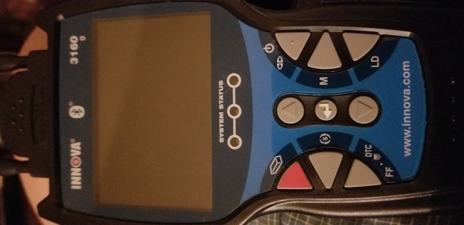

I thank you very much for your reply. A professional Innova scanner showed me in nine trouble codes. The codes indicated the vehicle was in a front-end collision.the scanner after speaking today to Innova factory engineers stated that the scanner should be able to clear all SRS solid on dash lights and codes but it did not. Running the scanner completely through the procedures stated the codes were successfully erased. in the end I'm sending information to Innova engineers to determine why the codes were not erased with their high-end professional scanner.

RLARVISO
  • 8 POSTS
Please see a photograph of the scanner I used. We are going to figure this out eventually. What are your thoughts? Innova states the scanners can successfully remove all SRS trouble codes and turn off the SRS red colored dashboard icon.

I'm not familiar with the scanner you have. What codes did you find? Also, did you try the self diagnostic procedure?
If you can't get them to erase, try this: Disconnect the battery and zip tie the two terminals together and allow them to stay that way for about twenty minutes. That should drain the power from any capacitors in the system. See if that allows you to reset the light. Also, if there is a problem, the scanner may not be able to reset the light if repairs are not made.

I performed the capacitor power drain drill with no good result. Light still glowing strong! AutoZone and Amazon sell the scanner. Check out the manufacturer web address below:
