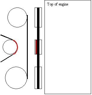

When misalignment is the cause, a pulley is tipped or turned a little. That makes the belt walk across the pulley as it goes around it, and that is what sets up the squeal. As little as 1/16" is more than enough to be heard. It is caused either by the pulley where the squeaking occurs, or the pulley right before it. The culprit will almost always be one of the smooth pulleys. They usually come painted black, then the paint wears off where the belt runs around them. Inspect them to see if the belt is running on the paint on one edge, or if the shiny area is wider than the belt. If the belt is riding on about a 1/16" area of paint, and that small strip of paint is not worn off, the culprit is likely to be the previous pulley. If the entire area the belt is riding on is shiny, and that area is wider than the belt, it is more likely that is the pulley with the problem because rather than just running off-center, it is sliding across that one, and that is what wears the paint off very quickly.
Another way to search for this is easier to do than to describe, so I drew a sad drawing that might help. When you look perfectly straight down from over the belt, you should only see it on the highest pulleys. In my drawing, the belt can be seen peeking out to the front just a little. That is the part shown in red. This could be the water pump, or more commonly, an idler pulley. It is sticking out because it is off-center on that pulley. Tension-er pulleys swivel on a mounting bracket, and that is a good place for wear to occur that lets the arm tip. Solidly-mounted idler pulleys can develop slop in the bearing that lets the pulley tip.

There is little pieces of the old belt in between the pulley grooves. They are really stuck on there. I believe it was because the pulley grooves are deeper than the grooves in the belt. As it turns the belt, it cuts them and packs it. I plan on using a wire brush on the pulleys to clean them. I already knew about the dressings in a can. An old timer told me about the baby powder. It works better than anything I have ever used. You see for yourself. The alternator has a pulley with a 1" nut holding it on. I assume I can buy a alternator pulley? Also what do you think about about the belt ribs I was telling about? I seen the diagram, the tension-er and idler pulley is brand new and it is not off center but yes, the idler pulley is painted black. Tension-er pulley is not.
