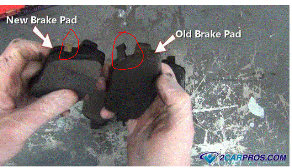

Your description sounds like a brake sensor or brakes that need to be replaced. Does the sound change when you use the brakes?
Is it possible for you to record the sound and upload it for me to hear? Also, if you take a look at the attached pic, I circled the brake sensor I'm referring to. It is designed to touch the rotor and make noise before the brakes are totally worn.

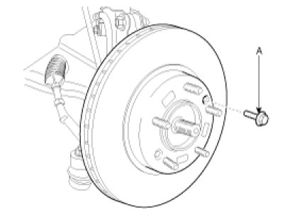

The audio didn't attach. If, however, you hear it at the front and it changes when you apply the brakes, chances are the pads are bad. If you confirm that, here is a link that shows in general how to replace front brake pads and rotors:
Here are the directions specific to your vehicle. The attached pics correlate with the directions. Note: The directions include the replacement of the rotors and caliper. You will need to inspect what is there to determine what is in need of replacement. I can help if you have questions.

Vehicle Brakes and Traction Control Disc Brake System Brake Pad Service and Repair Removal and Replacement Front Disc Brake Repair Procedures
REPAIR PROCEDURES

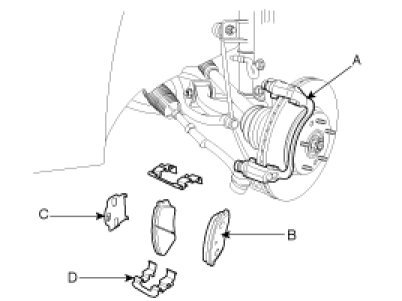

REMOVAL

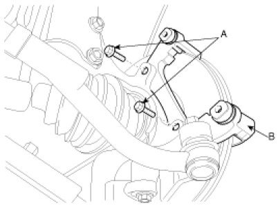

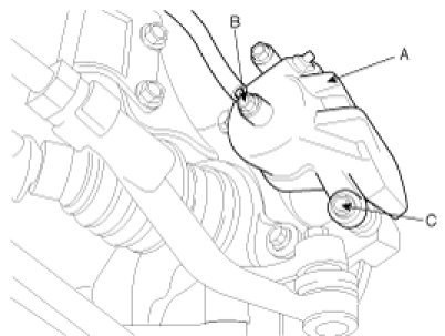

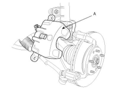

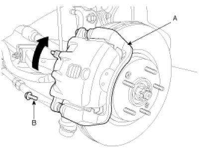

1. Remove the brake hose bolt (B) and the guide rod bolts (C) from the caliper assembly (A).
pic 1
2. Remove the caliper assembly (A).
pic 2
3. Remove the pads (B), the pad shims (C) and the pad retainers (D) from the caliper bracket (A).
pic 3

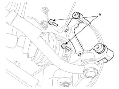

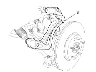

4. Remove the caliper bracket (B) and the caliper mounting bolts (A).
pic 4
pic 5

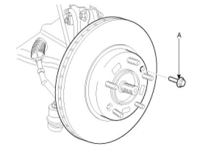

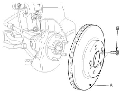

5. Remove the brake disc (A) and the screw (B).
pic 6
NOTE:
Remove the brake disc from hub using M8 bolt (A) if the brake disc has been seized with the hub due to corrosion or overheat.
Be careful not to use the hammer. The disc can be damaged if you remove the disc from the hub by hammer.
pic 7

1. Remove guide rod bolt (B) and raise the caliper assembly (A).
pic 8
2. Remove the pads (B), the pad shims (C) and the pad retainers (D) from the caliper bracket (A).
pic 9

1. Install the brake disc (A) and tighten the screw (B).
Tightening torque : N.m (kgf.m, lb-ft)
4.9 - 5.9 (0.5 - 0.6, 3.6 - 4.3)
pic 10
2. Install the caliper bracket (B) and tighten the caliper mounting bolts (A).
78.5 - 98.1 (8.0 - 10.0, 57.9 - 72.3)
pic 11
pic 12

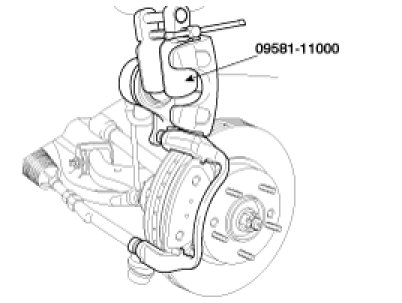

5. Push in the piston using the SST(09581-11000) so that the caliper will fit over the pads. Make sure that the piston boot is in position to prevent damaging it when installing the caliper.
pic 14
6. Install the caliper assembly(A).
NOTE:
Be careful not to damage the piston pin boot.
pic 15
7. Install the brake hose bolt (B) and the guide rod bolts (C) to the caliper assembly (A).
Bolt (B) : 24.5 - 29.4 (2.5 - 3.0, 18.1 - 21.7)
Bolt (C) : 21.6 - 31.4 (2.2 - 3.2, 15.9 - 23.1)
pic 16
