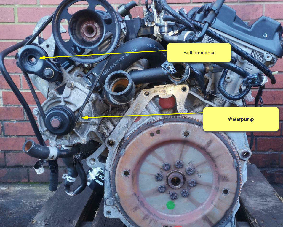

I starting getting a whining squeal under or near the back of the engine on the driver's side. It doesn't appear to be belts. What could be possible causes for a squealing noise in that location?

It sounds like you might have an issue with the water pump or drive belt tensioner These are the only engine peripherals which are located on the drivers side. Please see picture below.
Easiest way to check if the water pump or belt tensioner a noisy is to use a stethoscope or long screwdriver. With the engine running carefully touch the mounting bracket of the belt tensioner or the water pump housing and listen as to which part makes the noise. Mind the drive belt, do not touch any rotating parts!
A good guide on how to diagnose noises is below.
https://www.2carpros.com/articles/chirping-noise
Please let us know how you get along.
Cheers, Boris
