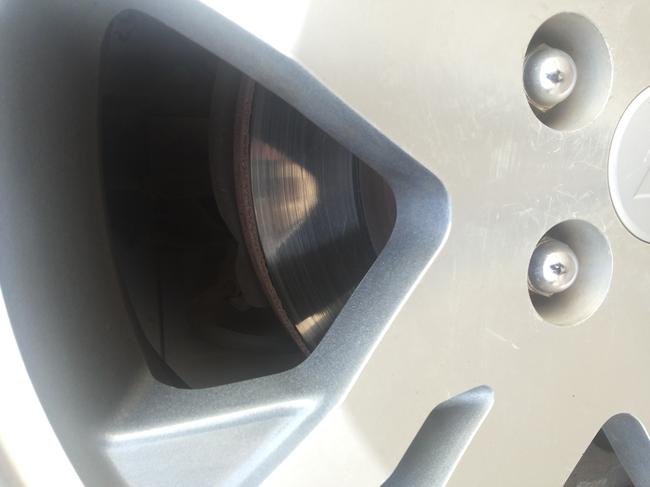

i really don't know what to do, now i 'm opting for getting new rotors and brake pads from Wagner to confirm if the issue is from both the rotor and brake pads. I 'm also suspecting the caliper but not sure, the rotors currently have a shining reflection when i look at it, the ones in front wheel, see attached an image
Dec 2, 2013 at 5:09 AM
  • 110,251 POSTS
It's hard to tell from the pic, but they could be glazed. However, if the pads are good, you shouldn't hear a grinding noise. Does the noise change with speed? Does it change when turning?
