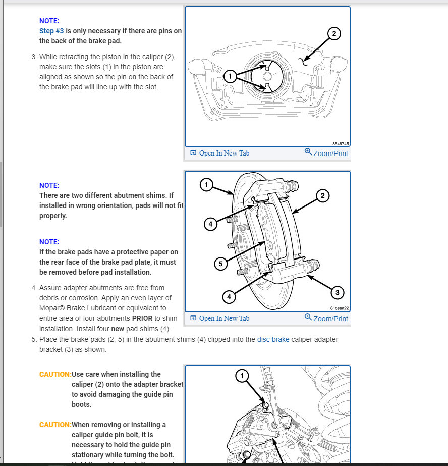

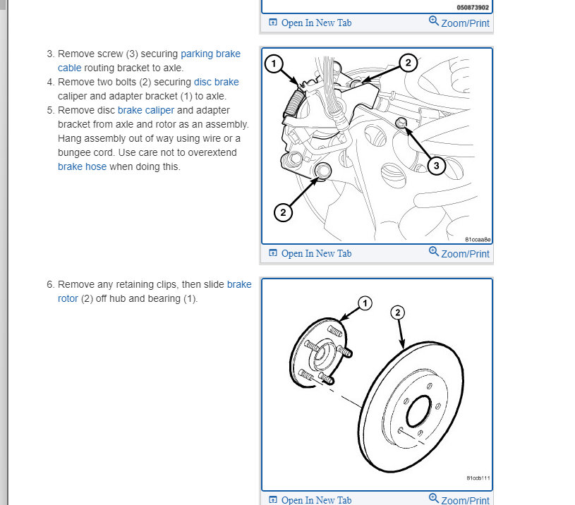

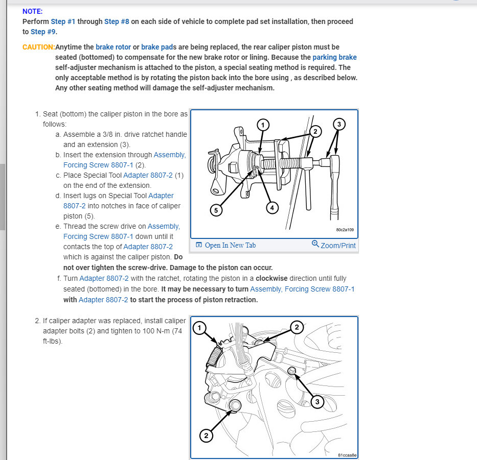

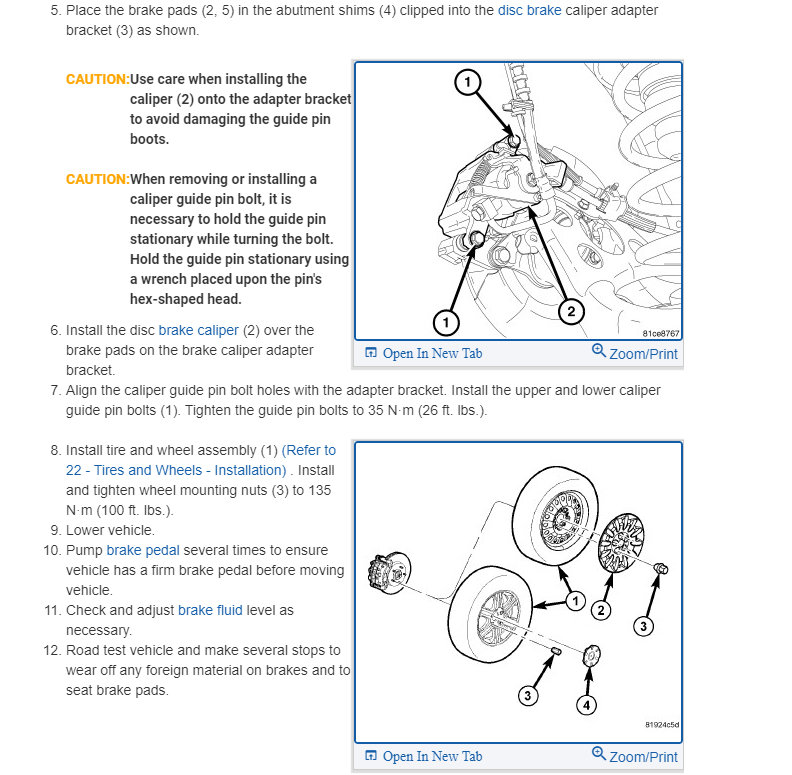

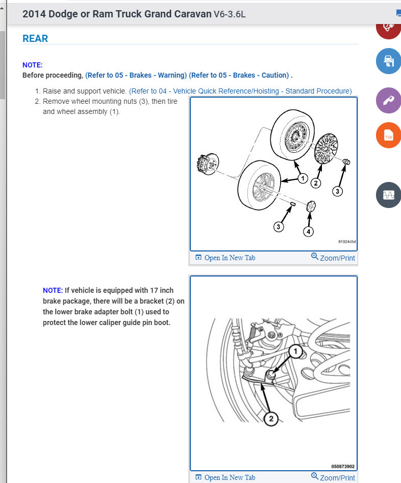

This noise is most likely an issue with the rear brakes however you don't have parking brake shoes in the rear. This is a caliper that has an integral parking brake mechanism.
So, we need to replace the pads and rotors and while the calipers are off, we need to inspect them and make sure they retract properly.
Here is a video that will help with this:
https://www.youtube.com/watch?v=j8YwfSKEzZo&t=29s
I also attached the info below from the manual that will help with doing the same thing.
Please run through this material and let us know what you find with this.
