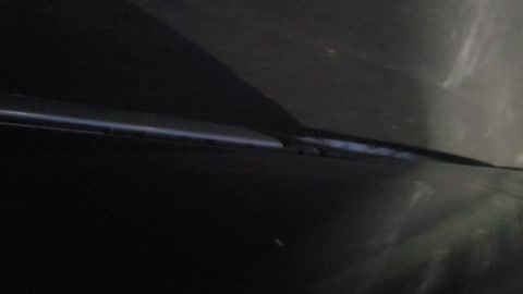

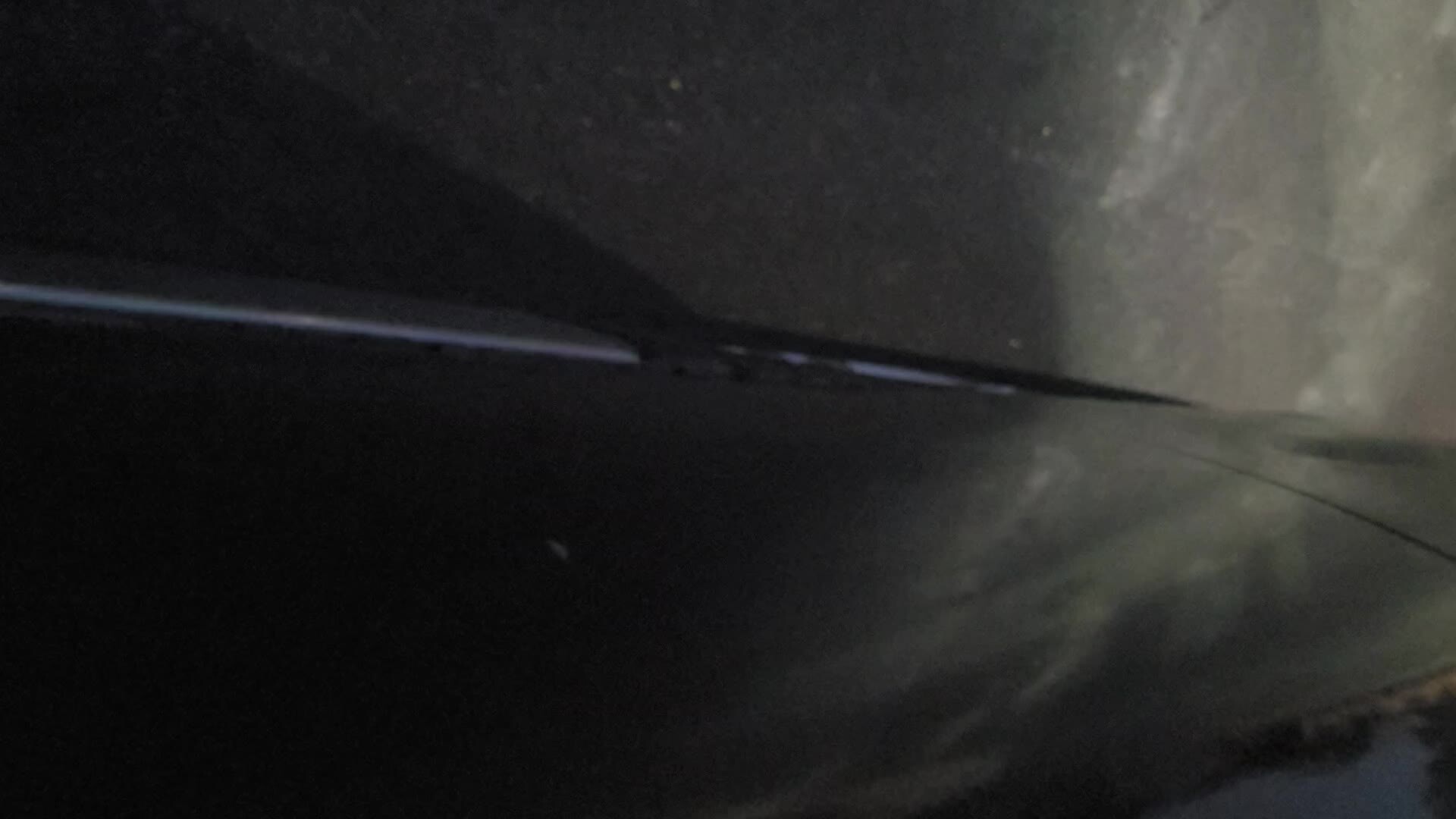

I get a squeaking noise coming from under the vehicle whenever it starts to move. The more speed being gained the faster the squeaking gets. At driving speeds, it sounds like the cars from the Jetsons. I thought it might be a bearing but when I lift the vehicle up and spin the wheels, I Don't get any sound. I attached a video for the sound. Thanks

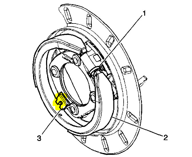

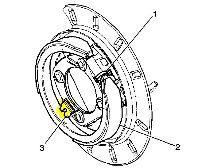

  • 110,194 POSTS
If you don't hear it in reverse, suspect it has something to do with the parking brake shoes. Have you checked them? You may have a retainer off or a broken retainer spring which is allowing the shoes to turn and rub when going forward. See pic below
See pic below.

CAPTKCP
  • 47 POSTS
I was finally able to reproduce the noise. I had it in neutral and spun the drive shaft and after several turns the sound started. I sprayed the u joints with some motorcycle chain lube to see if the sound would go away and it did for about a day. Cars is at the shop to get new u joints installed. If that doesn't stop it, I'll update.
Thanks for your help.
Sep 17, 2023 at 8:05 AM
  • 110,194 POSTS
That can do it. LOL I'm glad to know you found the issue and are having it taken care of. If anything changes, let me know.
