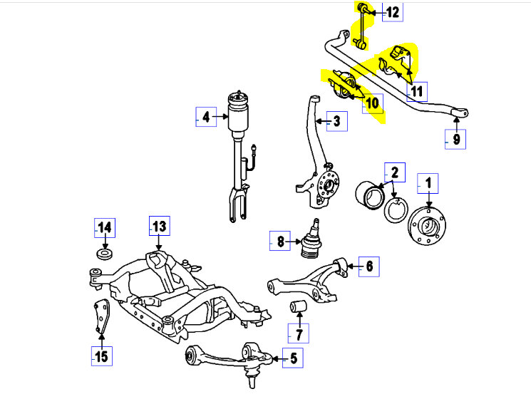

Since it has gotten cold and with age and miles some of the bushings are making noise and I am trying to find out which. I sprayed the upper control arms bushings but that was not it. If you drive forward and hit the brakes you hear it the most, but there is no clunking that indicates a worn our lower control arm bushing. Suspension is tight. Also does it while I am turning. Noise is similar to creaking on wooden floor.
Jan 5, 2024 at 12:25 AM
  • 110,240 POSTS
Based on your description, my first suspect would be the stabilizer bar bushings or the stabilizer links.
If you look below, I attached an exploded view of the front suspension. I highlighted the parts I'm referring to. Check these and let me know what you find.,
See pic below.

I confirmed it's just front right but still cant tell. Driving on road and freeway you won't hear a thing only on speed bumps. Could the air strut be the cause?
Jan 21, 2024 at 2:10 AM
  • 110,240 POSTS
A faulty air shock can cause it, but in most cases, when they fail, you can see a height difference.
Were you able to check the things I mentioned above?

Yes, everything else is tight. Moved wheel around in all directions, sprayed all bushings with lithium grease. I replaced air shocks on Benz before so you i know they fail usually and sink. The only thing is this right one does one hess while still leveled. It does it after instarting the car and get it warmed few minutes. Just does hesss i guess adjusting but only from that one. Does it few times a day. No sinking. No lights on dash.

This is just weird. Temperature went from 0 to 64 in less than a week and just rain. So, i went to move the car around and the noise was gone. It must have been the temperature effect on suspension bushings.
Jan 26, 2024 at 4:41 AM
  • 110,240 POSTS
It sounds like you live near me. LOL The weather is the same here. Also, you are exactly right. When it gets cold, that is when you will hear a dry bushing the most. I have an Audi that does the same thing, and it drives me crazy. I just never have the time to identify which bushing and to fix it. My first suspect is either a sway bar bushing or even a ball joint.
If possible, spray the sway bar bushings really well with a lubricant to see if that keeps it from coming back for a while.

I sprayed everything before and sprayed again once i jacked it up. But nothing went away. Maybe it needed this soaking and it set first plus the weather change. Ya i have an Audi same way, asked son to move it he said you know there is a noise, I am like what noise, it was dry bushings that also isn't there anymore.
Jan 26, 2024 at 8:55 PM
  • 110,240 POSTS
You may want to consider removing the bushings for the stabilizer bar and inspecting them. They aren't expensive.
