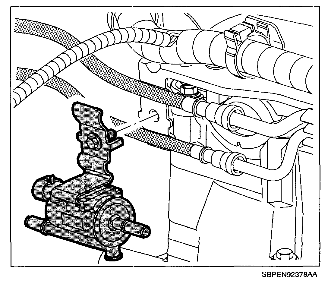

My car runs sputters when Idling, when driving I accelerate and it sound like it is backfiring somewhere in the engine compartment. Had somebody follow me and they said when I really got on it the exam is really stunk took it to O’Reillys to have it scanned and not come back as canister purge valve needs to be replaced. Not sure if this would cause all these problems. Any information would help.
Nov 11, 2018 at 10:05 AM
  • 110,240 POSTS
The purge valve allows metered amounts of fumes to enter the engine for burning. If it is stuck open, it could cause an engine vacuum issue. I am going to provide the directions for replacing it if you plan to do so. Pictures 1 and 2 correlate with these directions.
_________________
EVAP PURGE SOLENOID
REMOVAL
Caution: do not allow smoking or the use of open flames in the area where work on the fuel or evap system is taking place. Anytime work is being done on the fuel system, disconnect the negative battery cable, except for those tests where battery voltage is required.
1. Ignition Off.
2. Disconnect purge link quick connect from EVAP purge solenoid.
3. Disconnect EVAP purge solenoid harness connector.
4. Remove purge solenoid and bracket. Remove its ported vacuum line.
INSTALLATION
1. Connect EVAP purge solenoid ported vacuum line.
2. Install EVAP purge solenoid and bracket to cylinder head.
Torque:
EVAP Purge Solenoid Bracket Bolt: 10 N.m (89 in-lbs)
3. Connect purge line quick connect to EVAP purge solenoid. Push in connector until a click is heard, then pull back to confirm positive engagement.
4. Connect EVAP purge solenoid harness connector.

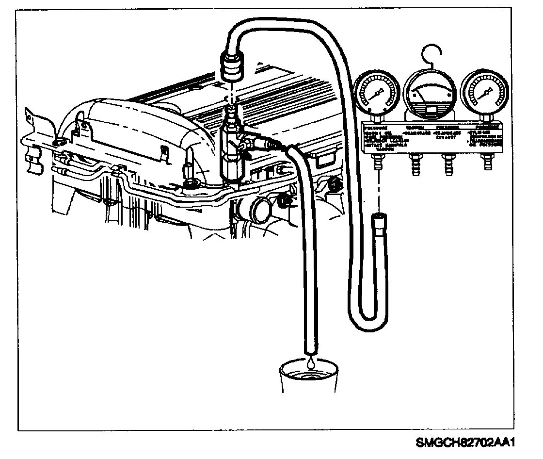

One last thing. Too much or little fuel pressure can also cause the issue. Here are directions for testing pressure. Make sure the regulator is working properly.

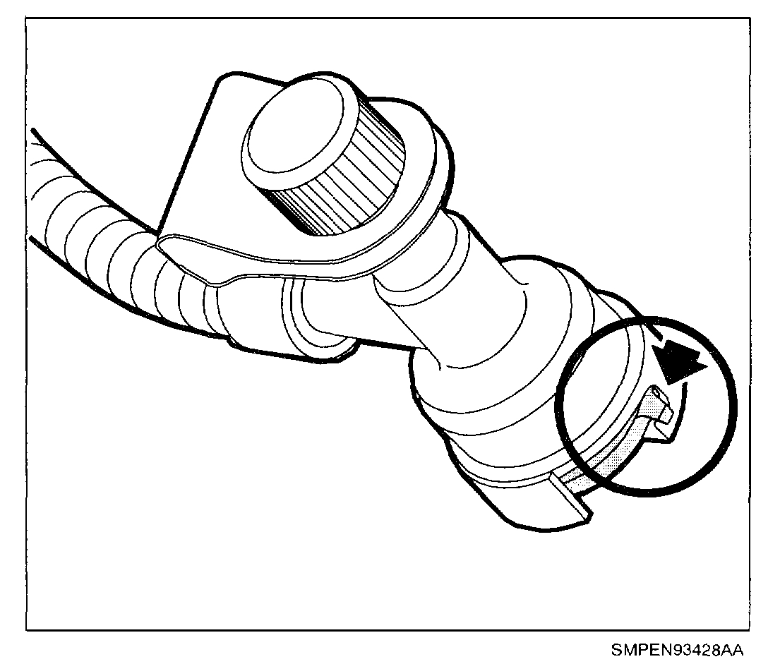

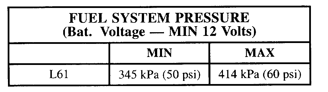

Here are the directions specific to your vehicle. Pics 3 and 4 correlate with these.
FUEL SYSTEM PRESSURE TEST
This test will determine whether there is adequate fuel pressure delivered to the fuel injectors to start and run the engine under low load conditions.
Caution:
^ do not allow smoking or the use of open flames in the area where work on the fuel or evap system is taking place. Anytime work is being done on the fuel system, disconnect the negative battery cable, except for those tests where battery voltage is required.
^ Whenever fuel line fittings are loosened or removed, wrap a shop cloth around the fitting and have an approved container available to collect any fuel.
1. Relieve fuel system pressure. (Refer to "Fuel System Pressure Relief".) See: Fuel Pressure Release > Procedures
2. Connect fuel gauge pressure adapter (309725) and pressure gauge to fuel pressure test port.
IMPORTANT: Battery must be at a minimum of 12 volts when performing any fuel system test. Charge battery before proceeding if below 12 volts.
3. Using Scan Tool, energize the fuel pump for a minimum of 10 seconds.
3.1 Record the fuel pressure.
3.2 Repeat this procedure a minimum of two times.
4. While fuel pump is energized remove fuel pressure regulator vacuum line and inspect both ends for liquid fuel.
^ If liquid fuel is present replace fuel pressure regulator before proceeding. (Refer to "Fuel Pressure Regulator Removal" procedure.)
^ If no liquid is present proceed to step 5.
5. Compare the pressure recorded to the published specification.
6. Return to "Fuel System Diagnostic Chart" and use test result to make appropriate decision.
